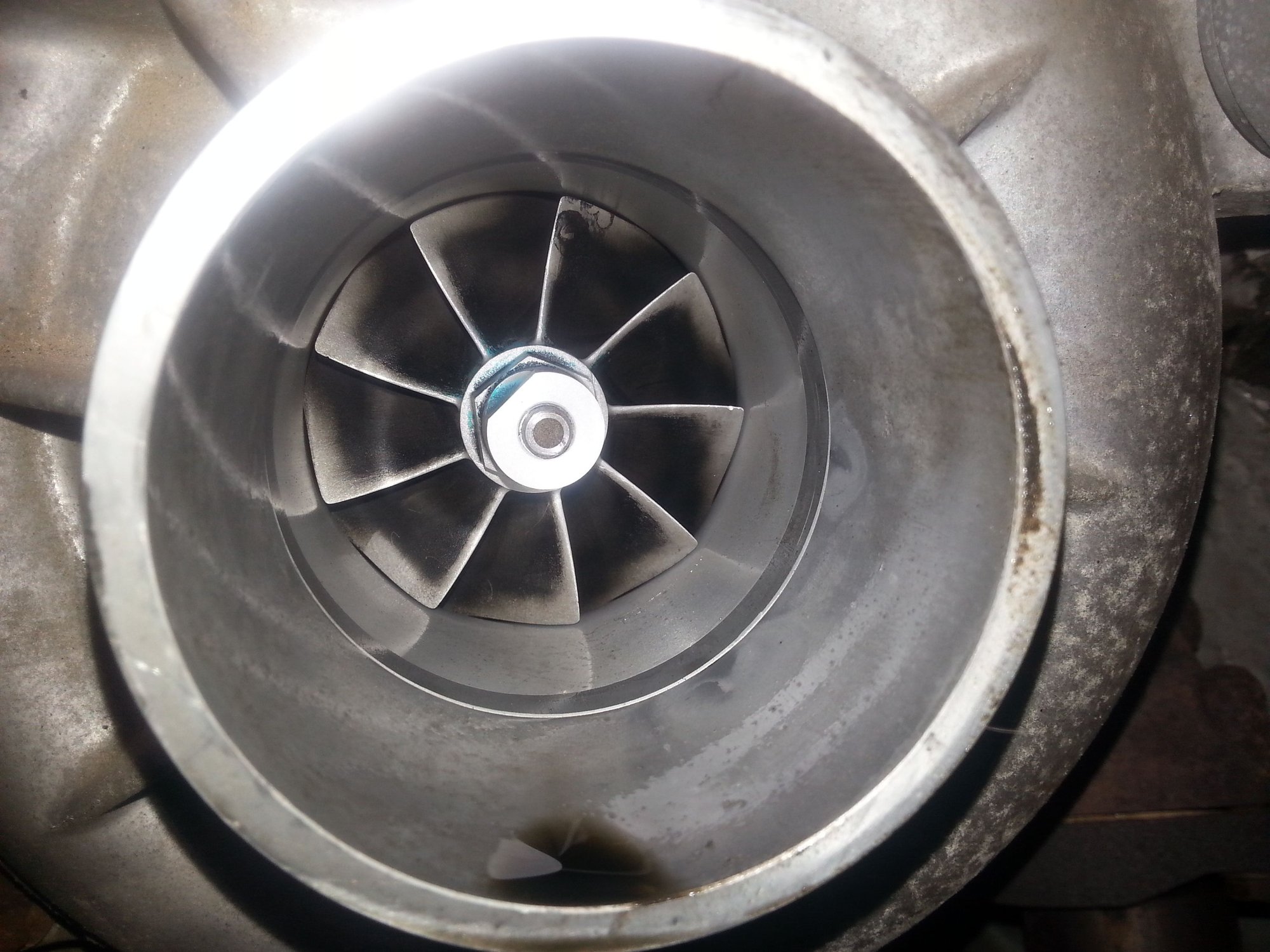

I would like opinions on whether this should be replaced or not. If so, any suggestions on where to get a new wheel and what brand would be the best would be appreciated.

It looks like there is some erosion on the blades. I have seen a whole lot worse and some of the owners of those trucks refused to replace them and just continued driving them.
What kind of air filtration system is on your truck. You need to solve that problem before you replace the wheel.
Riffraff has a decent selection of replacements at reasonable prices, especially if you are going to replace the stock wheel with the same.

Filter is a little beat up, but it is pretty clean. It's a K&N filter. Probably should go ahead and replace it.

Then look at all of the fittings, make sure there are no holes in the plumbing, and check the tightness of the clamps all the way to the turbo.

OP- your wheel looks fine. Unless you just want to upgrade to a newer wheel that one will do fine. When I got my truck with 280K on it the wheel was eroded a good bit more than yours and had quite a few nicks. I replaced the stock air box right away but ran that wheel for 3 years as I worked on other parts of the truck.

I just had my intake off (finally installed a new steering gearbox) and took a peek at the wheel. Mine looks almost exactly like yours and seems to be doing fine. I just got this baby in the mail:
Riffraff Diesel Billet Compressor Wheel 94-03 - Riffraff Diesel Performance
I also got the GTP38 rebuild kit. At 270K I figured a little preventive maintenance was in order. An ounce of prevention is worth a pound of cure. I haven't noticed any issues with the turbo though, just finally had the $$$ to get around to it.

What's wrong with that wheel? (I'm being sincere.) Mine looks similar to that one, but I thought it looked normal for a 15-16 year old compressor wheel. I understand the whole CCV oil pulling into it, so there will be black/brown stains on the wheel. But if that one causes concern for replacement, I've overlooked mine erroneously. Is there a better QUIET wheel out now? Key word, QUIET. I do not want to hear the wheel or whine more than current.

My wheel looks the same and is doing fine. The Garrett has no problem building 16psi (stock) getting on the freeway. I have to pull the turbo to fix an oil leak and decided to make a pre-emptive strike while it's off since it's got 270K on it with all original internals. With a little luck it will solve my turbo surge also.

Thanks for all the info guys. I think I will just leave the wheel for now because it seems to be working fine with no boost issues. I will be upgrading my air filter system. Probably go with the 6637 and see how it goes. All the clamps and seals seem to fit nice and tight so I think just a filter change will do.
