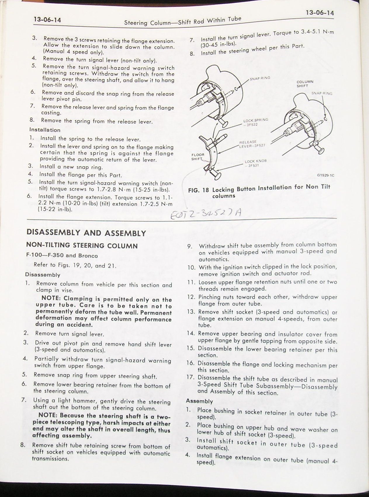

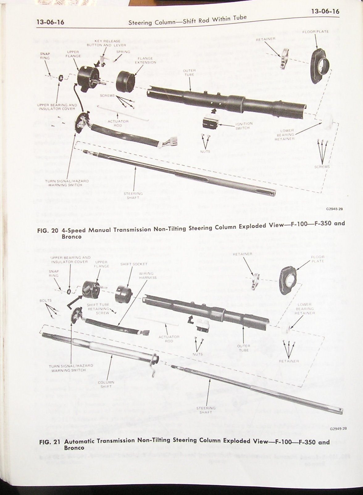

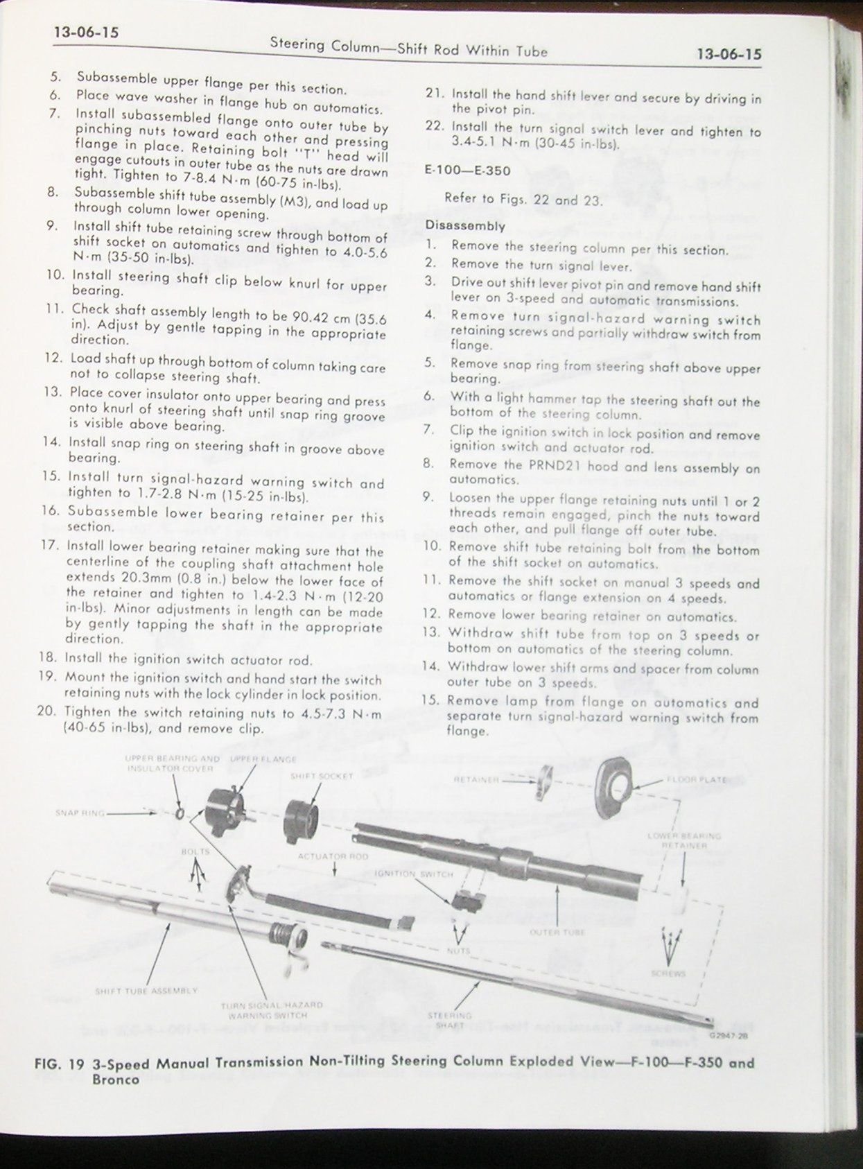

Here ya go - straight from the factory shop manual... hope you can read it....
Non-tilt steering column (dis)assembly 1 of 3
Non-tilt steering column (dis)assembly 2 of 3
Non-tilt steering column (dis)assembly 3 of 3

Awesome! Thank ya sir! I really need to get an FSM, I have one for my CJ7, well worth the money.
