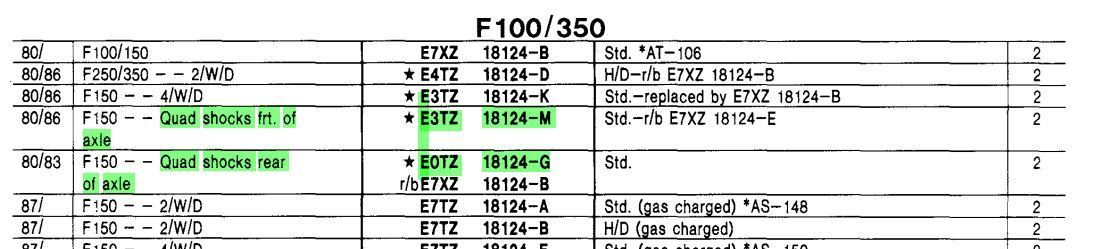

I'm sure he does. And I'll bet it is the shock towers as he scored a pair of them for his truck. But, the shocks don't vary from side to side, just front/rear.
Did you notice that the catalog lists the shocks ahead of the axle from 80 - 86, but behind the axle on 80 - 83? There's no reference anywhere of those aft of the axle from 84 - 86. I'm betting its another catalog glitch.
