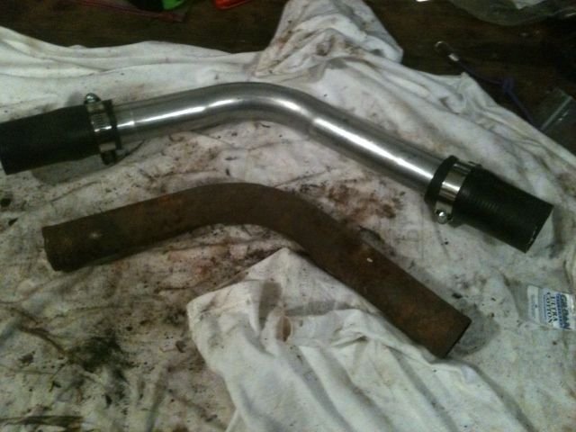

I should not be one to tell others what a Y-block should look like as mine is a mess. You need to by a dealer catalog or other original Ford truck literature. Or buy the "Ford Y-Block: How to Repair and Rebuild the 54-6? OHV" by James Eickman. It is out of print but look on Amazon or ebay. Search the net for examples of original engines.
They do reproduce the spark plug wire looms. I do see vintage radiator clamps for sale. I am not sure which ones Ford used. You do need the radiator pipe elbow. If you have an old one as a model a muffler shop could bend one for you.

I have a mandrel tube bender in my shop. But the hose that is now on the truck is the way I bought it. I know the ripple hose isn't correct. But I didn't know the upper hose had a steel section like the flat heads.

Here is Joe Harrier's engine, a 55. He had an elbow made for his engine.

Here is a pic of my dirty engine compartment... I don't know if it helps you any but my radiator elbow is original and of course the color is not correct.

That helps. I can make one of those and also bead the ends to keep the hose from slipping off. Thank you.

Yeah, I just took my original to a muffler shop and they bent one for me. Quick and easy.
I think it looks so much nicer than that flex hose.
