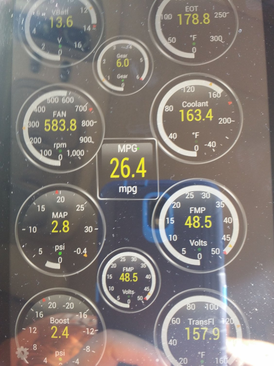

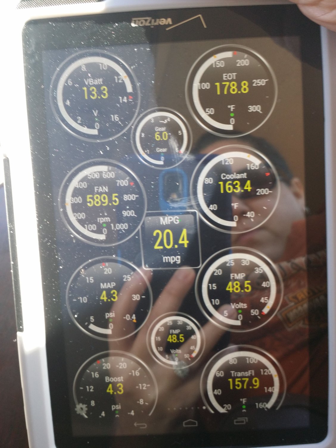

Some pics of my Torque Pro readings

If those shots were at operating temp, your coolant temp is low, and your EOT/ECT delta is a little high, indicating inefficient heat transfer across the oil cooler. You'd want to get the coolant temp issue resolved first, and then check the numbers again. Charging system voltage is a little low, but not atypical of factory alternator performance. In general, from what's shown, nothing looks too bad.

Add IPR%, ICP psi/HPOP, VGT%, and EGR% to that screen.
