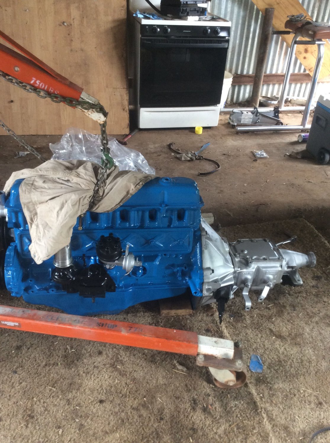

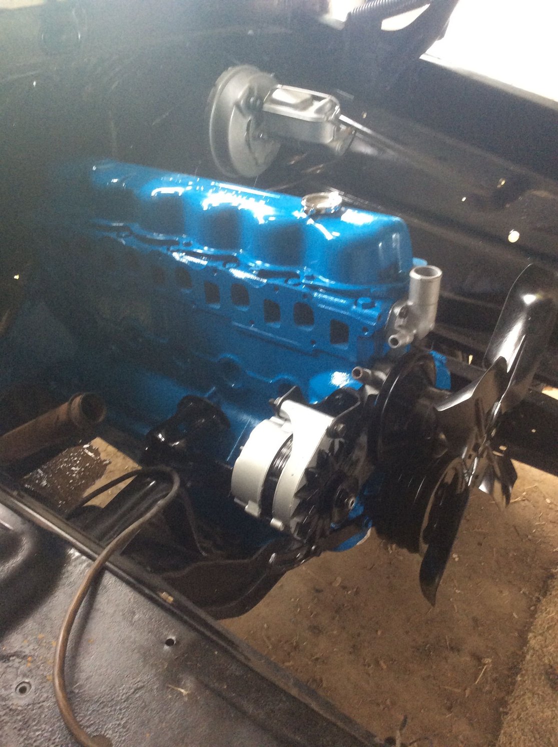

Ok I just overhauled my 1971 with a 300 6cyl. It cranks up cold really well and runs and idles great but once everything gets up to temperature it won't restart. It does turn over but with a lot of hesitation maybe a half a revolution then it stops. It just drags the whole time till it cools completely down. (By the way I did put a new starter on it although I haven't ruled it out yet.) Any thoughts would be appreciated.

Ditto, verify timing. Too advanced and engine will "kick back" on starter.
If timing is OK, grind and clean ground connections at block and solenoid down to bare bright shiny metal. Check the voltage drop during crank w/ ignition disabled, should not exceed a tenth of a volt or so across any one cable or connection and starter case, positive cable starter post to battery post positive, etc.
Did you paint your motor? The starter grounds through block and may interfere, along with cable at block pad or bolt. Replace cables if they are old/original. The voltage drop test will show if it's a grounding issue or, current being soaked by a dragging armature, etc.
Hot weather or high underhood temps really brings out weakness in the starting cables and circuit. Headers can contribute to this symptom at the starter as well. Let us know what you find.

Thanks guys. I have tried the timing all over the place but I will take your advice and scrape some paint off as soon as work allows me to get back in the shop. Thanks again!!!

Finally got back to work on the truck. It turned out it was a ground issue too long and too small with poor connections.
