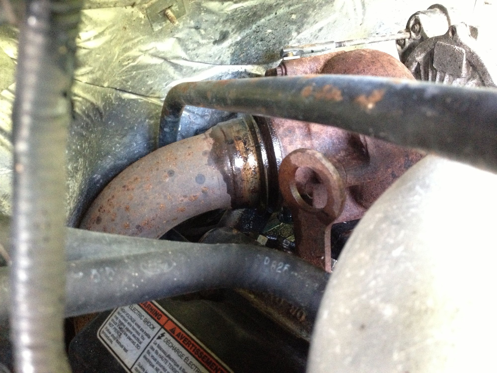

Also that exhaust leak I mentioned before....the exhaust line coming off the turbo is just loose. No clamp on it. Is there a special clamp I need to reconnect it?

Well Ford has their special springy clamps, but to just get it running... if you're talking about the rubber hose... a regular clamp should get you by.

Talking about this-the part that's wet seperates from the turbo.

Yes. Special clamp.

Yes. Special clamp.
Any idea where to get one?
