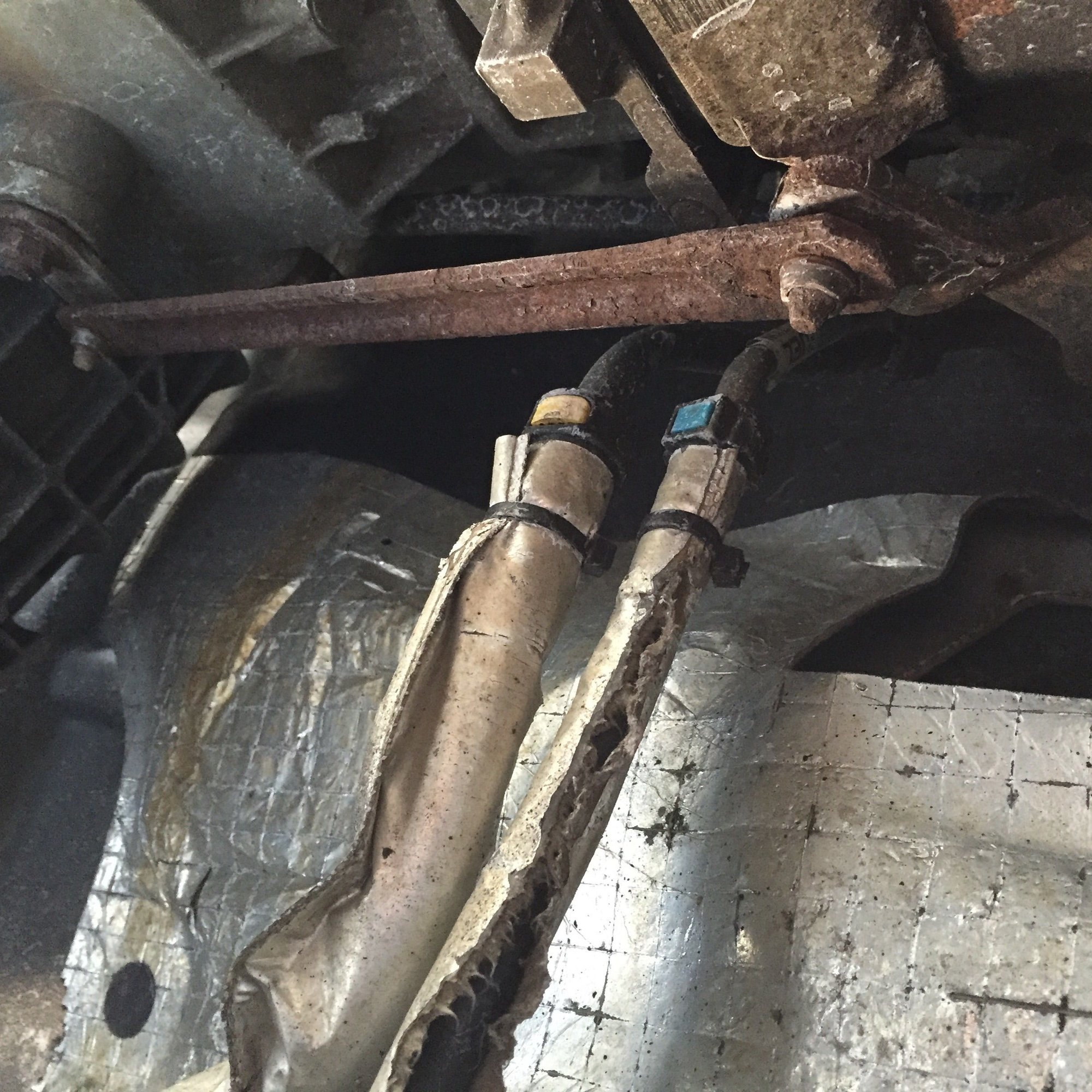

Just need some opinions from on here
2008 Ford F-350 with manual transfer case. I have the front driveshaft out for replacement and looking up at the linkage I can't help but think it needs replacement. It's rusty but I'm thinking it doesn't have to do that much work so I may leave it alone.
I attached a picture.
Thanks guys and girls

Just spray the pivot points with a good lube, then go from 2wd to 4wd low a few times and then relube. Shell be good to go

spray it with rust converter (spray in blue can sold at autozone and home depot), then spray it with rustolium.
