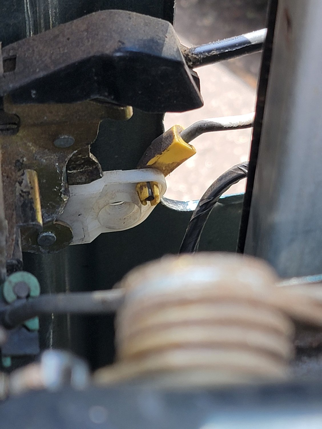

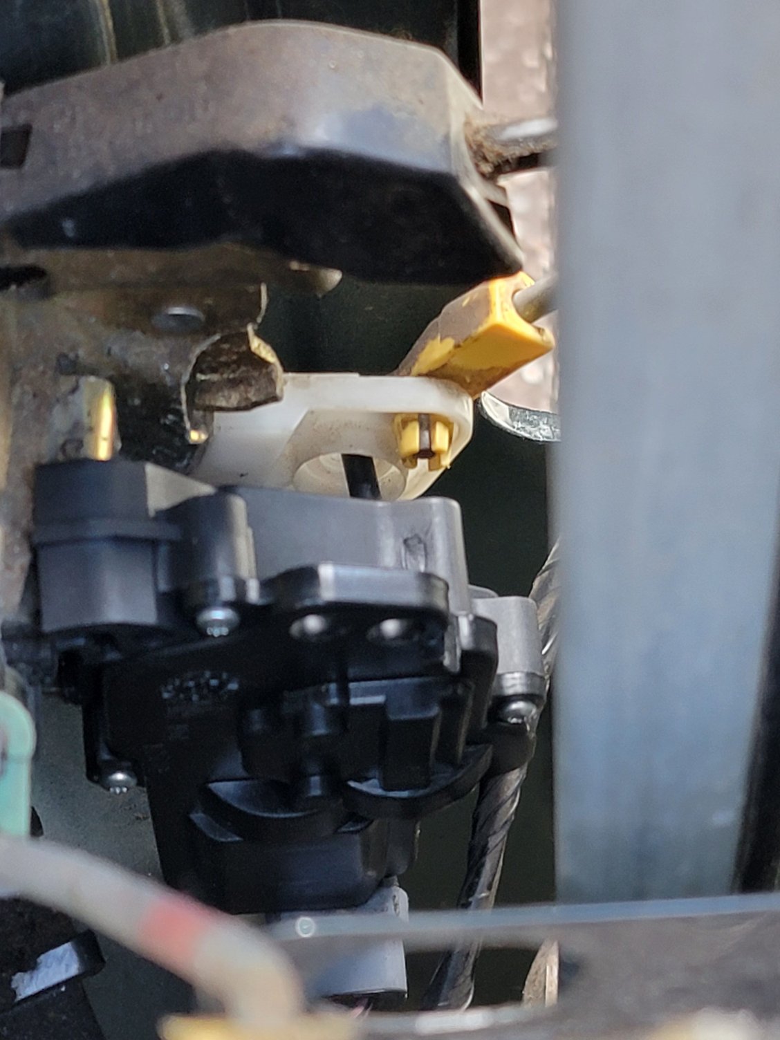

Just finished replacing front passenger side actuator. I used the video but there are some differences between front and back door. First, there are 3 rods connecting the handle to the locking assembly because of the key lock. Also, the lower nut holding the handle into the door is behind the window track and you will need an open-end wrench to loosen it and then you can remove by hand. I then pulled the handle assembly out of the way, leaving rods attached. Be sure to put something under the bolt ends so you don't scratch paint.
I could not get the pin on the movable arm to fit into the hole at first, you can see it won't line up in the third picture and I didn't want to bend or force anything. Finally, I figured out that you need to disconnect the rod connected to the plastic part the pin fits into. push the yellow clip holding the rod up and off the rod, then you can pull the rod end out. I was then able to get the pin to insert correctly while seating the actuator on the lock assembly. I would suggest lubricating lock assembly and making sure new part works before re-installing door panel.

The rod end in the yellow clip needs to be removed before installing the actuator. Push clip off
straight part of rod, then rod end slides out of white plastic part.
In this picture, you can see that I had the pin slightly bent and it still would not go in while the rod was still attached. You might thing the part is wrong, but it's not.
The job was not too bad once I figured it out. You have plenty of space to work once you have the door panel and insulation sheet out of the way. The door handle being moved out of the way gets more light on the subject and a better view of the other side of the actuator.
