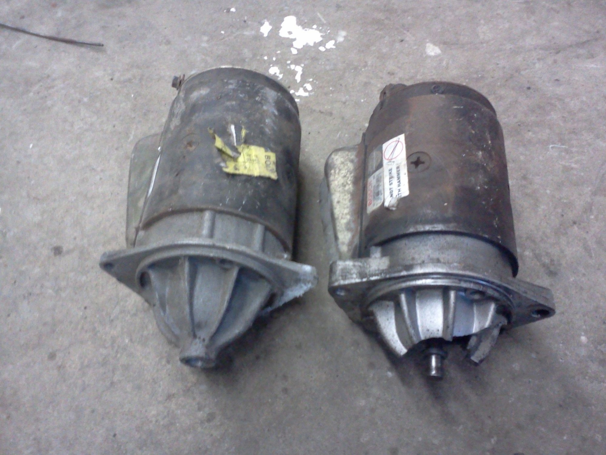

starter destruction, still started!!!

Built Ford tough...all the way down to the starter! lol

it was making a weird grinding noise for over 3 months so we finally decided to see what was going on with it and lo and behold, lol

What shape is your flexplate/flywheel in? When my starter broke like that my flexplate survived. Love how tough these trucks are. Lol

this is for a work truck, 77 460 auto, it was missing the inspection cover on the transmission so I assume all the pieces fell out of there before doing damage, what i could see of all the teeth on the wheel was that everything is good, no missing or chipped teeth

update: 2 and a half months later and new(old used) starter is working fine in the work truck
