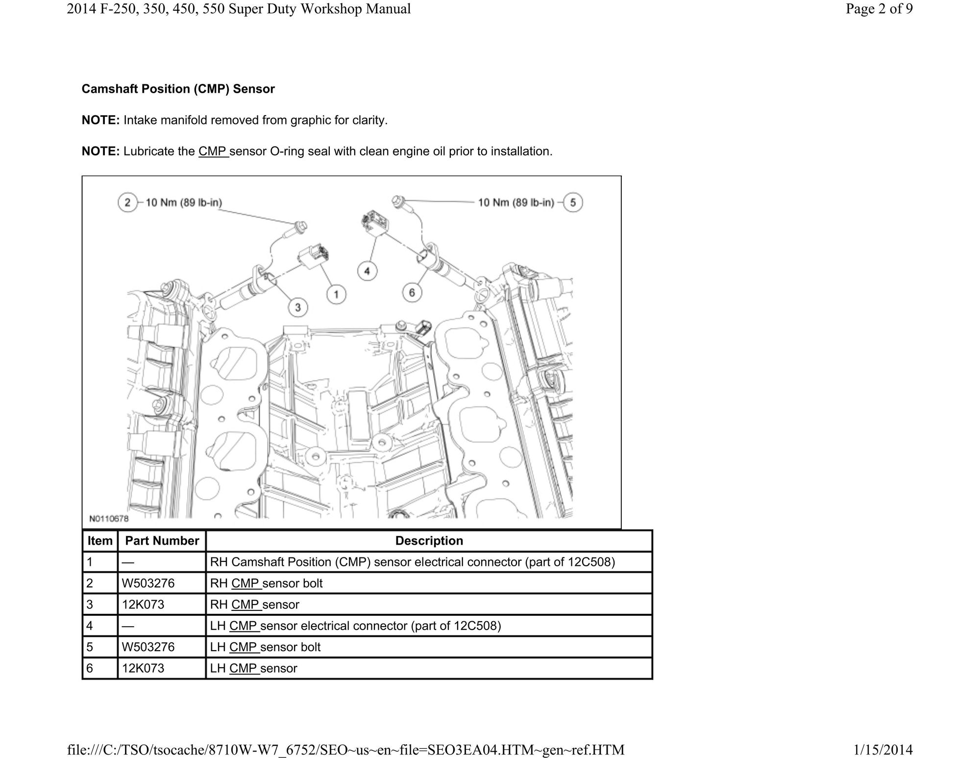

I have a 2011 f250 with the 6.2 liter gas engine. Lost power and the check engine light came on. I pulled the codes and it is a camshaft position sensor and 4 other codes for misfire on all cylinder for that bank. I can't find any info on where the sensor is located or how to replace it. Any help would be greatly appreciated.

They appear to be on the back side of each head.

Thanks. I was looking on the front side. Going to brave the cold and replace it.
