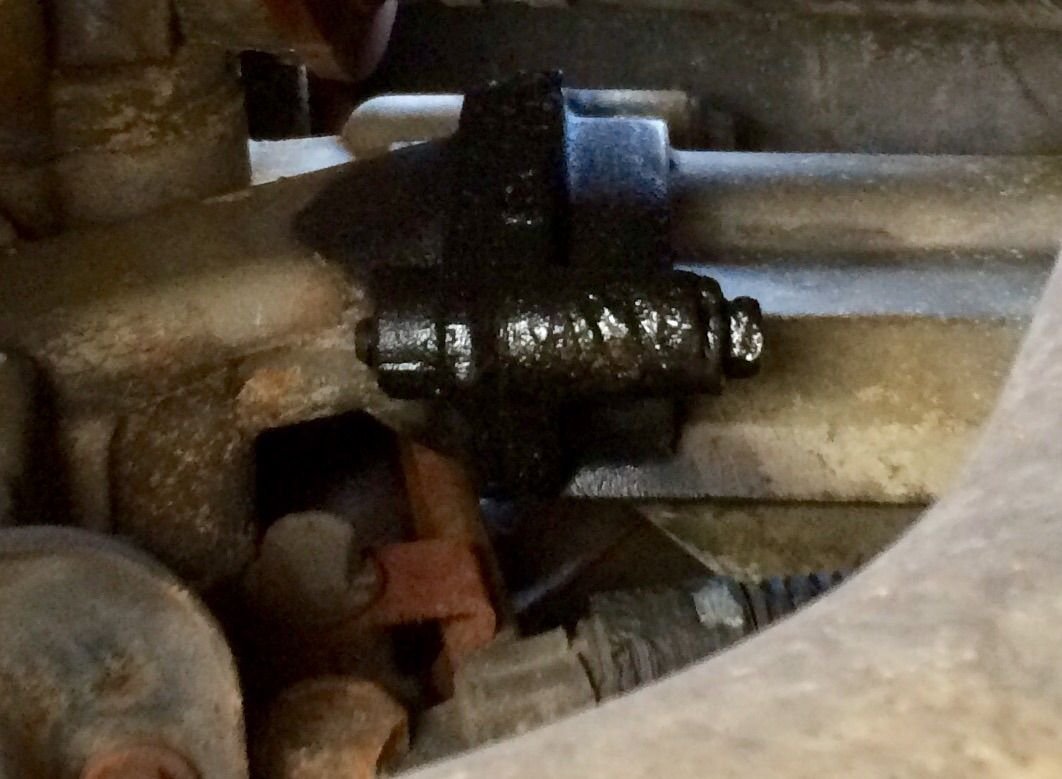

OK, I am by no means a mechanic so I'm throwing my situation out there to see if any other suggestions come in. I had an oil leak on my Excursion. It was slightly blowing out the front end of the oil cooler where the o rings are, and then it makes the 90 at the front adapter, and it was wet there from oil at the gasket.
So.............I bought new kit, put on new o rings at both ends of oil cooler, put on the two new gaskets, did an oil change. When I went to fill the coolant I noticed oil in the coolant reservoir which from reading around seems to happen if the o rings are bad. So I drained it and started to flush that system, ran the motor to warm up the thermostat, got one flush of water in it, started to do a second and ran the motor, it started to shake pretty rough and shut off. Noticed that the oil pressure light was on, checked the dipstick and I have no oil.
The only thought I have is that my oil cooler has an internal failure and the oil is constantly leaking out with the coolant. Any thoughts or place I screwed up?????

Okay, if you didn't have this issue prior to replacing the O-Rings, I'm fairly sure one has either rolled or split during the reinstallation of the cooler.

Mine was by no means anywhere near as bad as those images but I did make sure to smooth everything out for a seal, I guess I'll take it off and see if the o rings slid too far. I will def try the ratchet strap idea, a bar clamp is a joke!

Well sorry for this wasted thread.... Took it all back off an here's what I found.
