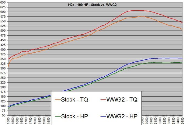

This is my stock injector truck with H2e turbo, WWII, Adrenalin HPOP, FRX, and BTS. 356 Hp but only 610 ftlb tq. I think PHP pulls some tq out of there tunes?

I can't actually see the RPM Graph so I'm guessing. But, that's okay. Because the Graph does look encouraging.
There is nothing to complain about this run.
Diesels are Torque Masters - They Top Out Quickly while RPM Horsepower is Steady.
The HP steadily increases following the Torque Peak.
There is a visible increase over stock. How noticeable? I'm guessing you wanted more. Or, you "expected" more I should say.
Well, it doesn't work that way. There are many different considerations. Injectors, Fuel, and Air are just a microcosm of the entire performance spectrum. Had this have been a loaded calculation, your torque would have taken off before 1,500 and the Hp would have been higher in the end of the run.

Bill at PHP said it was a good running truck based on all that he saw. He said he doesn't see many trucks make those numbers on stock injectors.
We didn't discuss specific results, the purpose of the runs was to provide feedback on how the WW2 would work on the h2e turbocharger.
I was pleased with the horsepower number but a little disappointed with the torque number, I expected 50+ more ft lbs. I wonder if do to the PMRs does Bill pulls some torque out of his tunes?
When you say loaded calculations, what does that mean? The dyno was pre-loaded with my vehicle weight about 10k.

350 hp on stock sticks! That sure is great IMO, that's what got me wanting the H2E so bad.

Thanks! Actually the WW2 bumped my numbers about 30 H.P. in that tune. About 17 H.P. bump in my stock tune.

CGMKCM,
I wonder if Tom might have thought your graph was the OP's?
Anyhow, I'm trying to recall the compressor map for the stock H2E. Wasn't the stock H2E setup geared more for higher rpm's? What a difference the wheel made.
Edit: How did the SOTP feel after the wheel upgrade?

Like I stated above. There is no shame in that run. It looks good.
What you have is a good overall "no load run". Which means the TQ/HP move in the same realm during acceleration. A more accurate snapshot of what's happening at the wheel and not the engine at the time of day you did it, the intake air temperature, the engine temperature, and the elevation you were at.
"Disappointment" shouldn't enter your mind. You set out to see what it would do on a WOT run. Now you have the information you set out to get.
You now have a fact to deal with. Do you want (or need) more Torque? That's the only thought you should have.
A "Loaded Run" takes into account many programming factors. Where, when, weather, heat, elevation, length of run, etc.
You can't "add or remove TQ" from a tune. You can adjust the fuel, timing, duration, and fool some sensors to improve it some.
**But, the down side is the functionality of the vehicle driven as a daily driver. Something must suffer - cause and effect. Do you want Economy or a raging engine which can't pass a Fuel point or something in-between.**
After doing Racing Motorcycle Engines for eons (which actually started as a hobby in the 80's). I've come to realize that an increase in one often is a deficit for the other. The optimum is to find a mix that will get you up, shoot you down lane, maintain the run, and not "fall on its face" (pass the of HP to TQ curve) doing it.
The question you should be asking yourself is; Do I want to increase the TQ? And, if the answer is yes, how do I go about doing it AND maintain or increase HP. The next is.......... "how much money you got?".
Here is the equation I tell people I use to determine that:
$$$$$$=(HP&TQ).
There is no other way. There are many people who use the phrase "there is no replacement for displacement" False, doesn't understand! It's called MONEY $$$.
While I can, and have run a Dyno's for years, I'm not the one you want doing it. Setting up the sensors, and programming the inputs are an art form. And one size does not fit all. A dedicated Diesel Tuning Dyno resembles nothing of a Gasoline Tuning Dyno. Same for Aspirated or injected. Sensors and inputs must be changed and spanned for the particular vehicle if you're doing tuning.
I build the engine based on what it's going to do and just as importantly where its going to do it. - Weather, elevation, etc. Then, I take it to Richard who is the top guy on a Dyno. He'll program the simulations, and run it and make selections and opinions based on the data he sees. Anyone can run a WOT Dyno and print a sheet.
It often takes up 6 - 10 hours to "dial one in" and 30 runs sometimes. The good guys will run them at 5% or 10% throttle position increments each time for just one run. That can be 10 runs WOT just to get an idea of what its doing before even considering what might need to be adjusted or replaced.
You ever wonder why you sign a release form when you get a Dyno run? I've carried many parts back from a dyno run until I got the engine right. HP=Engine Stress / TQ=Driveline Stress. How much stress can one take before a nervous breakdown? An Engine is no different.
