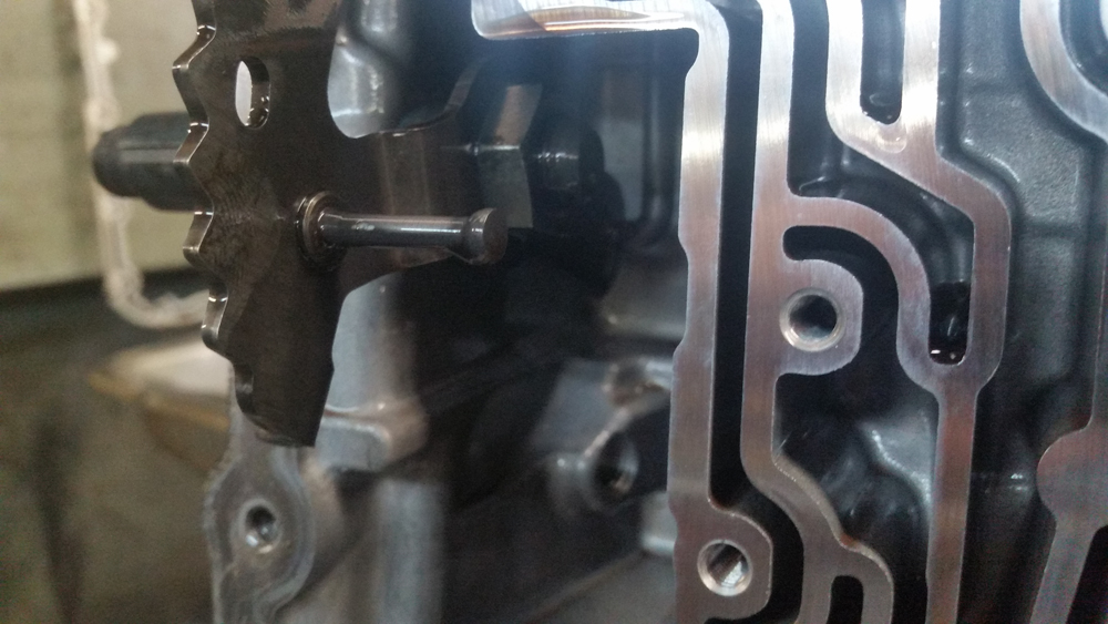

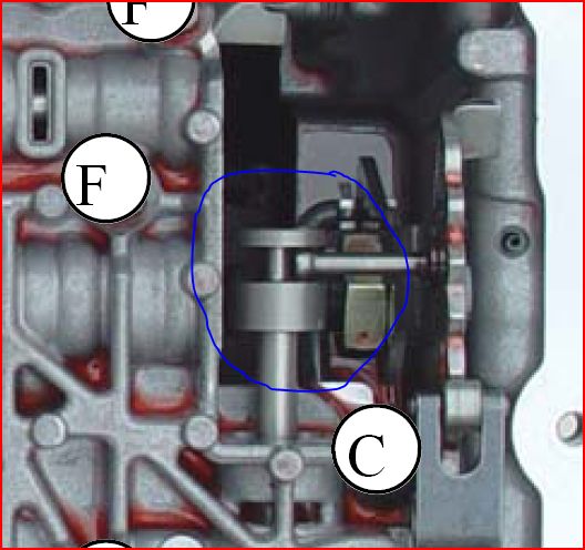

This is a pic of the internal linkage, the pin that is on the side indexes the manual valve, I bet this is broken off of yours.
I wouldn't worry about any of the tests with the linkage, just remove the pan the problem will be in there.

You will have to go to the dealer or rob one from a spare case. A transmission shop may have a case laying around or a transmission parts supplier could get it.
I think the Ford part# is 1L2P-7C494-BA or XW4P-7C494-AC, I found it listed in my parts book. Conform with your dealer that it is for your vehicle before ordering.

This information was very helpful. This is what was wrong with my vehicle. 2003 Ford Explorer.
However, what if the rod connected to the top of the rooster tail is pulled too far forward. Can I slide that back into the transmission, or is this going to cause me further issues.
