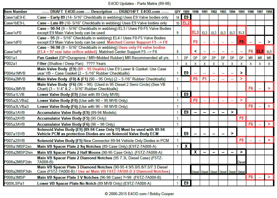

Any replacement option will have to be a Diesel case with matching Valve bodies, especially the Solenoid Valve Body as they are not the same as gas applications. Only a 89-94 Solenoid Body will work in your 92 truck because Ford moved the protection diodes (small electrical spike protection) from the solenoid ECM (control board on solenoid valve body) to the Power Control Module in 1995)
Was the 1st rebuild a Factory re-manufacture swap in or after 1995 ? If so, you could have the best trans to rebuild but, it depends on if any hard parts were damaged when you lost the cooler. If not sure, of what year case is now in your truck, you can look for a case casting # on the driver's side of the case above the pan lip, rear of the Shifter lever. If this number starts with "RF-E9......" its the original case & most likely weaker parts. If it happens to start with "RF-F5......." its most likely a Ford update replacement. You can't go by numbers on the extension housing as the original housing fits on a 1995+ case. It could also have the factory tag just above pan lip a little more to the rear that should indicate year / part number of the transmission as well.
The cost to have a diesel E4OD rebuilt is often between $1500-2500 depending on hard parts replacement. Forward and Direct Drums often get destroyed and some people tend to go for some of the updates. Like installing a better converter and adding extra clutches either by appropriate mod or use of a thinner pressure plates. Also using valve body & pump valve/spring "cure kits".
Then some people (like myself) who mainly did engine repairs chose to overhaul this beast of a trans and do it successfully for $500-$675.
Here is some information that might help you decide which way to go.
E4OD Free Tips eBook This eBook has been downloaded over 7,100 times from Download.com It gives you a better understanding of the E4OD transmission.
For E4OD Parts Matrix to open the PDF file. click here: http://e4od.com/ebook/download/examp...ion_detail.pdf
