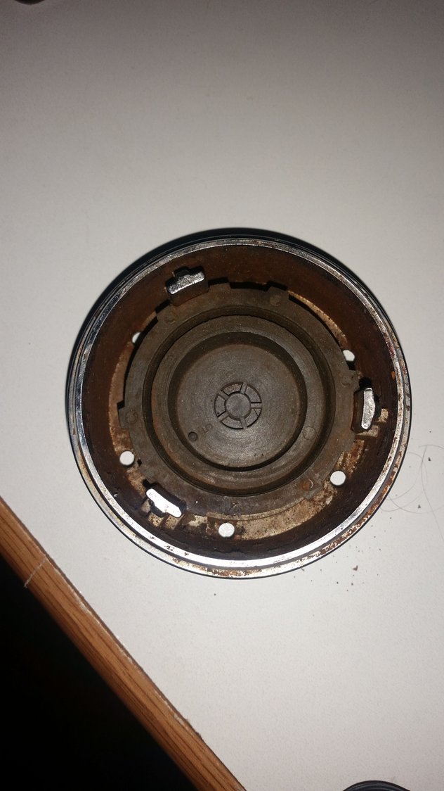

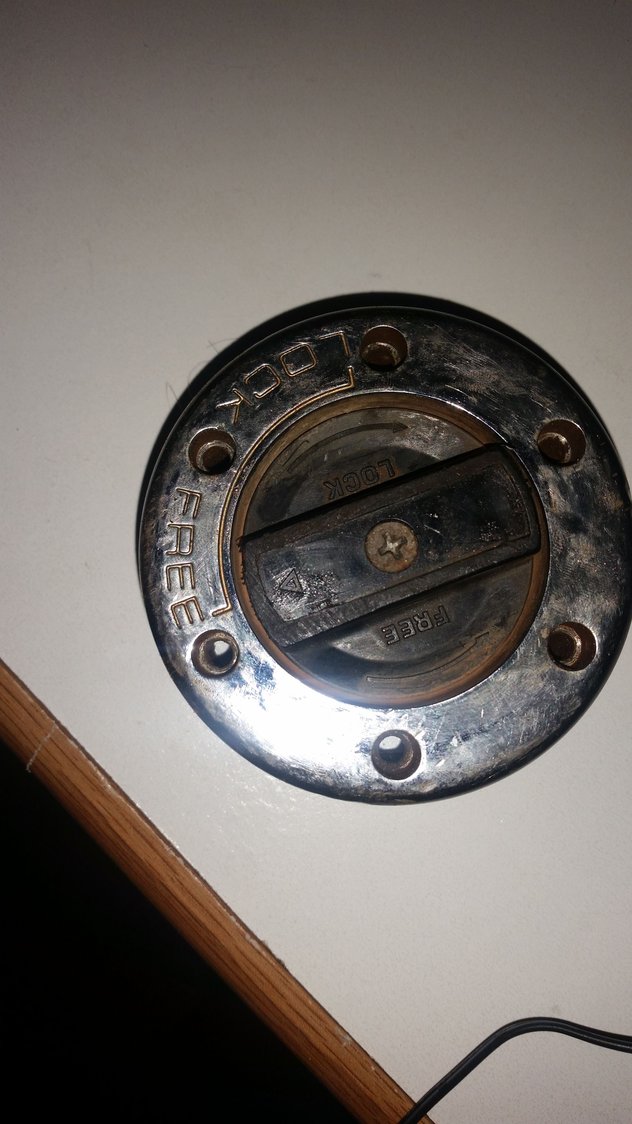

Hi guys, my hubs on my 94 are trying to engage at under 5mph and make a clicking/ratcheting sound at speed. Will these work with conversion kit? Got them from previous owner.

Sure they'll work as long as you have the rest of the parts that go with them. Your pictures only show the cap, you also need the slugs that go inside the hub since the auto ones are completely different from the manual ones.

And the different wheel bearing nuts. Autos use different ones than manuals
