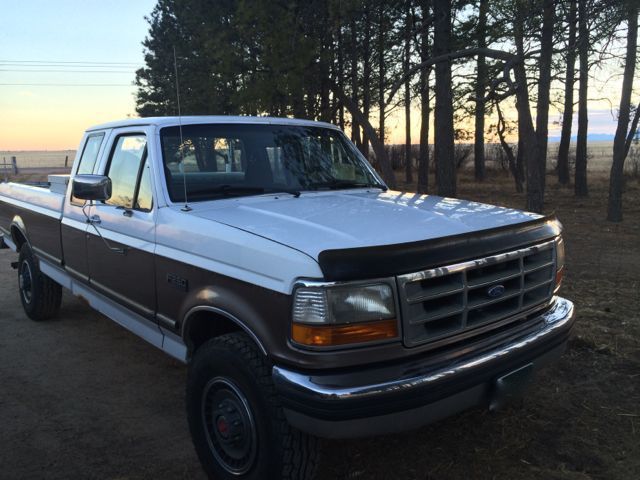

Bubba is an old farm truck I purchased in May 2014 from a farmer/rancher in southern Colorado. Only had 136k on it when I bought it, plus about 100 pounds of mud on the undercarriage. Previous owner had a new computer and distributor put on in the last year or so, but otherwise I’m concerned about how regularly he maintained it. My goal is to have this be my daughters first vehicle – she’ll be 3 in June, meaning the truck will be 36 years old when she gets her license.
Prior to this vehicle, I have never worked on my own vehicle before. I understand the concepts and basic functions of many aspects of vehicles, but am a complete novice at the work itself. I'm setting up this thread to track my and Ol’ Bubba’s progress over the years to come. Y'all have been a godsend so far and I appreciate everyone’s expertise.
