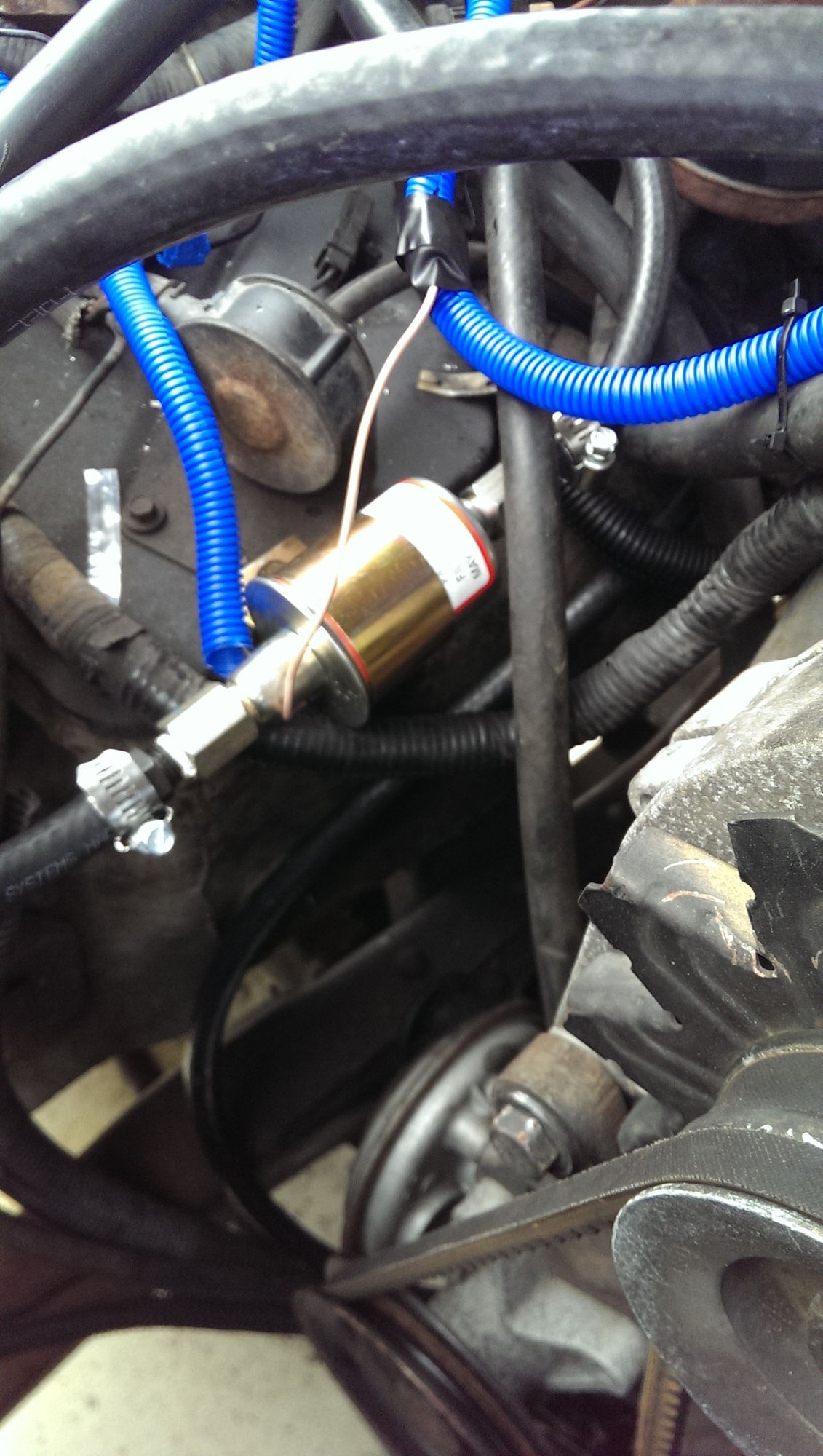

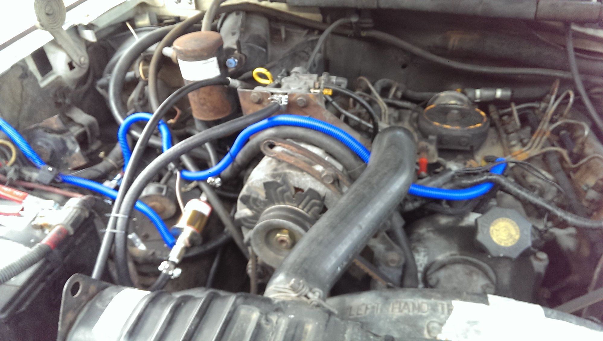

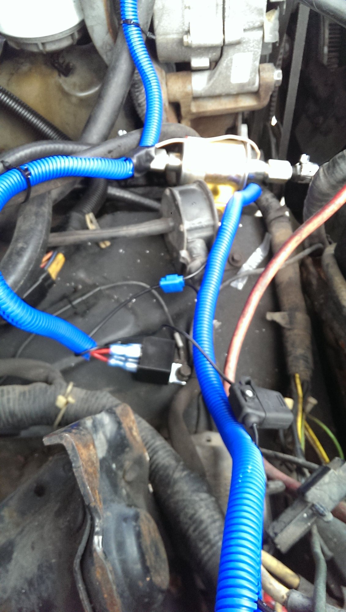

Huge update...
Ok so i got fed up with the stupid mechanical lift pump so i went big and replaced the whole thing with an electric fuel pump... works great i have a 30a relay and all that other crap i read off the forum. Fuel pump cover plate installed looks really nice works really nice... anyways i turn the key (circut relay spliced into the Fuel shutoff solenoid) pump starts pumping... boom fuel up to the fuel filter in a hurry.... i push in the pin on top and get some air then a nice gush of fuel im like sweeeettt! so now im wondering how am i supposed to prime the rest of the way... i cracked a couple then all of the lines and held down the throttle while the pump pumped... nothing... not sure what to do now... im wondering if there is some sort of blockage... both wires "click" when i disconnect reconnect. i hope im just not seeing the obvious here. im feeling better though plus miller highlife helps.

Yeah that was my main question guess I'll hve to wait for the batteries to charge.... I used an airtex I believe here's some pics didn't take more than an hour or two.
Blue is new
Relay inline fuse...
Pump
BayStYat
