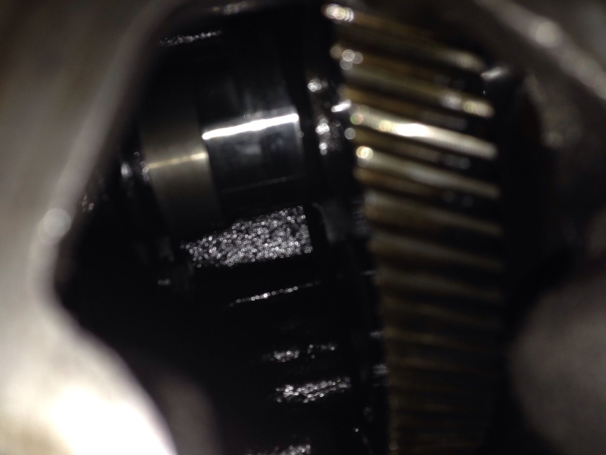

International procedure says to hand crank the engine until the notch on the harmonic balancer is at the top. There is a 50% chance this will put the cam lobe in the proper position for installation. If it is correct it will look like this inside of the pump mounting hole.

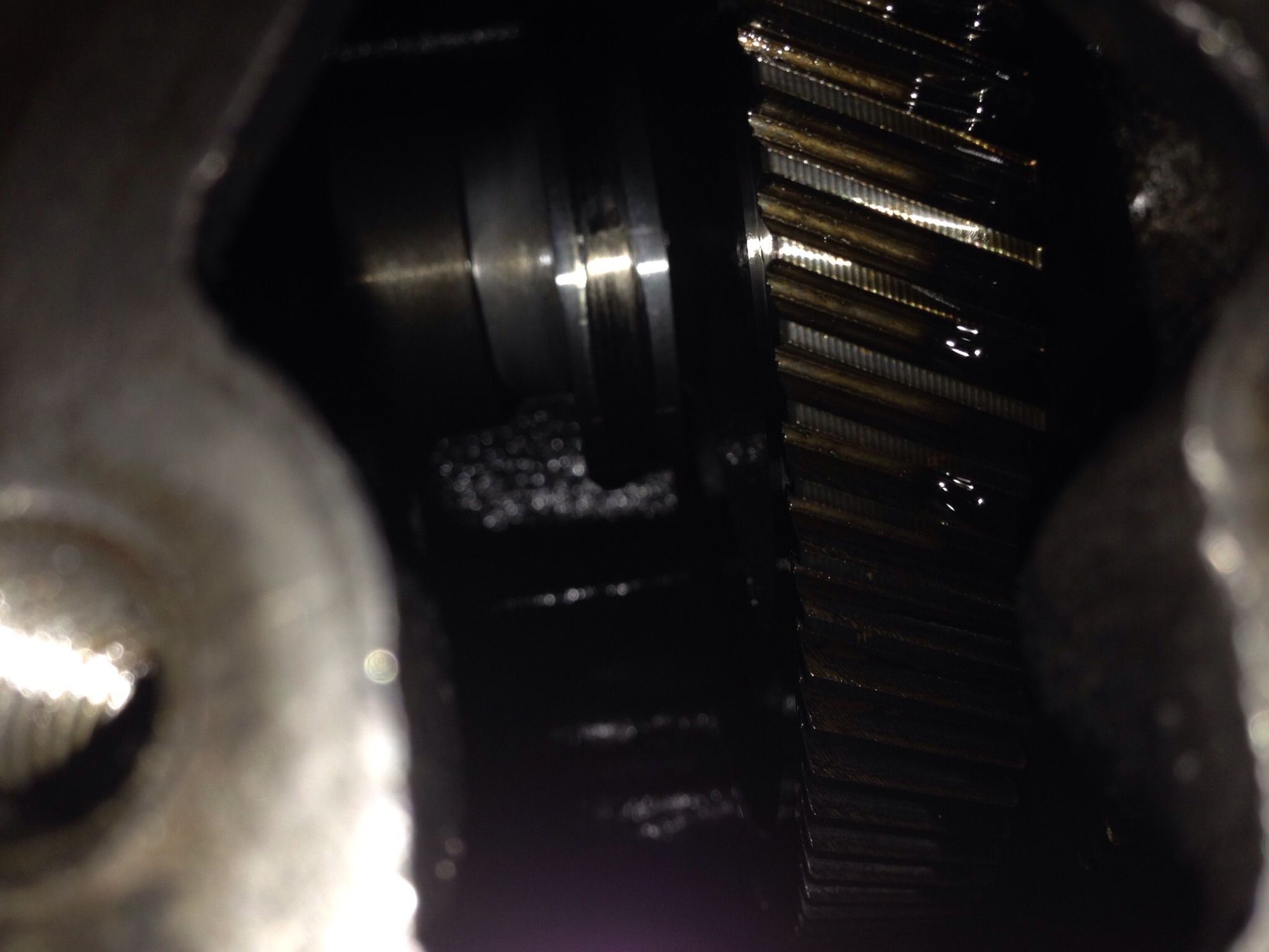

If it is wrong it will look like this:
It it is wrong rotate engine by hand 360 degrees and put the mark back on top. I used a camera phone with flash to check.

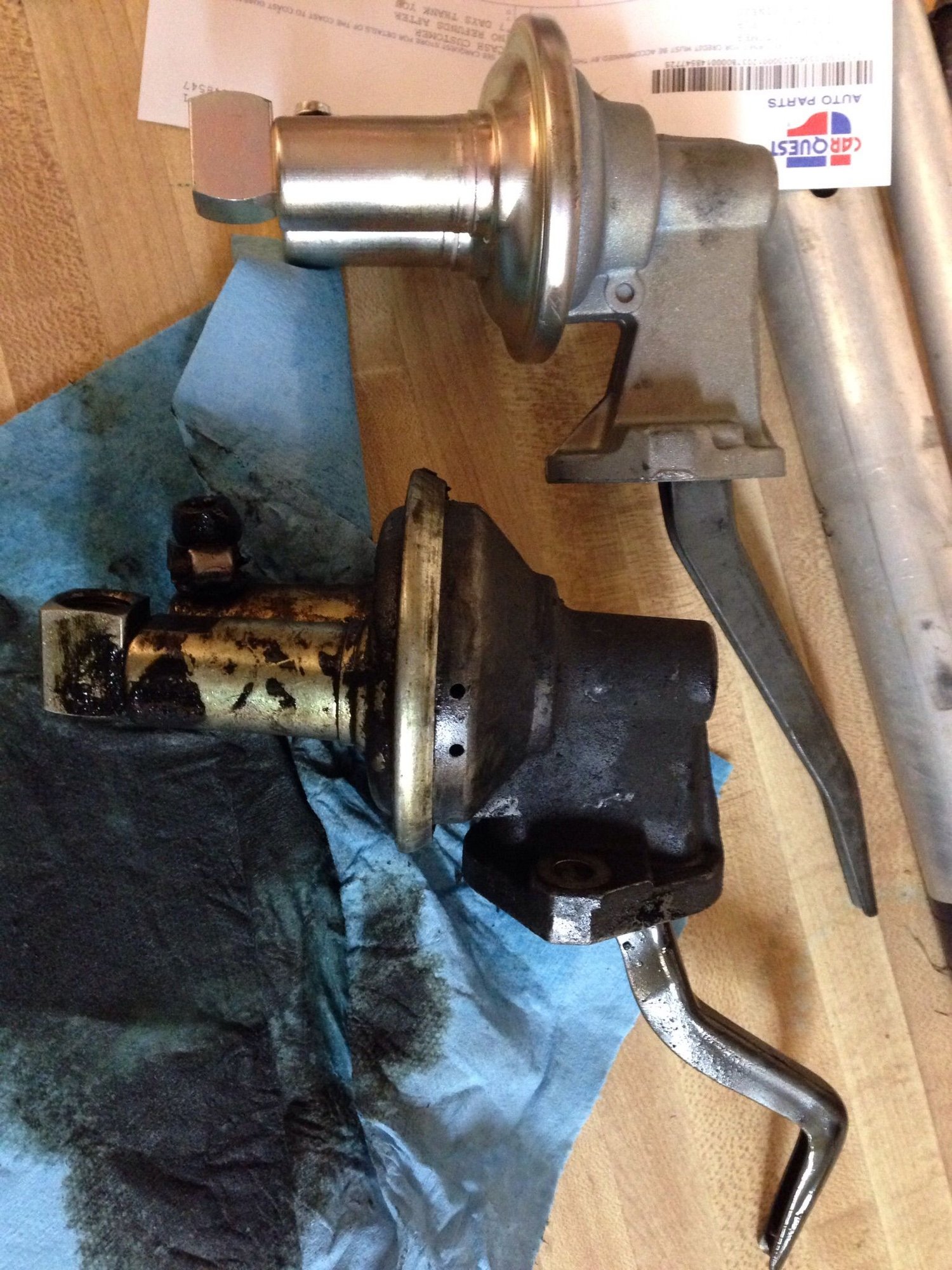

I'm not going to go into details about installation, however did want to note that there are two different styles of pump arms and the one you remove may not look the same as the one you are getting ready to install. Either style is OK to use.

Personal experience is that if you're putting in a straight-lever pump(like your new one), you don't need to worry about the position of the cam. Just put the pump in with the lever angling down, and then tip the pump down until the housing is square to the block, put the bolts in and you're done.
Just be aware that when doing this, you are pumping the pump, so if it's full of fuel while doing this you will have fuel spurting out. A new pump should be empty, however.

this is how i do it. you will know if you are under the cam because you will feel a little resistance when you try to straighten it out to put the bolts in.
works every time.
