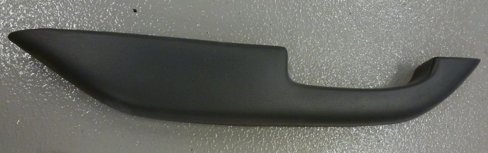

Need help fixing driver side door panel part
Ford F150 1990 2WD
I am not sure what this part is called. I use it to close my driver side door. When I pulled on it, it broke off the screw. Age has taken its toll. Passenger side is great. Is there any quick fixes? I have the hardest time closing my door now.

Looks like you could put a new screw in after removing the panel, using some wood filler on that stuff that the screw needs to hold into first.
You may even be able to just glue or JB weld the handle back on and be done with it..

To finish this post, I had to remove the door panel. Looks as though it was removed before and not all the door fasteners were in very tight. I did not remove the switches from the door.
As you can see there are three screws that needed to be removed (one that broke) from the inside panel. Then the door pull comes out. It has a plastic piece that had broken in three places surrounded by age old foam mold. The form had deteriorated and crumbled. But it still held together. Used an old trick - super glue and baking soda to hold/fasten the broken plastic together again. It seems tight and I put everything back. Hopefully it will hold. Time will tell I guess.

That part is the armrest

I just replaced the pair of armrests in my truck with new (poorly fitting) ones from LMC.
​​​​​​​Shouldn't there be two screws from the bottom as well as three screws from the side?
