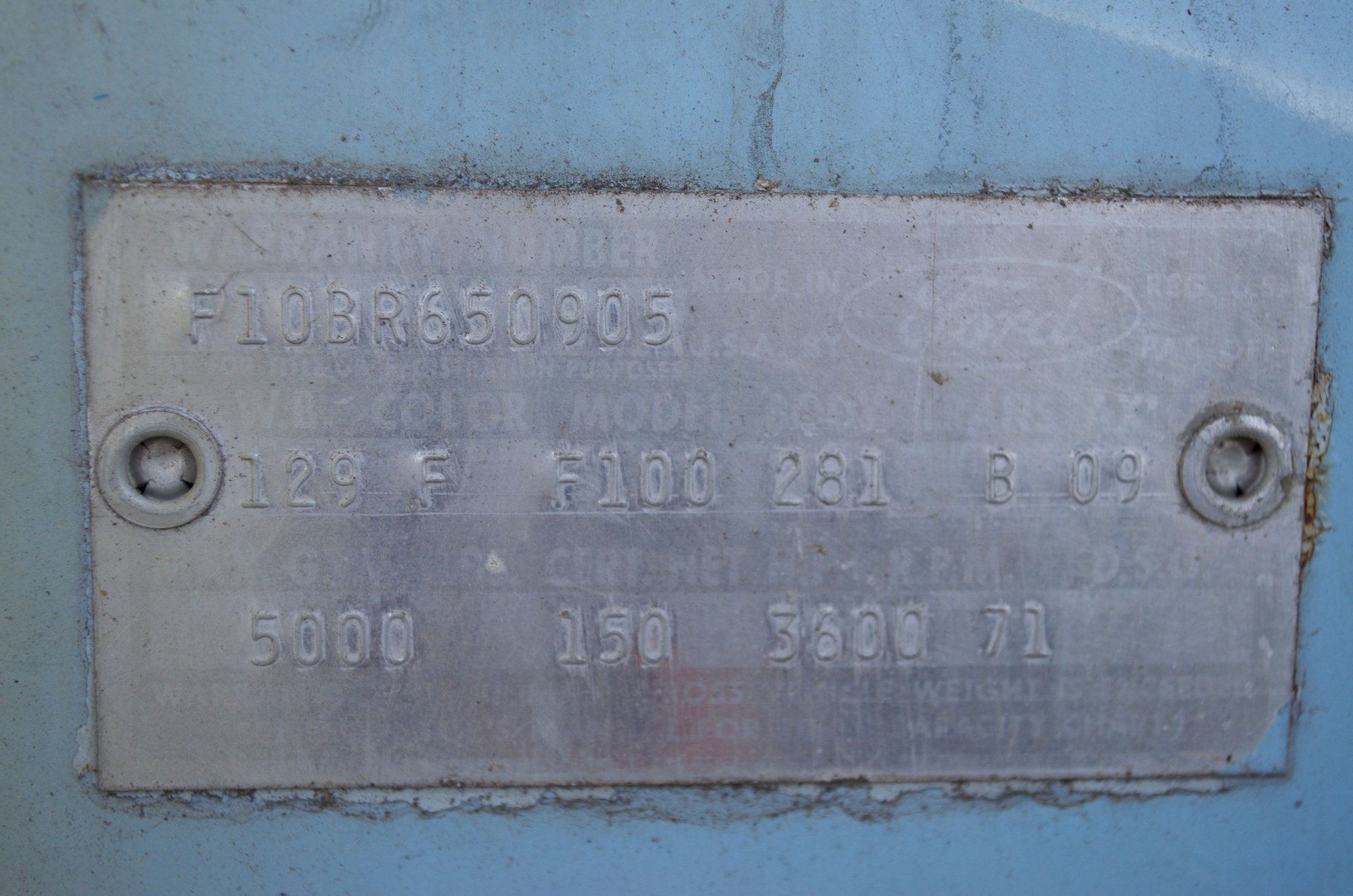

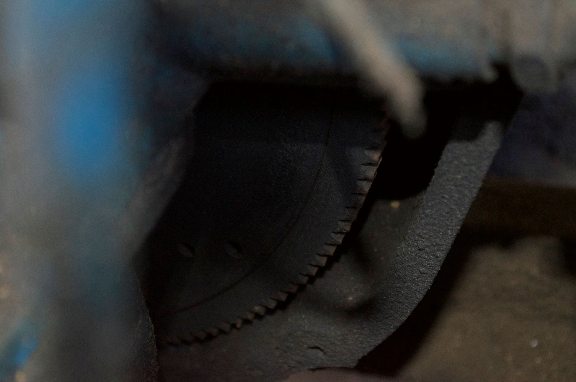

Here is the warranty plate, and I noticed this as well. I can't believe the flywheel would be exposed but it is. Anyones thoughts
missing a plate?

Looks like the inspection plate is missing. It isn't critical, but it does keep foreign matter out of the clutch area.
One more item to put on your parts list, but it can wait.

On my Thunderbird, someone swapped out the transmission for one that was compatible, but not an exact replacement. One of the things that didn't fit was the inspection plate, which they apparently threw away.
I ordered the one correct for my year and model--didn't work, of course, so it was a process of trial and error getting the right one. No clue how long it was driven without the plate, but at least 10k miles without doing any damage.

Seems like a common thing. My 67 mustang has no inspection plate either. Havent really looked at the trucks yet
