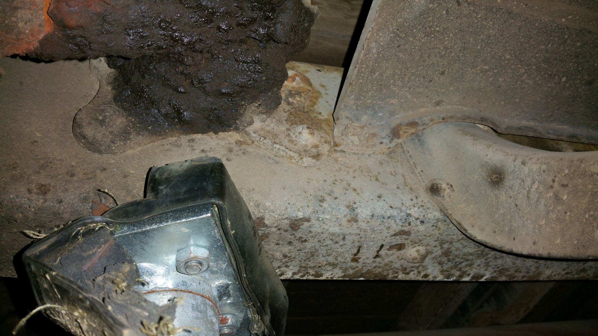

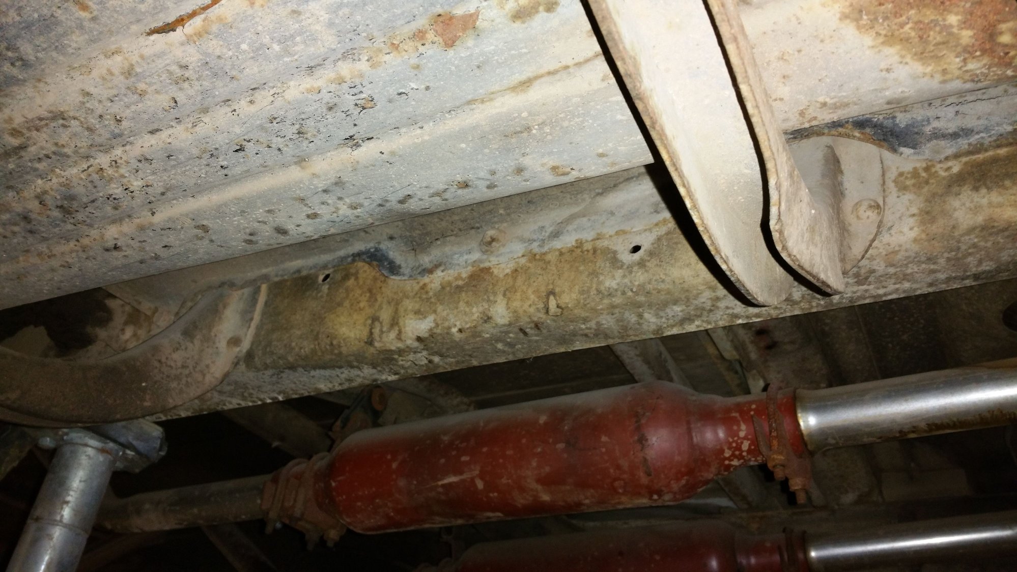

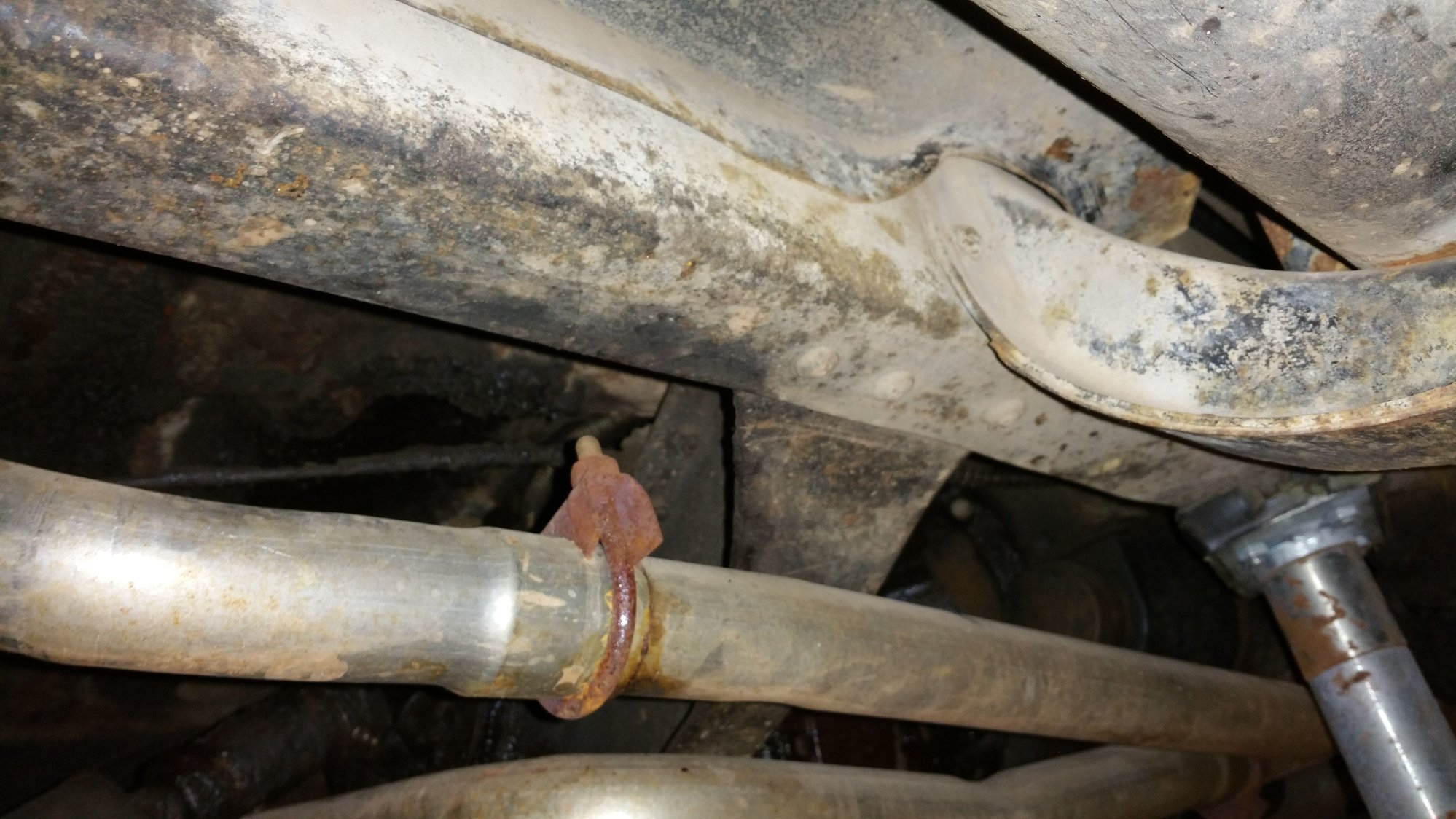

I don't know what to say about the frame, but I saw nothing that looks modified, cut or otherwise. All the brackets (spring, running board supports and cross members) are riveted to the frame.
Passenger side, rear two board brakets:
Passenger side front board bracket, trans crossmember:
Passenger side, rear spring, front bracket:
Passenger side, rear spring, rear bracket:

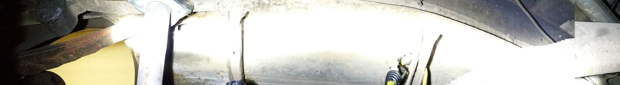

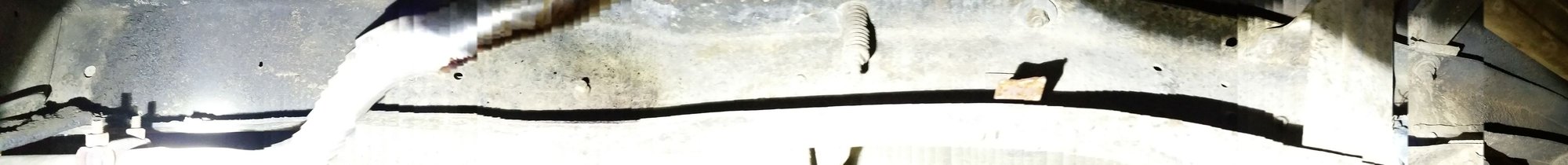

These are some panoramic pics that didn't really work.....

I didn't think to take a picture, but both the front and rear u-bolts for the springs have larger nuts on the to take up space. I assume this was because they ran out of threads.
Springs removed? Maybe both front and rears were changed to 1/2 ton at some point? Are 1/2 and 1 the same width springs?
I'm rather confused

Is there anything irregular looking around the VIN stamping? It's not unheard of to have a frame restamped. Nothing anybody would admit to doing of course. Stu

The frame looks fine in the general area. The only thing I noticed was some weld on the part to make the frame boxed to hold the steering box. Looks like that area had a rough go.

I doubt if this solves anything but Ford used to have a stamping kit available to dealers with the correct font and the star. I doubt if the half ton and one ton used the same springs. It is nice to see they kept the springs greased, most didn't. The front fenders are definitely one ton.

The front axles are actually the same between the ½ and 1 ton. Both are 21Y part numbers, so the front axle is not a good way to id between the 2.
Also, the truck has rear Houdaille shocks. Tonners did not have rear shocks at all.
It is entirely possible that the number was stamped wrong. Remember, these were hand built, and the numbers were hand stamped. It happens, and unless you know the numbers one would never know they might be mis-stamped. The number says Tonner, but everything else is ½ ton. I think it's safe to say that this is just a Ford oddity, something that does happen now and then.
