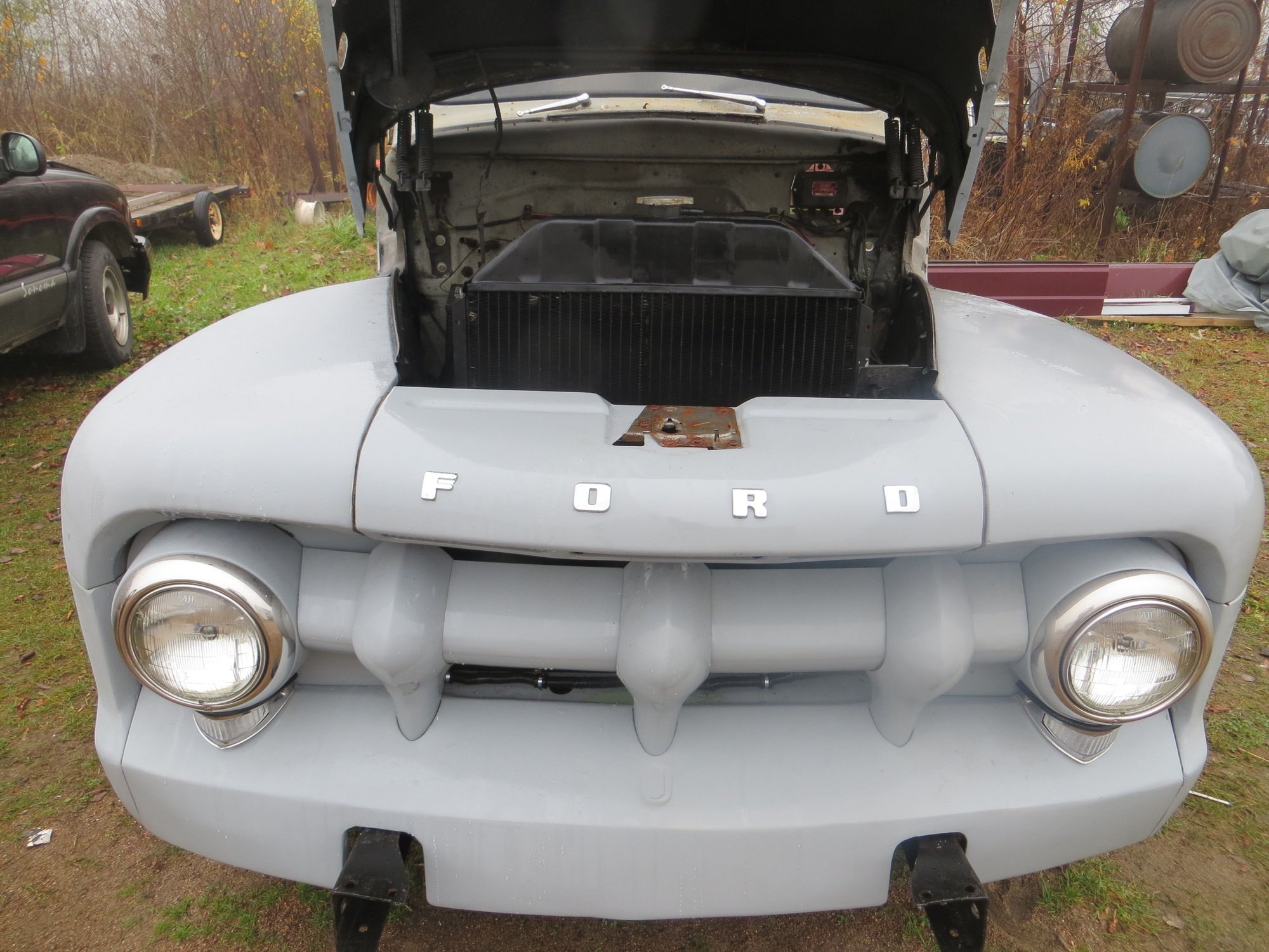

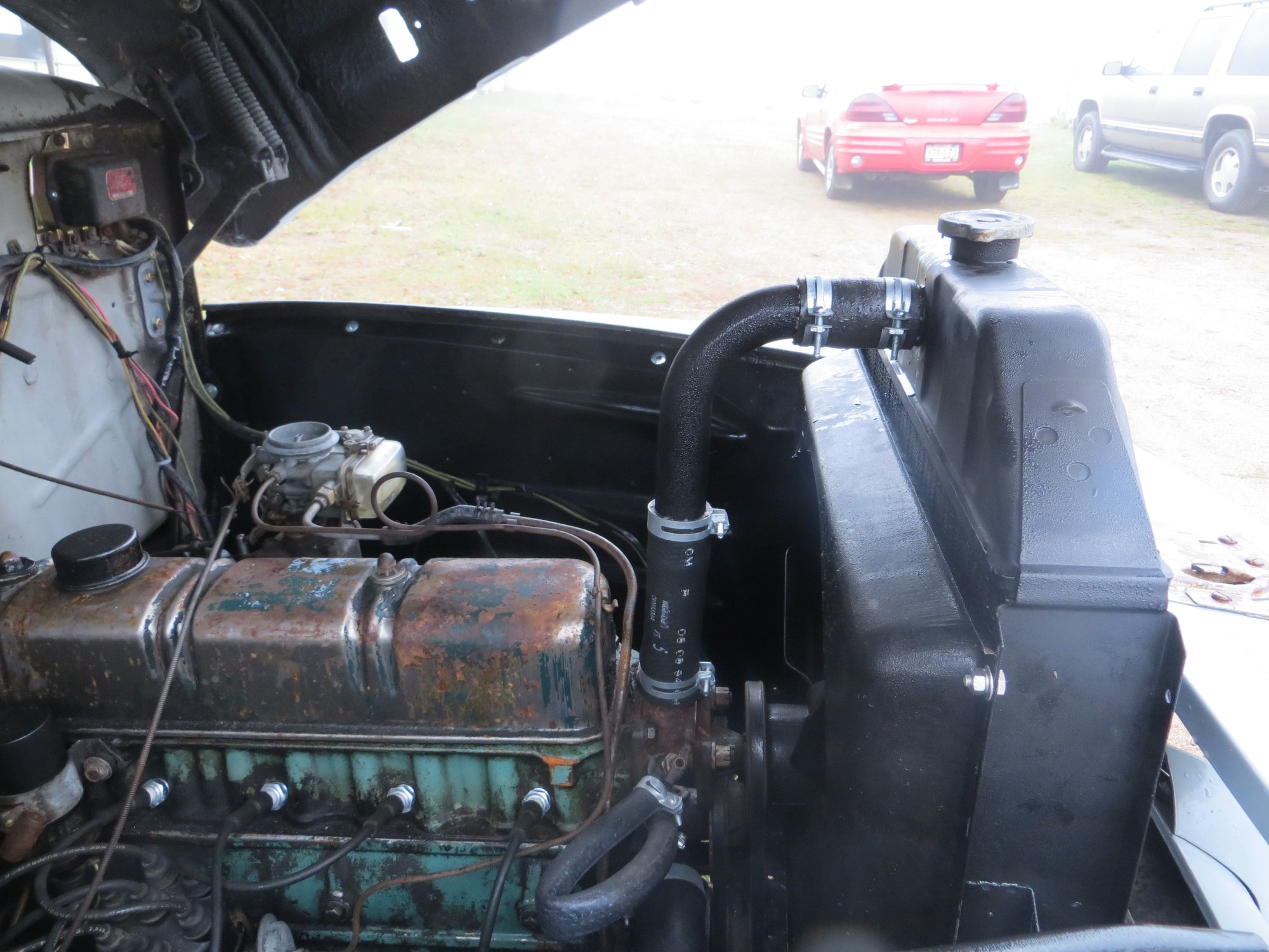

So, the transplant of the Classic Haulers' brass and copper four row radiator is finally complete. This is what it looks like:
From another angle:
As has already been noted, the new radiator is a little taller than the original. The holes for attaching the new radiator didn't quite match up and the adjustments to the holes made the radiator sit even taller. Closing the hood is a very close thing. I think I have about a half inch to spare, but my hood needs some major adjustments to fit properly. Hopefully the half inch clearance will hold up.
I have the original mandrel bent tube for my upper radiator hose set-up. To accommodate the height of the new radiator, I had to increase the short rubber connecting hose from 3 inches to 6. Sadly this kind of spoils the stock look I had going on with my rare medal tube.
The holes for the shroud didn't match up at all. New holes had to be drilled. I can't speak yet on how the new radiator performs, but as far as installation goes, it didn't exactly just bolt right in. The jury is still out on whether or not my hood is going to close.
Jim

To be honest, with a shroud I wouldn't think your really need the under-hood air seals, if they turn out to interfere.

Good point. Thanks. That under hood air seal is where I measured my clearance from. The sides fit--the top is the low point.

The hood baffle serves as a stiffening brace in addition to being an air deflector. I'd keep it if at all possible and trim the opening, if necessary.
