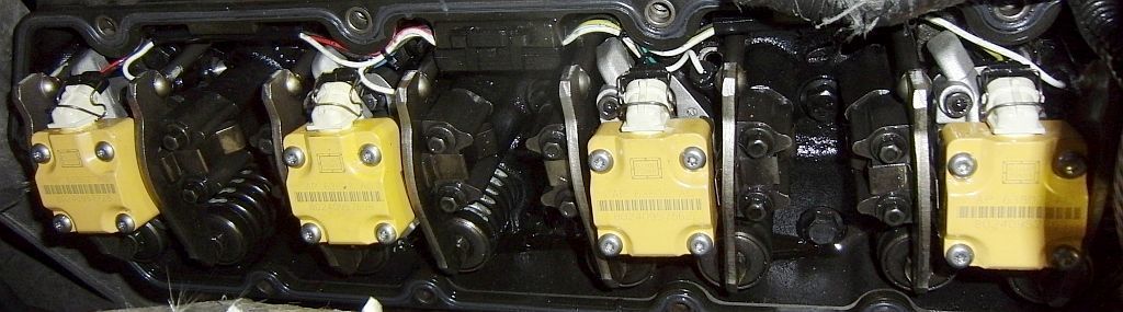

using a straight-edge across the injectors, will confirm that all injectors are seated equally

When you say you have smoke coming out of the valve cover. First see if you take the oil fill cap off and turn it upside down on fill tube does the crankcase pressure blow the cap off? Next is the smoke is coming out of one valve cover more than the other. Put the oil fill cap on Rt side and disconnect the ccv hose to the intake at the same time to see if it is equal amount of smoke or not. Because it sounds like you have way to much crankcase pressure and if that is the case I can only think of two things that might case that first would be very bad ring blow by which could be confirmed with compression test the second thing would be the injector not seated correctly or copper washer on injector came off. We already confirmed you removed the old copper washers early in the thread..right? Because double copper washer would be a problem. I would think the best way to check that would be pull the valve covers and set a straight edge across the top of injectors and if you are good there then start it up with VC's off and if you are getting compression around the injector You'll know it.
OK I get what your saying now.
