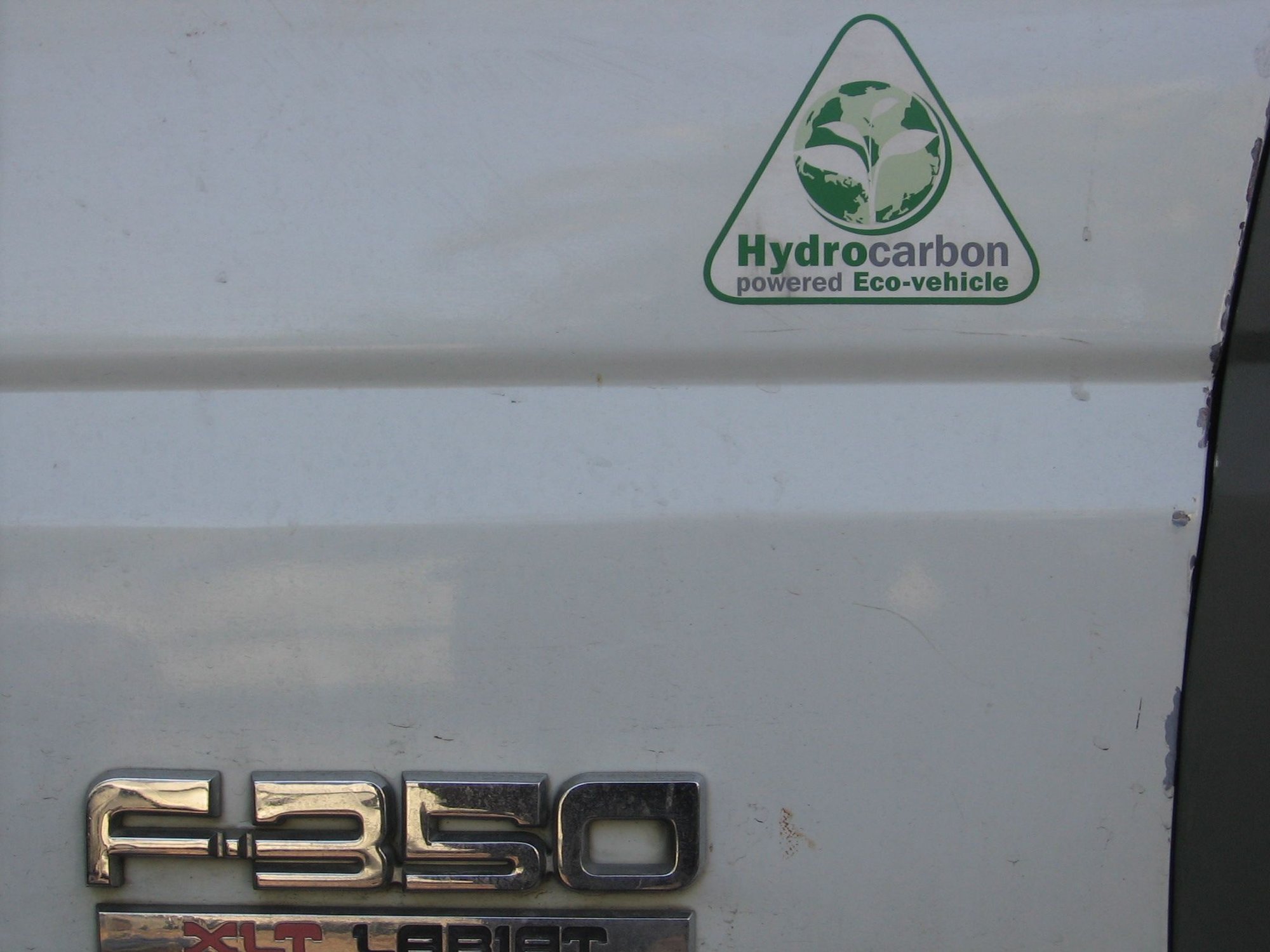

well sometimes the path of least resistance is a preferred method.
1) Environment conscience
2) Cheapest easiest method of parts replacement.
I mean really, how can you argue that?
I want to know what it is like to warm up my truck in Florida since I am so lazy I wont bother to make the GP system work.
I forgot how it worked, I was direct jumping it before to lite her up, well after my last rebuild I decided plug it in instead.
I have about 35,000 on this build for the engine and every single start is a warm one.
It will not start unassisted in the mornings even at lets say 80F
So I always park no further than 50ft to a smart car
I mean I have a "SMART" truck so like WTF?

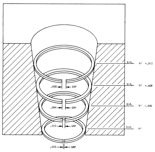

The reason I have to be a pain in the rear is the fact that diesel cold starts wear the hell out of the top of the cylinder bore and that bothers me like no tommorow.
I like my bores nice and straight top to bottom.
However I can aide in that happening I follow that course
I love these guys that say "Oh the cylinders still have a crosshatch!"
"Still Good!"never has held a bore gauge in a cylinder.
I witnessed how much wear I had in my 7.3 with only 7,000 miles on a 100% overhaul that went south from a collapsed lower rad hose @ 80mph.
I was rather pissed the hell off already but when the heads came off and I saw the tops of the cylinder getting the first signs of tapered wear
, I was hot
So that is the primary reason I have plugged it in now for the past 2 years the truck has been running.
