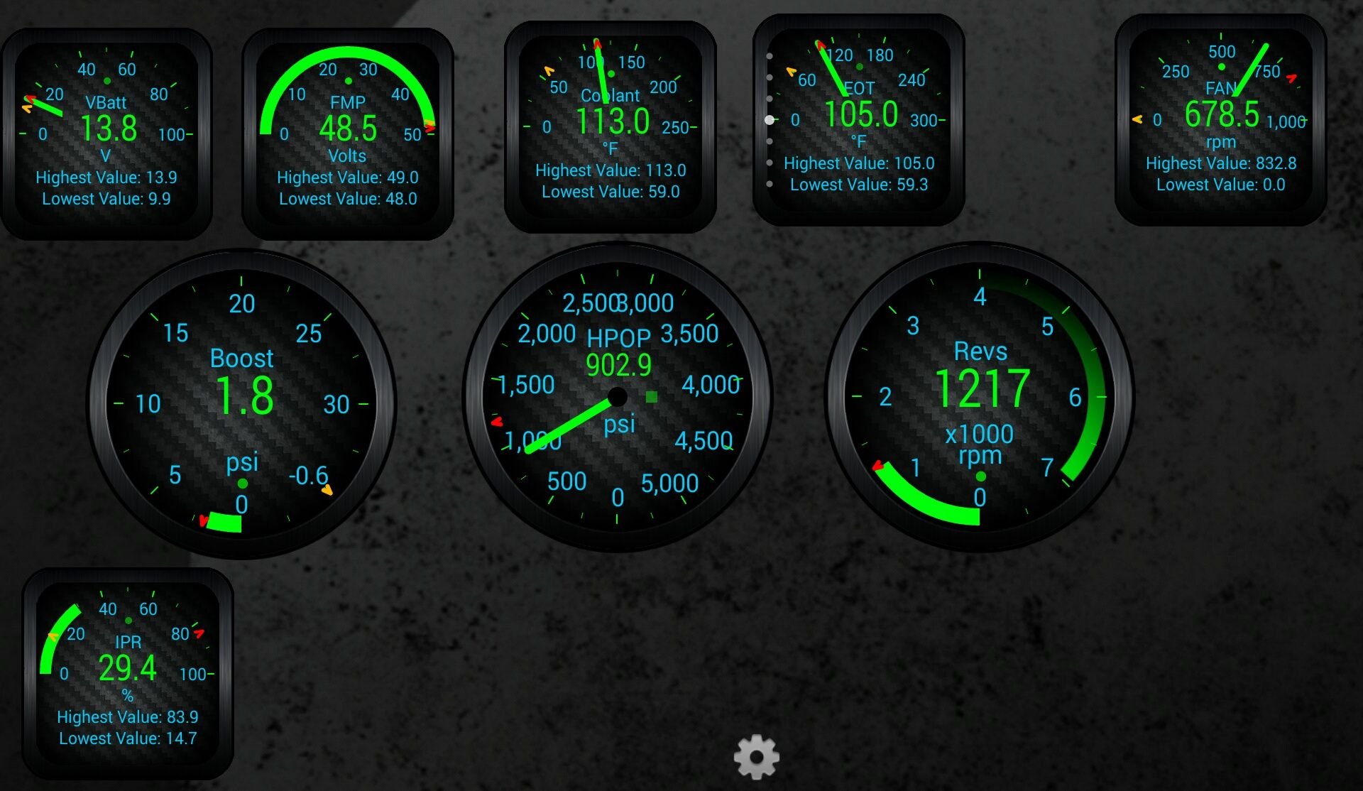

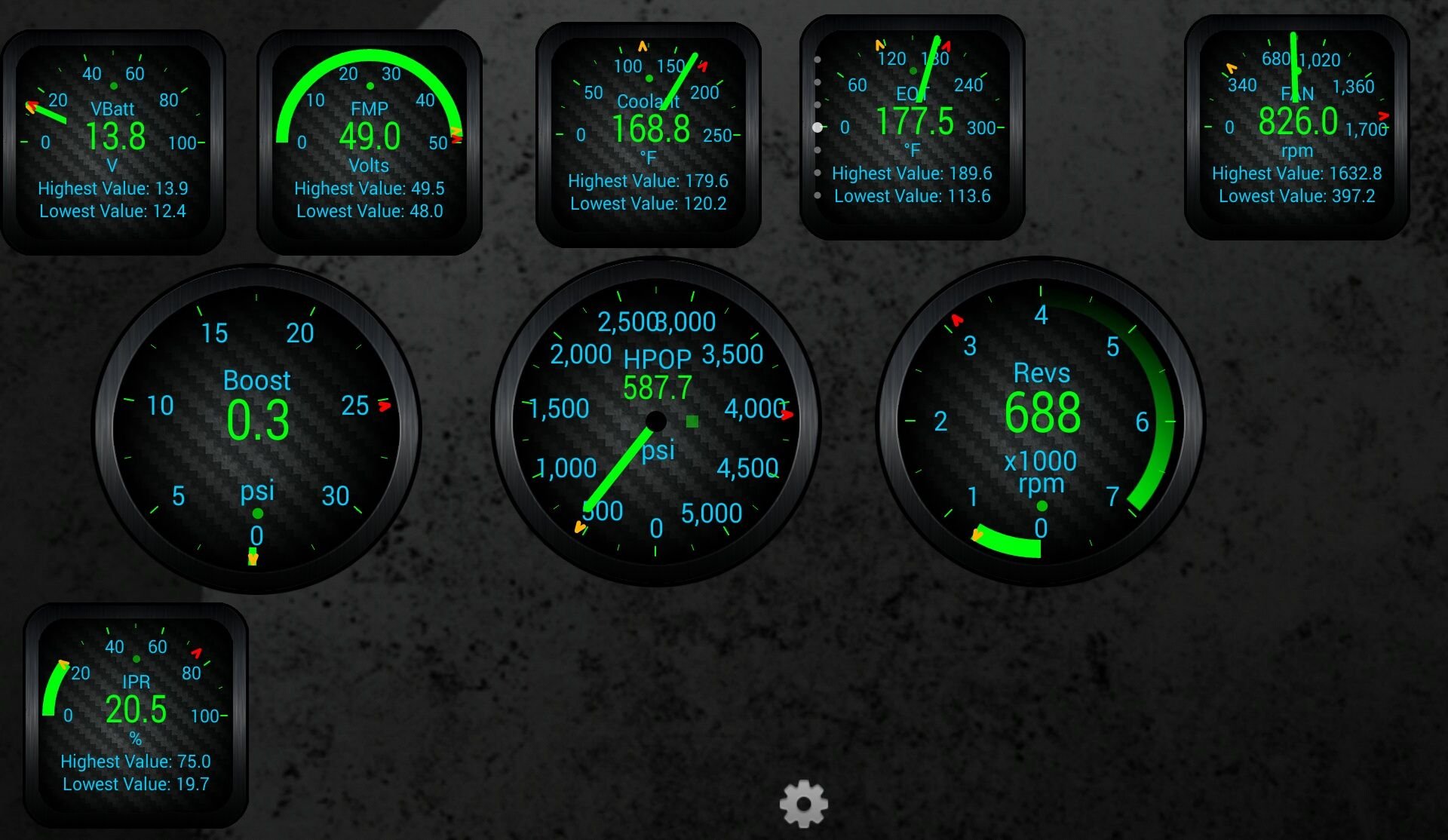

Old Nov 24, 2014 | 07:33 AM
the4by4freek's Avatar
the4by4freek
Joined: Sep 2002
Posts: 1,264
From: North Carolina
Old Nov 24, 2014 | 07:35 AM
the4by4freek
Joined: Sep 2002
Posts: 1,264
This was cold immediately after startup
Old Nov 24, 2014 | 08:31 AM
KBOFVA's Avatar
KBOFVA
Joined: Oct 2014
Posts: 23
From: Roanoke
which program are you using to get you spec screen
