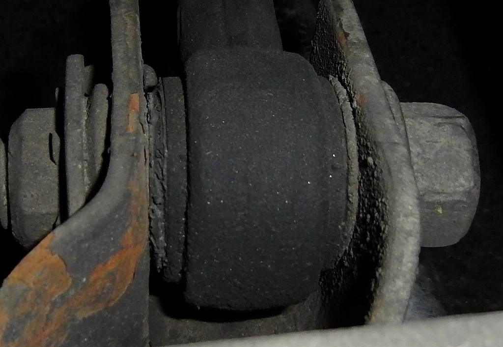

Front-end experts - does this look right?
Track bar upper bushing:
Track bar lower bushing:
Old Nov 18, 2014 | 07:57 PM
TKegs763's Avatar
TKegs763
Joined: Dec 2012
Posts: 373
From: Arlington, Texas
Definitely looks cracked and dry.. I just installed a new Moog track bar on mine a few weeks ago. Got it for $100 at Irish Parts. What do your sway bar bushings look like?

From "looks alone" they appear to be dry and weathered. Is there movement from the counterpoint in any direction? A lot of times oil and fuel leaks will hasten the process on the rubber.
