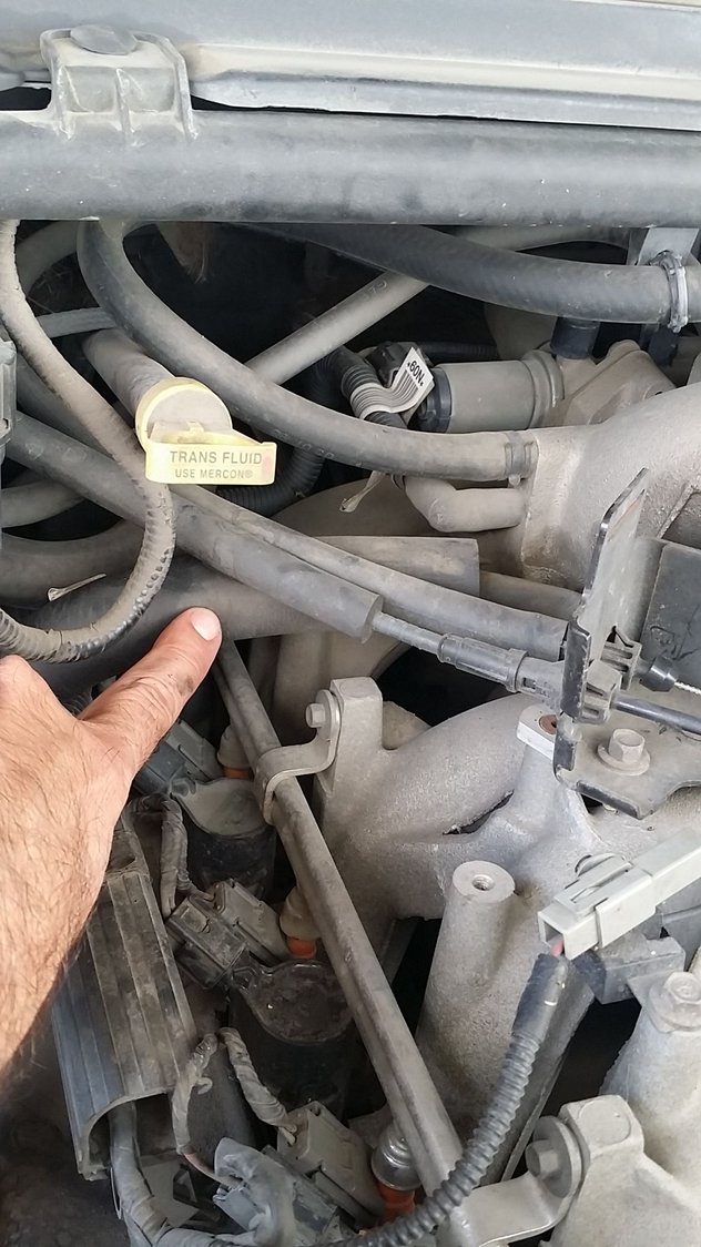

It was pretty constant since it was in a vacuum line however the noise was cause by loose parts floating around in the bad PCV valve. Once I located the noise I could thump it and it would stop for a minute. Below are a couple of pictures of the hose that contains the valve. I hope your "noise" is as easy to fix as mine was. Good luck. -sandon

Ya I know where it is. Thanks for the pics. I just swapped engines in my truck. It did it on my old engine too. I think I might have reused the PCV. Humm got to check that when I get home. Bet that's it. I've had them plug up before but never buzz
Is that a hole in the 90 bend hose there behind the spring in your picture? I had a hole appear in that hose just recently and had to replace it.

Wow, great catch on the possible hole the hose. My truck has been throwing P0174 and P0171 over and over lately. Been told is possibly a bad vacuum line. I sure hope it's something this simple. Thank you for pointing it out. -sandon

That hose is dealer only I think it was about $35.00 it's two pieces the 90 that comes out of the throttle body then there is a splice behind the cable bracket to the hose leading to the PCV
