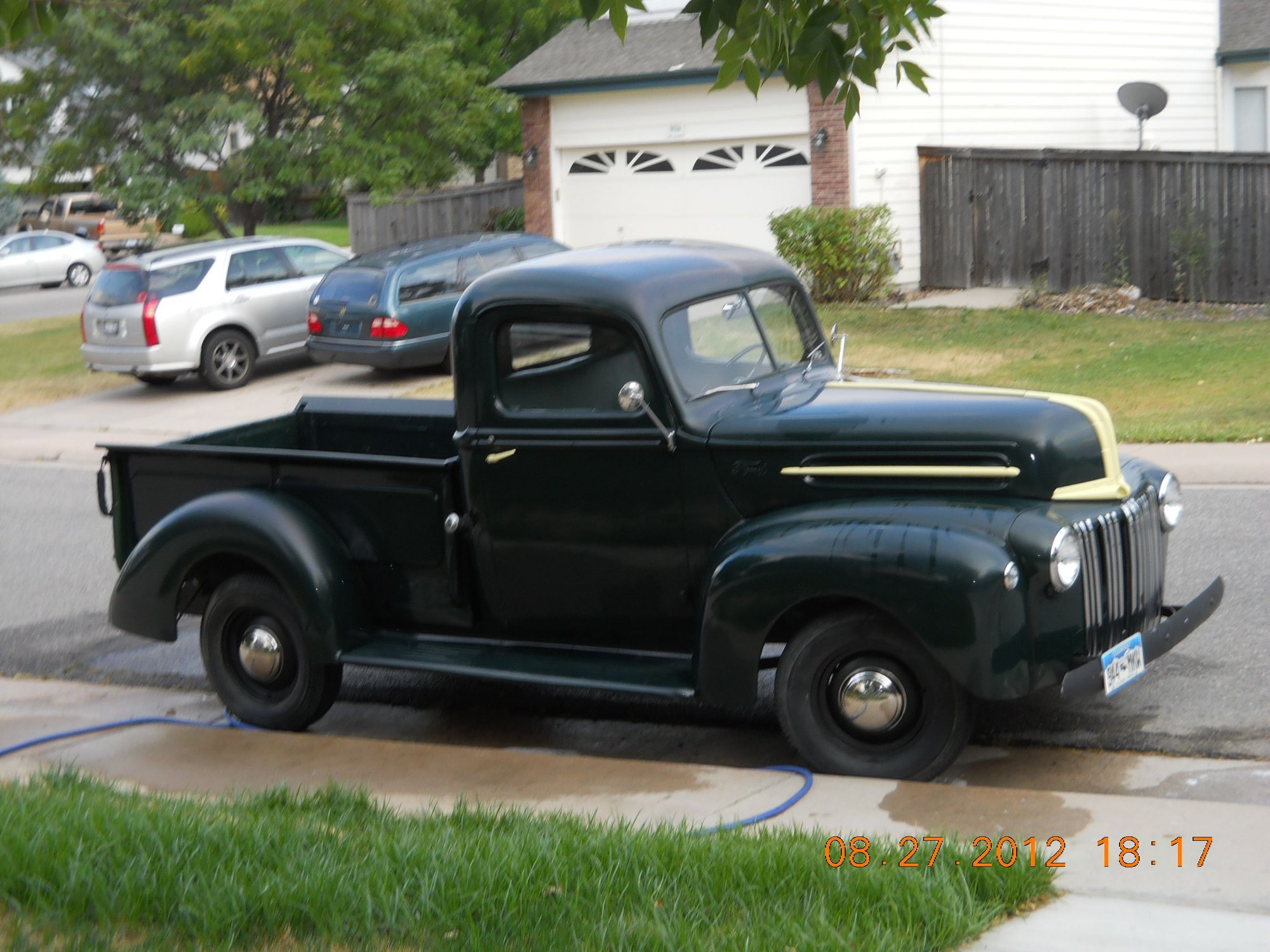

My '47 is still the original 6 volt system. It has not been a big deal except that the 6 volt batteries I have been getting do not last long (NAPA, industrial) so I have been thinking about converting to a 12 volt system. Now days the 6 volt turns over slow and sometimes it hard to start. So I am looking for some guidance on this.
I have had the truck for about 10 years now. My wife and I enjoy tooling around in it.
