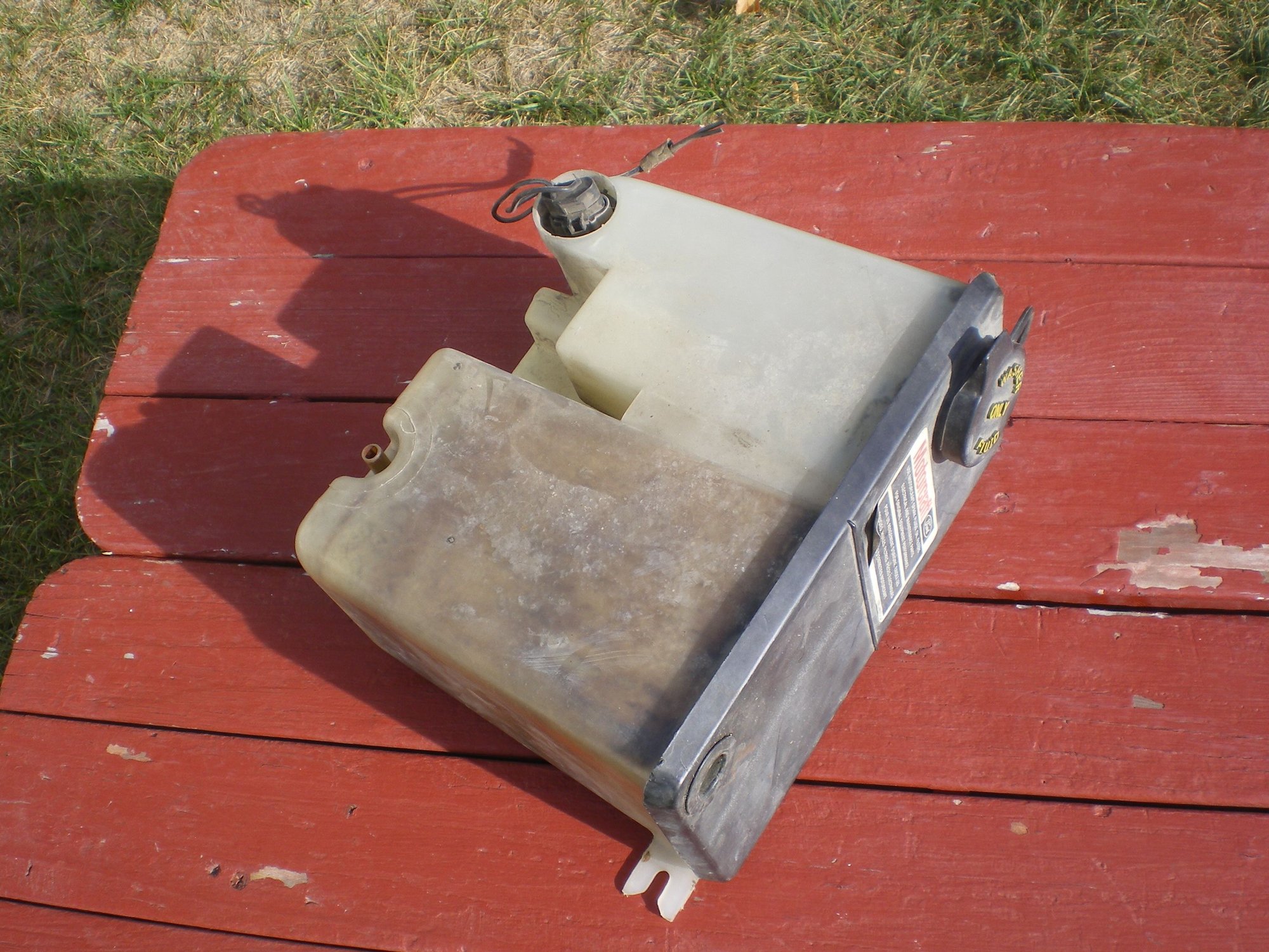

coolant reservoir
Looks like they changed the design in 1984 based on the part number.
Here are some photo of the stock one on my truck. I removed this when I added the tool box storage as it had on bolted on the side of it already.
https://www.ford-trucks.com/forums/8...th-photos.html
In the first photo you can see the 3 mounting points of the newer style.
I sent you a PM to see if you wanted this one.
Jim
Old Oct 20, 2014 | 10:40 AM
1986F150six's Avatar
1986F150six
Joined: Jul 2009
Posts: 6,477
Likes: 19
From: Sheffield, AL
The newer one [1985 & 1986?] has a press in plug which seals the antifreeze. The earlier ones had a loose opening through which the overflow hose passed. I believe the newer one is superior.
