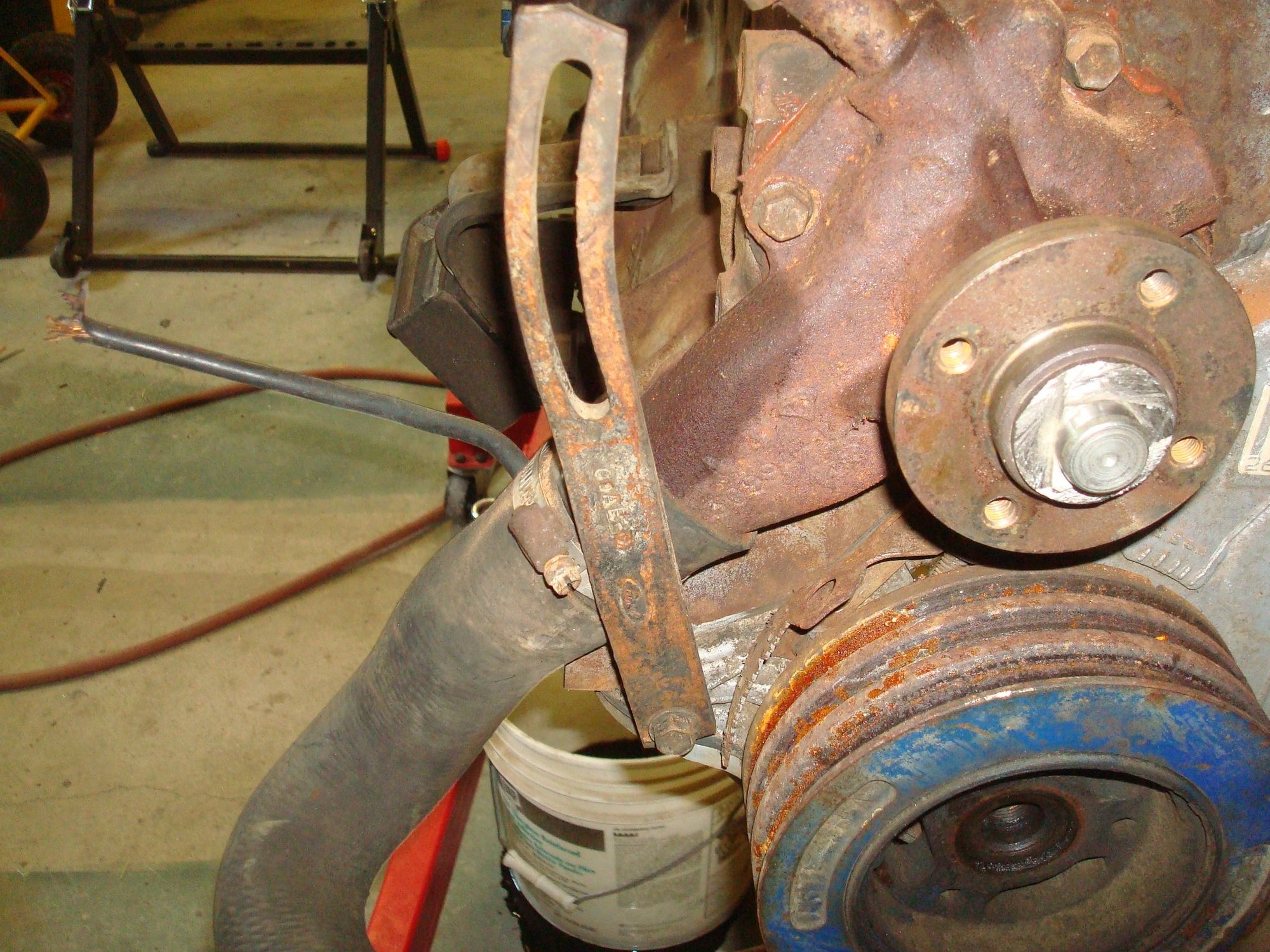

This is a pic from the engine, before the rebuild that shows the area I am talking about (the adjusting arm bolt through the timing cover)

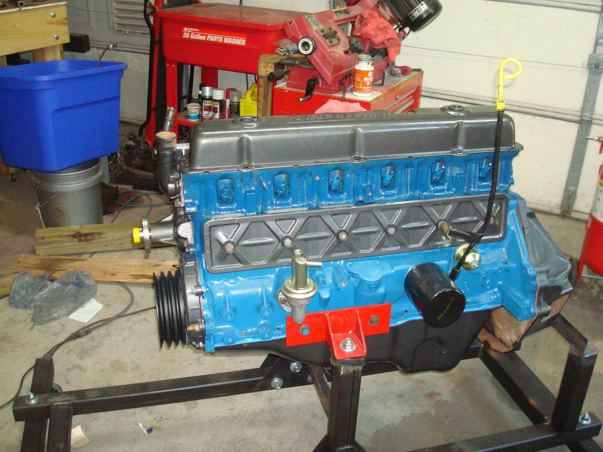

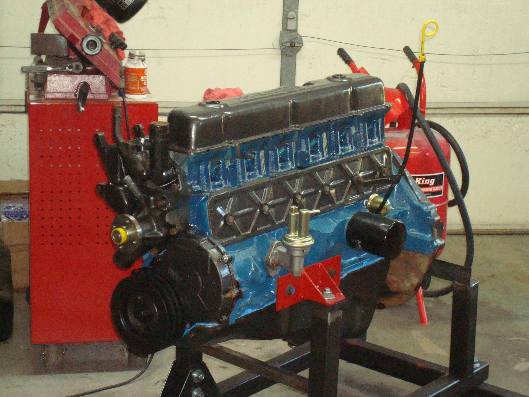

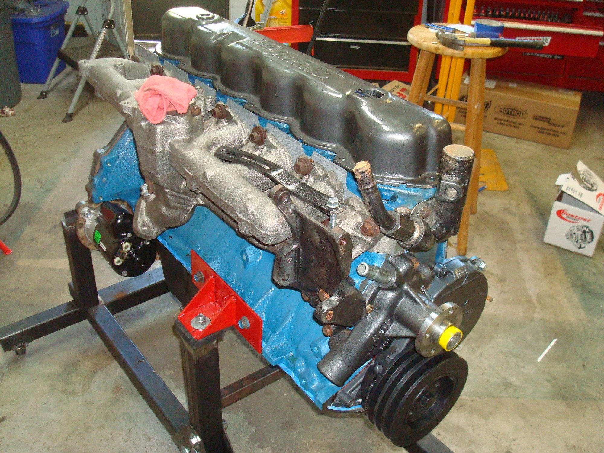

Current Pictures:

It appears that the bolt to mount the alternator is 3/8-16 x 4"
I found the bracket bolt..
Problem solved; on to the next one..
