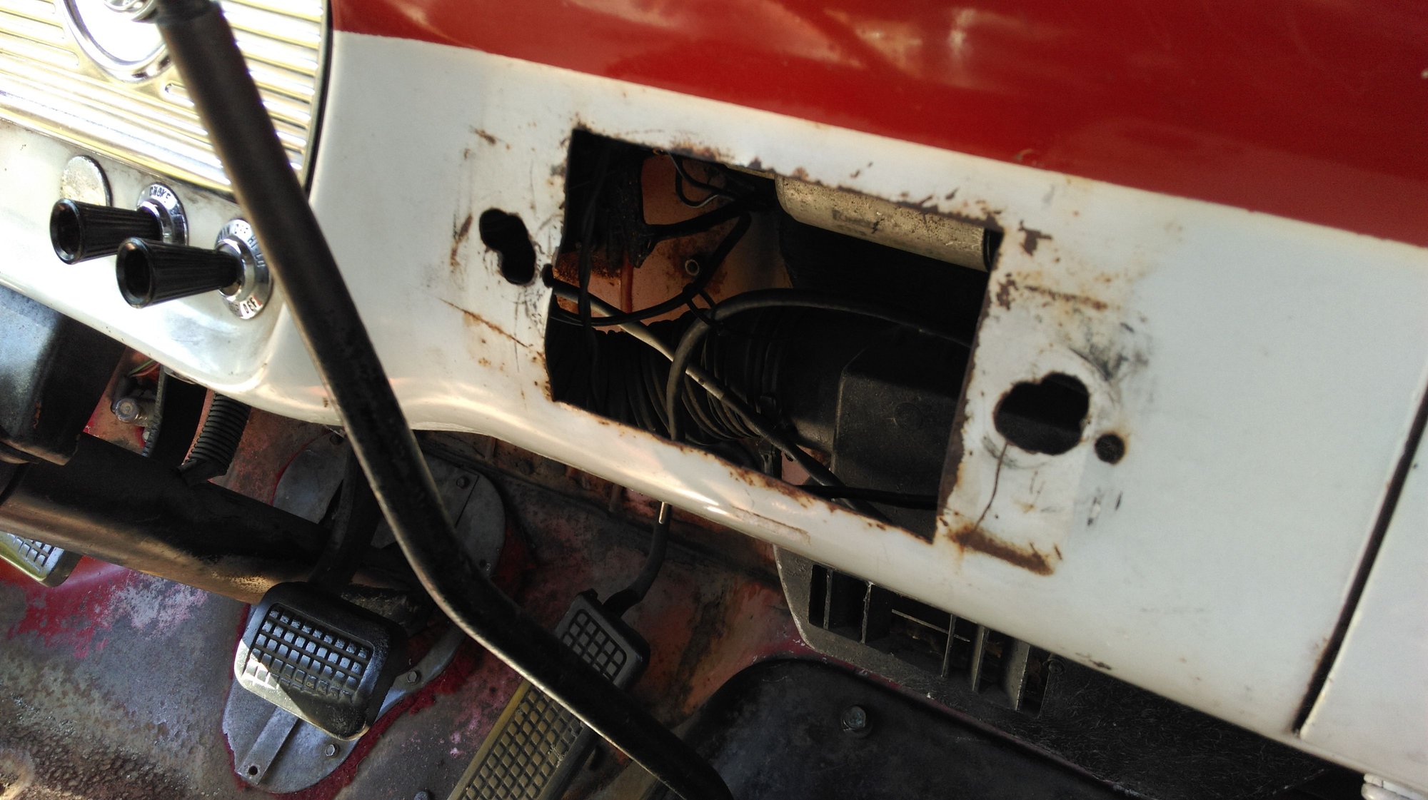

It looks like my 62 was originally equipped with a radio. There's an antenna mounted on the cowl and an original speaker/grill on the dash.
I would guess that someone installed an aftermarket stereo at some point in the past. Speaker holes were cut in the doors and some wiring run. All I have left now are the holes and this opening in the dash, which is 4 5/8" x 3":
Does anyone know if this is the original opening? The edges are pretty rough, but I've never seen an aftermarket stereo with these dimensions. (Maybe an old 8-Track went in there?)
If original, I'd love to find a replacement. If not, it would appear the my only option is to weld this opening up and start over. I dislike welding inside the cab--is the dash removable? A diagram in the manual under the Body Construction and Sealing section seems to indicate that it is, but I don't see a procedure for taking it out. Perhaps it's not possible without disassembly of the entire cab?

That's a pretty bad hack job, and certainly not original.

if your good with sheet metal you could fab one, I used a glove box door from my parts truck

Ouch. Time to cut out some steel and start welding it in. As for the dash gut feeling tells me it might be removable once you remove all the spot welds.

If (big if) you're going back with a stock radio and if (big if) it's the same dimensions as the 65-66 radio, I can cut you a patch panel from my '66 cab with the radio cutout as original. If you're going to block out the entire opening or go aftermarket, you can just use sheet metal.

No, absolutely not!
Someone butchered the dash by cutting a huge hole in it to install an aftermarket radio. This is a somewhat common occurrence on these trucks.
Look at this parts catalog pic and you'll see three small round holes in the dash. This is original...if the truck came with a radio.
If no radio was installed, there are no holes. Factory or dealer installed, the antenna (C3AZ-18813-C) is located on the right cowl panel, it's repro'd and is the same as 1961/64 Galaxie.
There are two different AM radios: 1961/63's have tubes, 1964 and later have transistors, this radio is the same as:
1964/66 F100/1100 / 1964/69 N/NT/T500/1100 / 1966/77 Bronco / 1967/69 F800/1000.
Bronco's use a different antenna and speaker.
So the small hole on the right and the partial on the left are original? Never would have guessed.

Actually if you look close at the pic, there are 5 small holes in the dash, the outer 2 holes are much smaller than the others as they are for the screws that retain the faceplate.
These 2 outer holes are present on your dash. The one at the left has been partially compromised by the huge hole a thoughtless former owner cut in the dash.

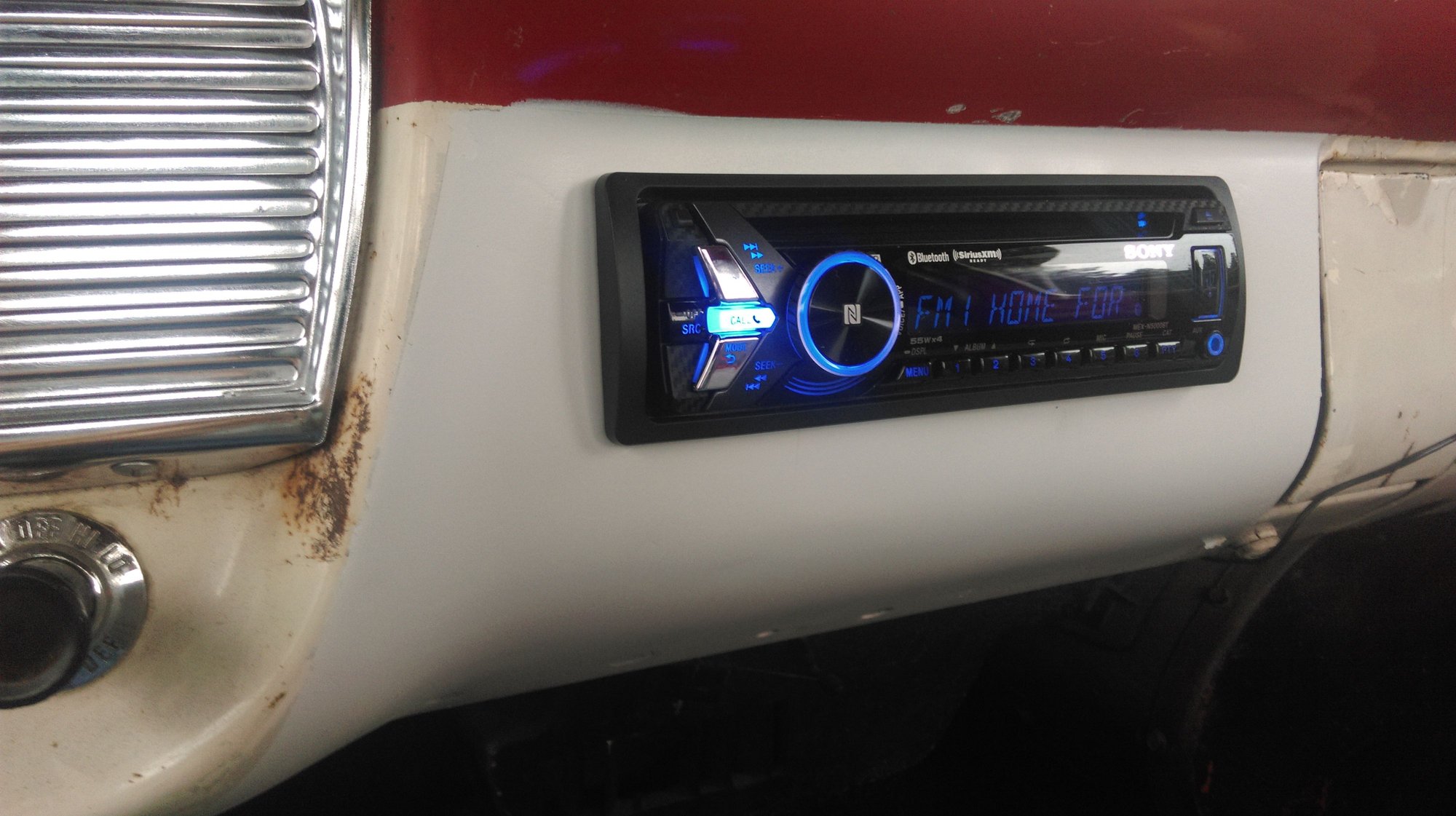

I saw a glove box door for sale on eBay for $50--too rich for me, so I rounded some 16 gauge sheet steel over a large wooden dowel, then welded it into the lower portion of this opening. I had to widen the hole to fit a modern system, but not by much
Still a hole in the dash, of course, but now a functional one. (The paint is temporary until I figure out which direction I want to go with it.)
Thanks for the help, everyone.

I'm not there with a magnifying glass to take a close look, but from here looking at your picture you seem to weld just fine. Looks fabulous to me!!
