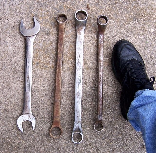

I have both standard and deep drop shanks so I can quickly swap them out if I have to tow a trailer with a different ball height. I also have a 1 1/8" box end wrench (and other large sizes) for loosening and tightening the bolts that hold the ball platform to the shank. That's my size 13 shoe in the pic.

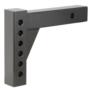

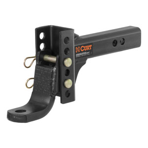

If you tow a lot of different trailers but only want one hitch, use something like these:
or
