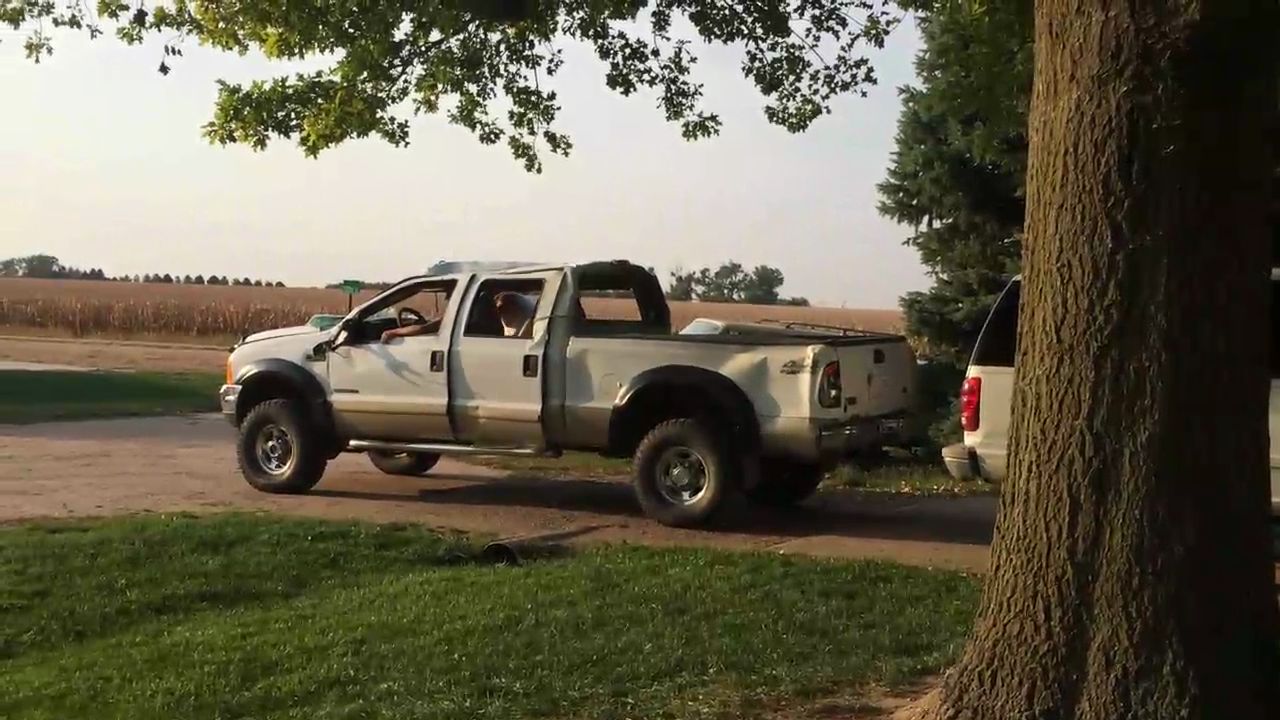

So I have acquired two trucks, both 2001, both f250, both crew cab shortbox, both lariat. One has the 7.3 and was rolled the other is 6.8 with a bad motor. I plan to use the cab from the 6.8 onto the frame of the 7.3, and then the best of the rest of the parts to make one truck.
Questions
Will I have to pull the cab wiring from the 7.3 truck to install in the 6.8 cab?
I assume use the gauge cluster from the 7.3 truck?
Anything people know about this swap I should look for or need a heads up on?
Seems like it should be a fairly simple ordeal, a little labor intensive but not to bad.

Old Sep 28, 2014 | 08:23 PM
husker77's Avatar
husker77
Joined: Nov 2010
Posts: 256
From: Glenvil Ne
Couple of videos out driving it around the block a little. It made a weird almost pop yesterday when I was revving it a little in neutral and then sounded a little different and started the grey smoke thing.
I got the receipt from the guy and it has a reman ford complete engine in it.
