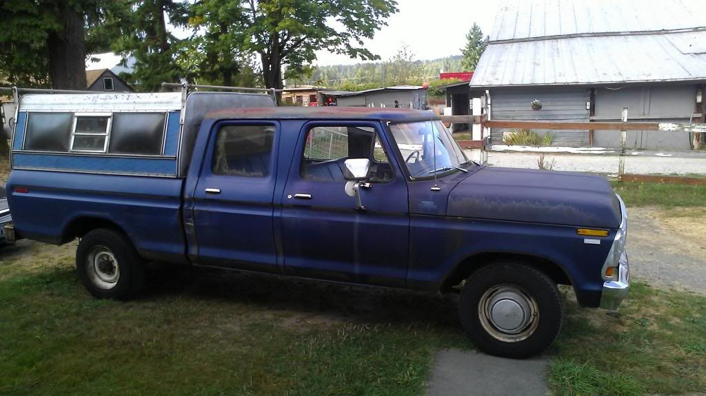

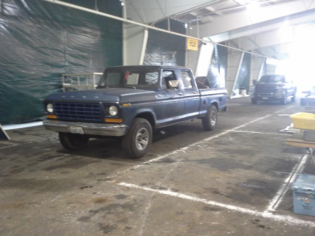

I will disclose off the bat that the "finished" product will take me years to achieve. Also the truck as it sits Chassis/Body is a bit of a test mule for modifications so when I build the new chassis I will only need to do things once, hopefully.
I stumbled upon a 78 CCSB 2WD when my girlfriend (Wife now) did not want me riding the Harley through another Washington winter. I gave only had $400 so I was searching for a real beater to get me by, she told me to look at more expensive vehicles and would loan me the money. I found this 78 Crew Cab, first I'd ever heard of a 73-79 CC though I've had multiple 73-79 trucks. It was listed on Craigslist for $800, we ran down to the tow yard in Seattle that was selling it and the gentleman put a brand new battery in it while we were in transit. I did a quick overview, test drove and handed the man his full asking price of $800.
Covered in green growth with it's fair share of paint fade and character, it was "love at first sight"
When I bought the truck it had a tired/leaking 351M, C6, Dana 60.

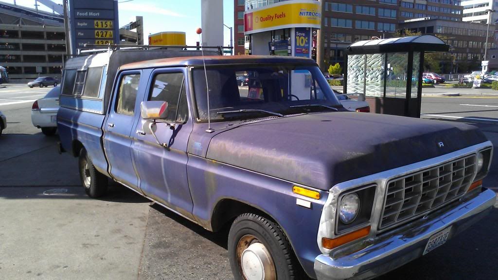

1st stop, gas station.
After the 45 mile drive home.

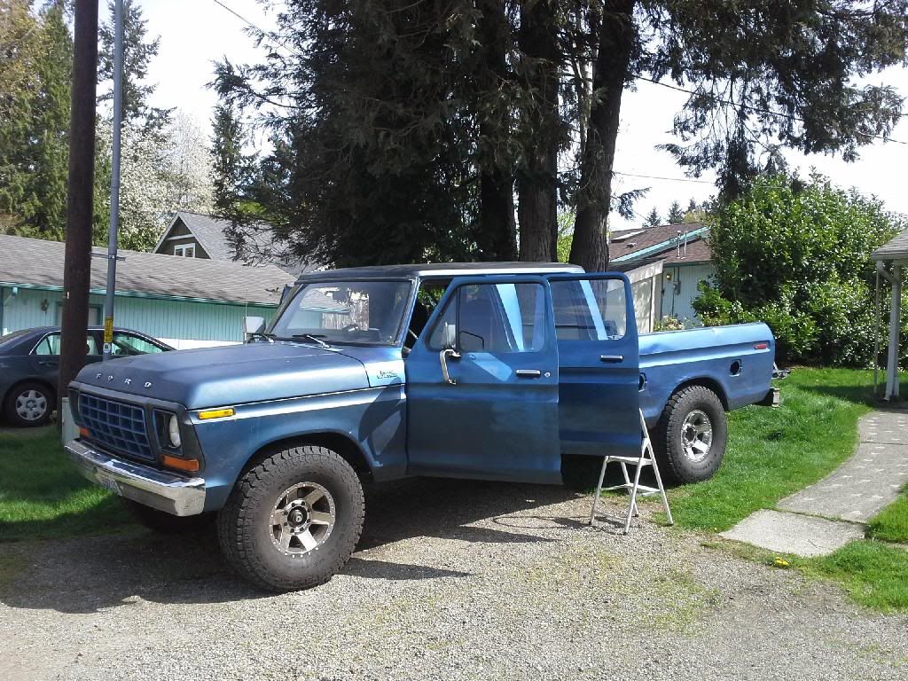

A few weeks later I had cash in hand and offered it to the girlfriend to repay the cost she had loaned me, she refused to take it as she was the reason I looked for a vehicle I couldn't afford. Starting to understand why I married her? haha
After a removing the ugly old canopy and giving the truck a desperately needed bath, some improvement.

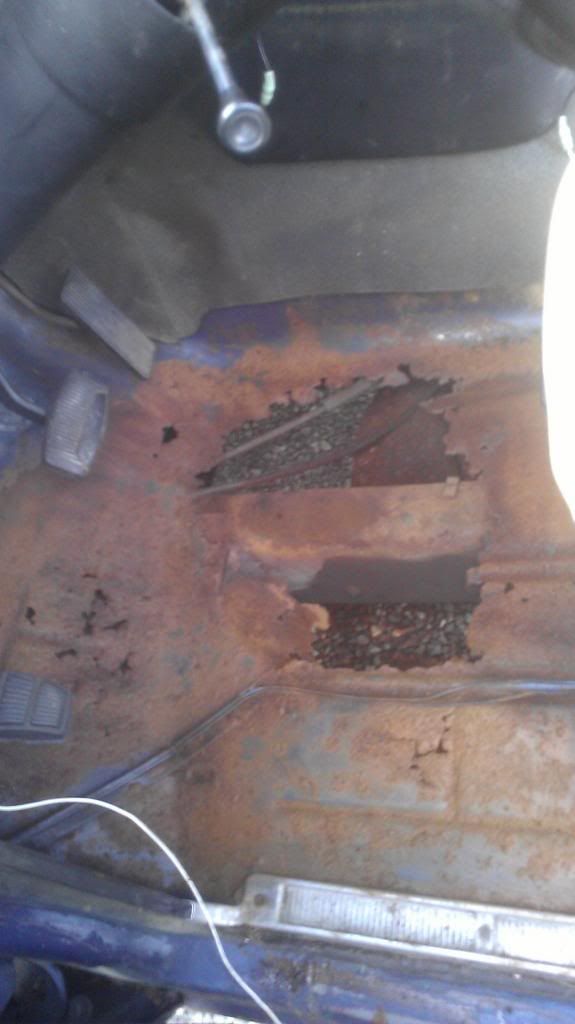

Removed the old vinyl floor cover to find the Flintsone option.

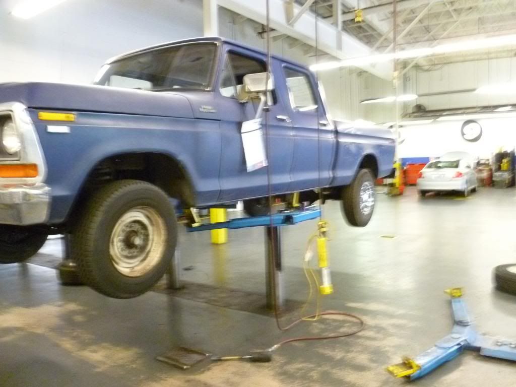

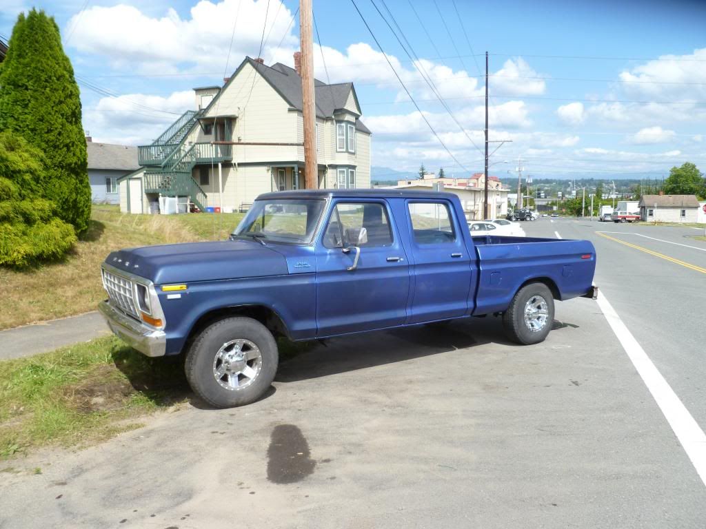

Having tires put on to get rid of the factory 16.5" wheels.
Shiny wheels and a few paint touch-ups.

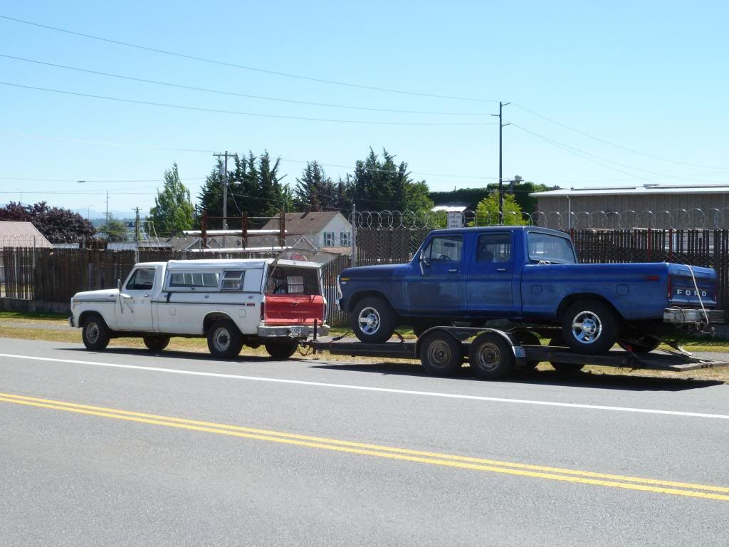

I searched and found my donor a mere 300 miles away for $500. A 1978 SCS (though not technically as last year of the SCS name was 1976) with a 460 C6 Dana 70, front and rear sway bars, dual batteries, dual tanks.
Had to take the doors/mirrors off to fit in my buddies trailer.
Back home after a long road trip.

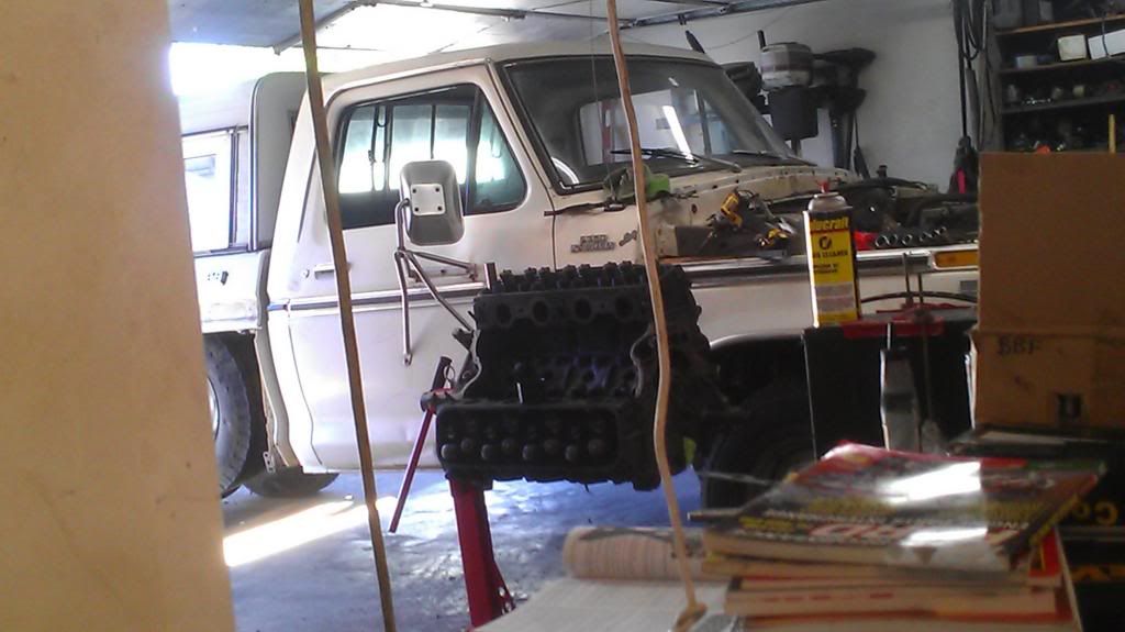

Ugly and neglected (is this a theme) but a solid motor.
I had already removed the engine from the crew in front of my house in preparation so I got the SCS ready for the short tow over to a friends garage.
Loaded up and ready to go, the irony of the Parts truck towing the Daily Driver. haha
That was probably one of the most terrifying tows of my life! The carburetor was messed up, tires a little low and I found out on bridge that the U-bolts in the rear of the parts truck were "snug" at best. After having to replace my underwear on the roadside I finished the tow at a snails pace.

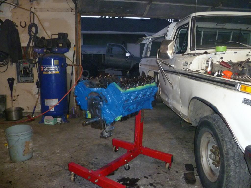

Motor out and stripped down to the short block.

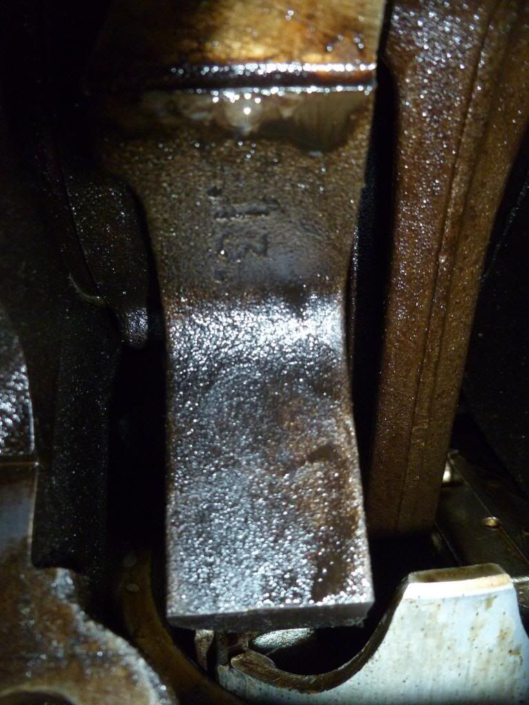

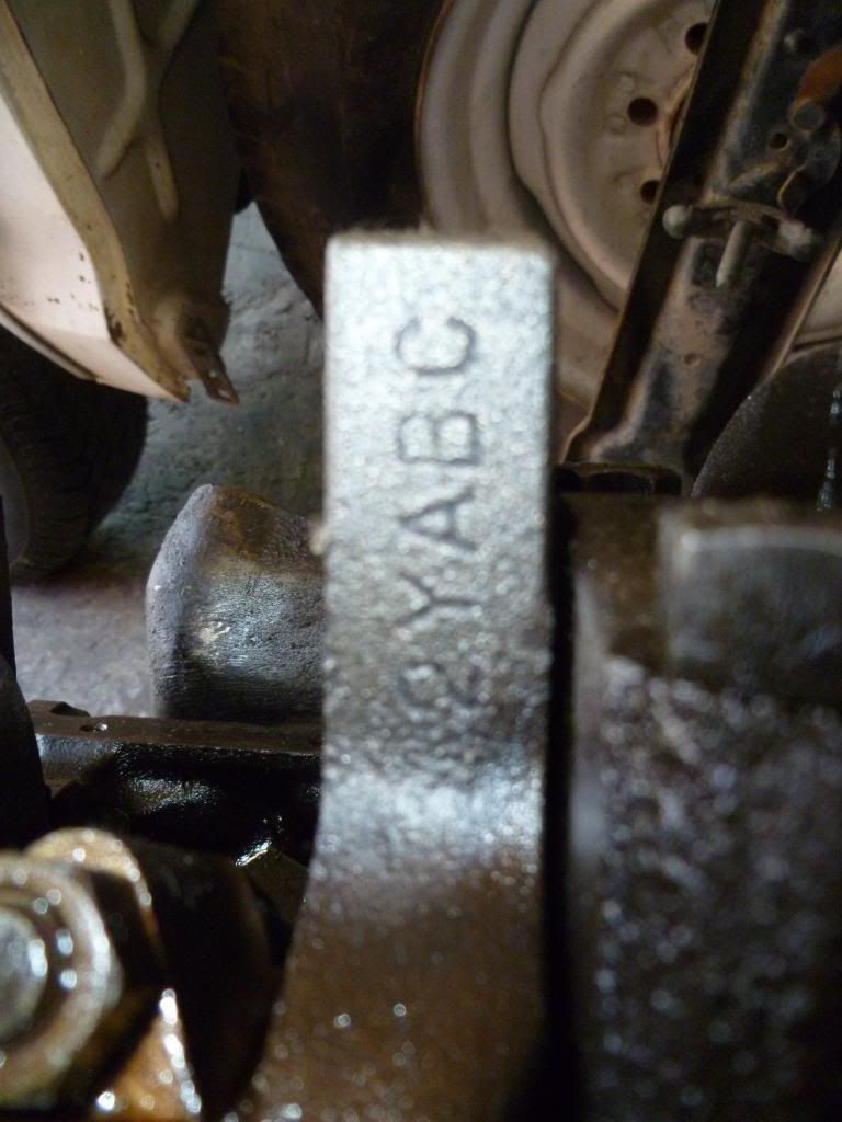

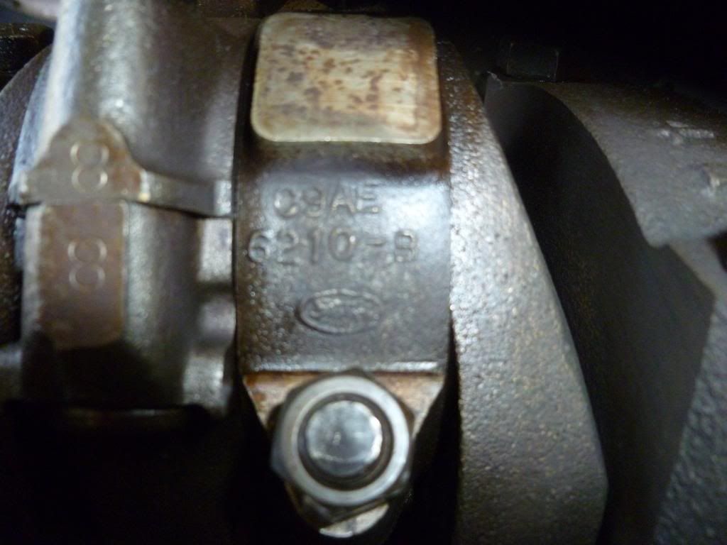

Rods
Crank
Brinel test, I believe.
Cleaned and reassembling.
Poof can makeover.
Here was my mistake, I tried to build a "cool" motor cheaply. I purchased some Procomp Electronics products that proved to be expensive paperweights.

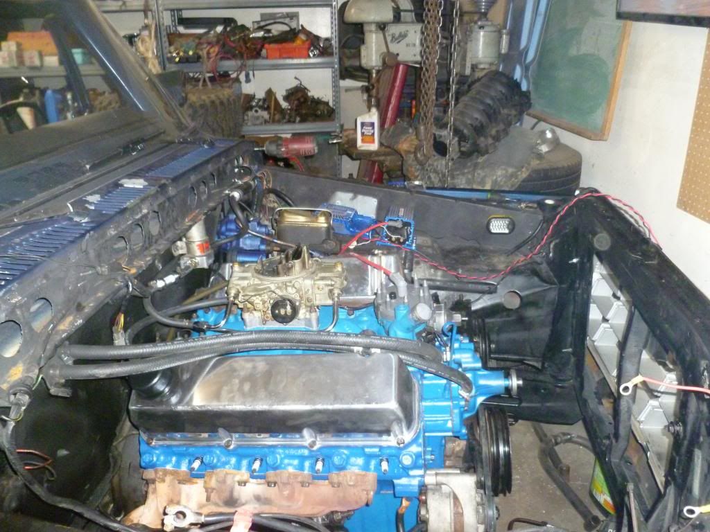

All clean under the hood with the 460 in her new home.

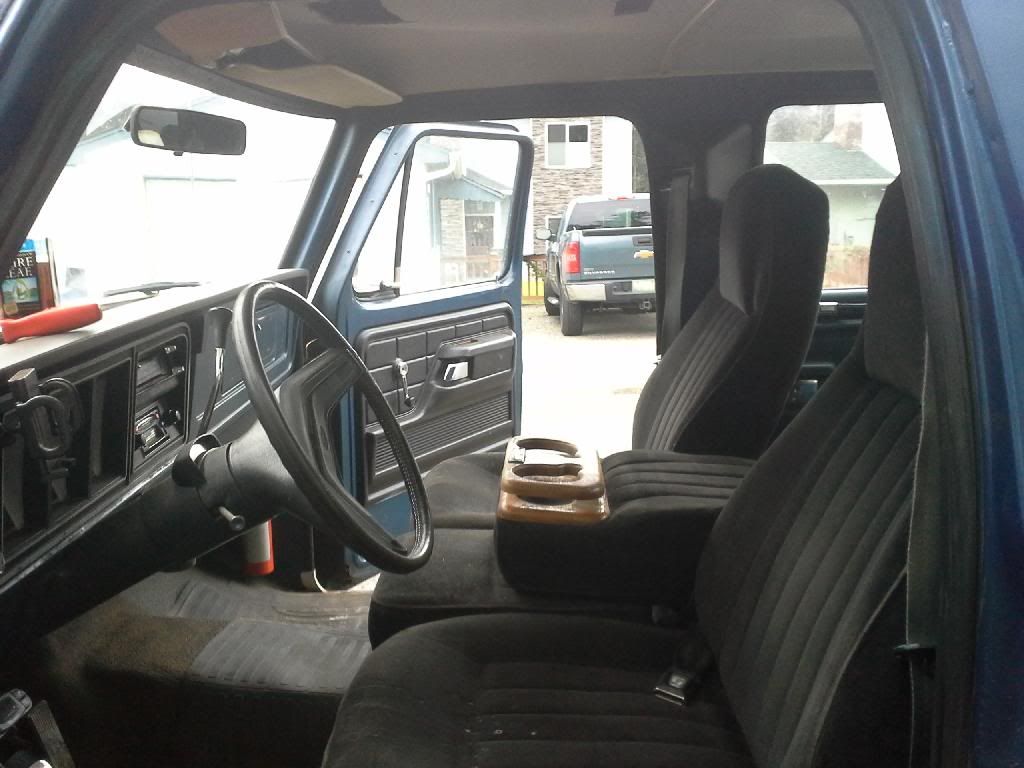

Found these sweet Kustomfit brand seats at the junkyard for $40.

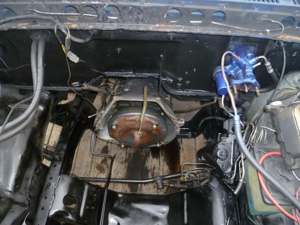

Looks a little TOO tight in there.
Due to the cool brake setup it would not clear the fuel tank, so I removed the tank, keep it simple right.
Other than the tank. I took the crossmember to frame pads off and mounted the crossmember on the lower frame rail. I rolled the cab seam up to clear the huge bellhousing on the ZF. Added clutch pedal assembly. Cut a hole for the shifter. Used the ZF mount on my original crossmember. Due to my ZF having a 1410 U-joint flange I got a 1410 flange for the Econoline rear I had and used a 2000 Superduty driveline, it required me moving the Carrier bracket mount 3".
You can kinda see my Hydraulic clutch master cylinder in there on the other side of the Hydroboost.

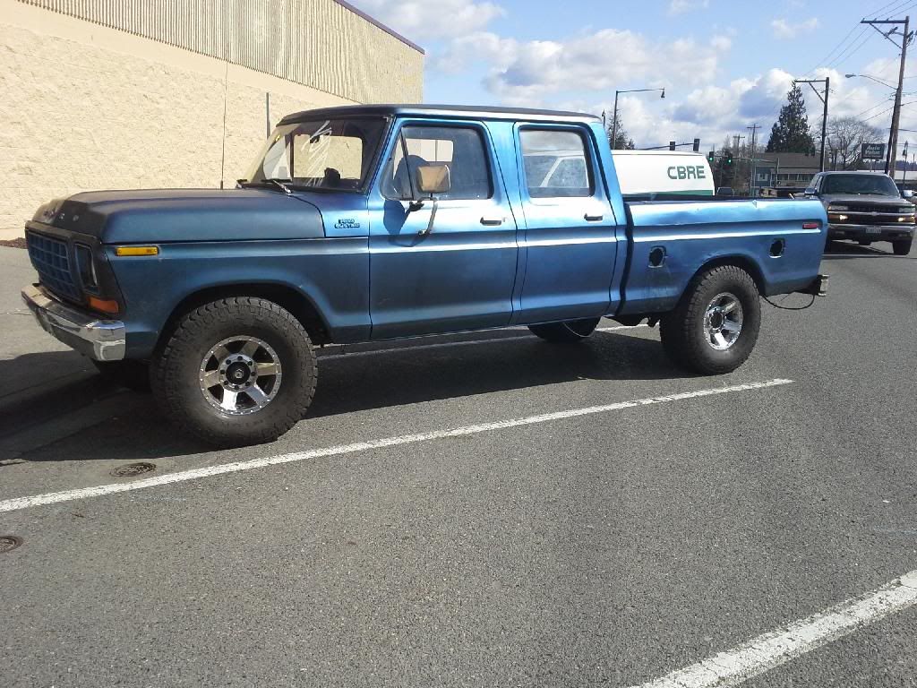

I also lifted the truck a little with a shackle flip in the rear and some spacers in the front.

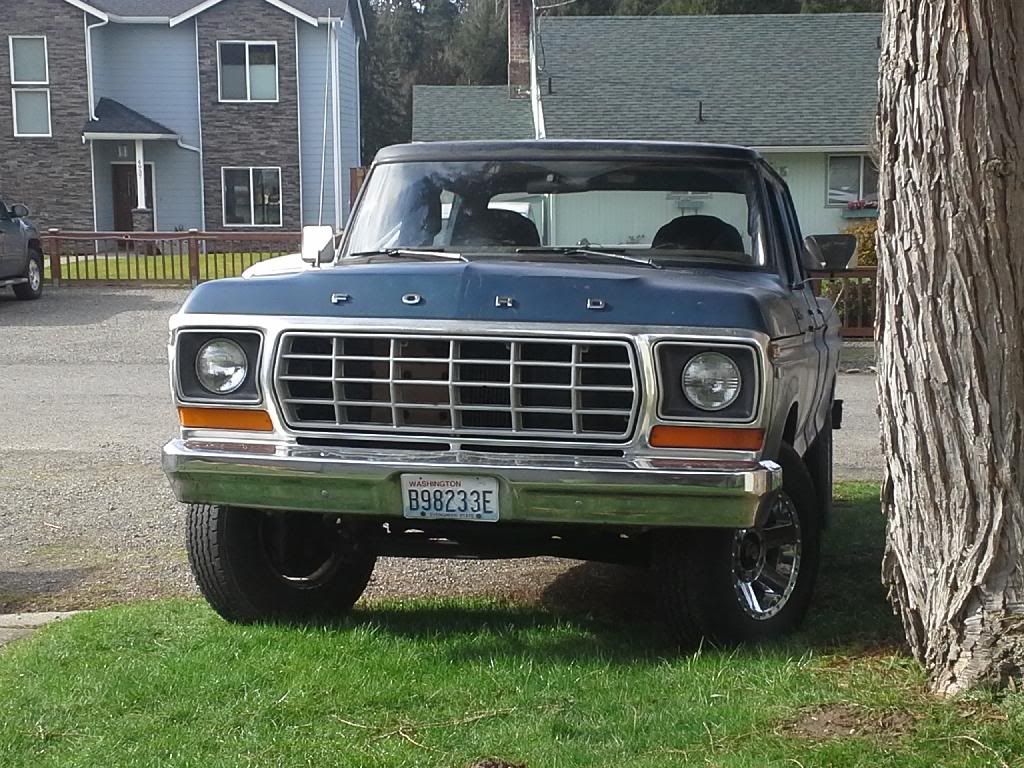

A few months later I decided I was bored with the grill. So from this.
To this.

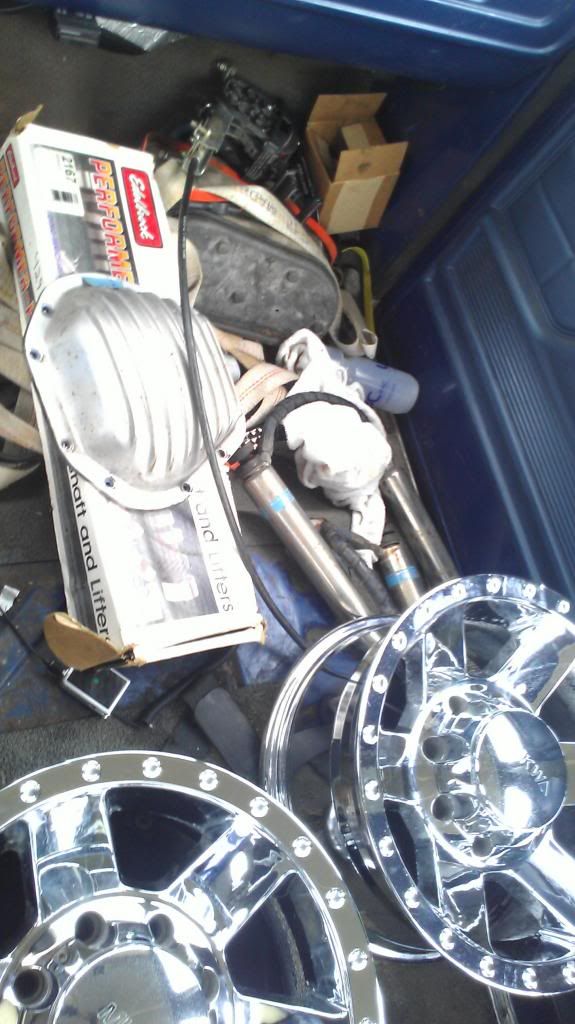

I should also say that other than consumables like fluids, filters gaskets, paint etc that EVERYTHING is source through junkyard, craigslist, friends and hustling. To date I have under $2,000 into the truck.

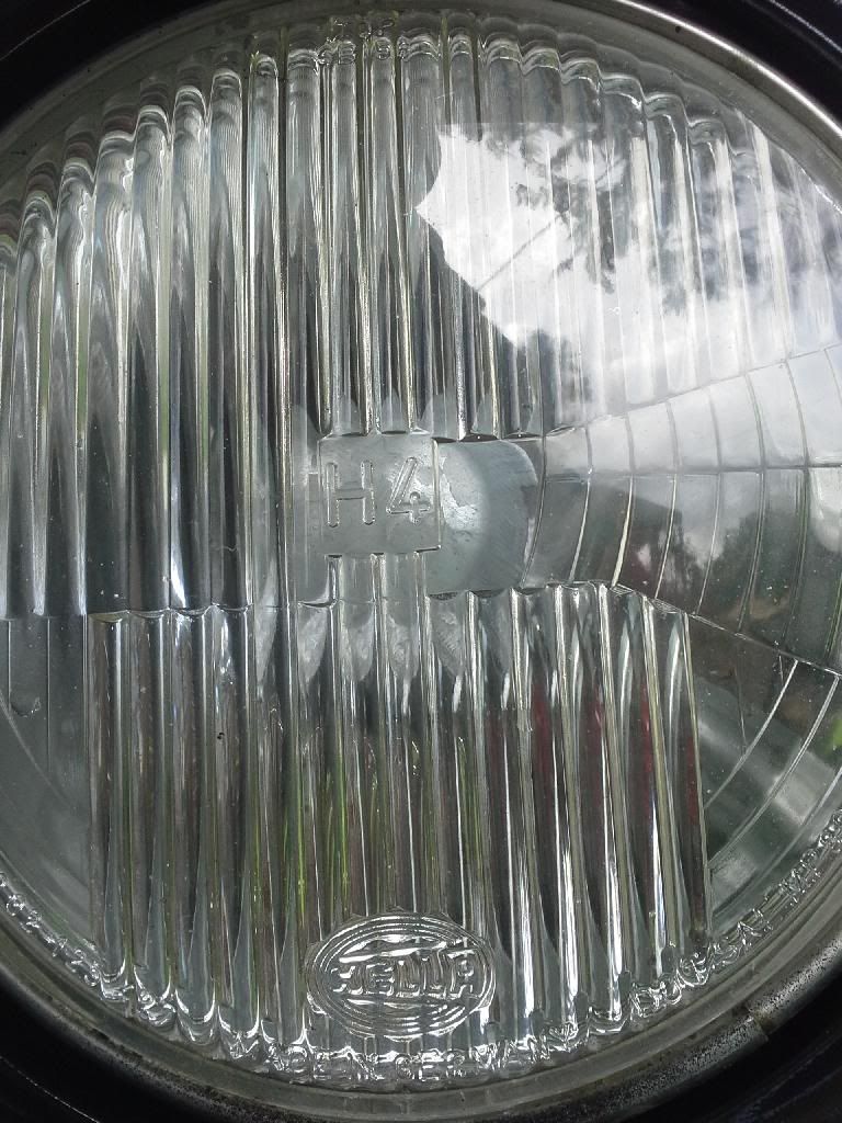

Forgot that when I did the grill I also installed some Hella H4 conversion lights that have nice glass lenses and steel backs, paid $10 at JY for them.
Another swap meet, my alignment after the lift looks horrible in this picture but the back of the truck is loaded down.
If you noticed in the back of the truck were new tires, I got a nice set of 315-75-16 Kumho tires with 90% tread for $200 at the swap.

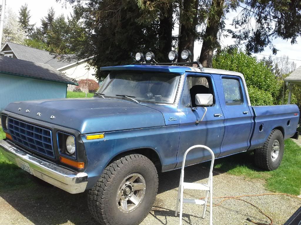

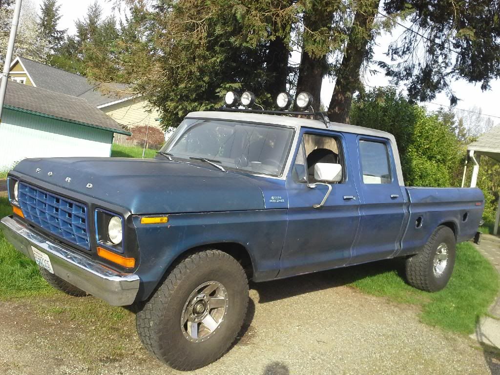

I them mounted the KC light bar I got from another Ford Nut.

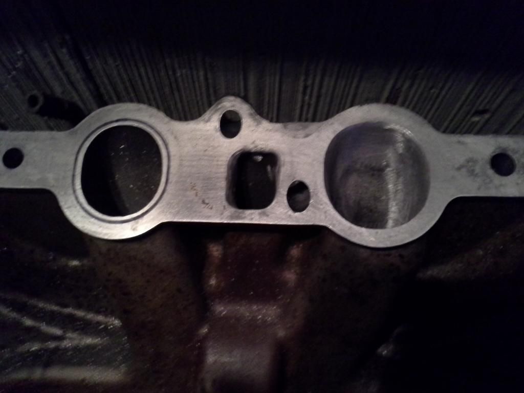

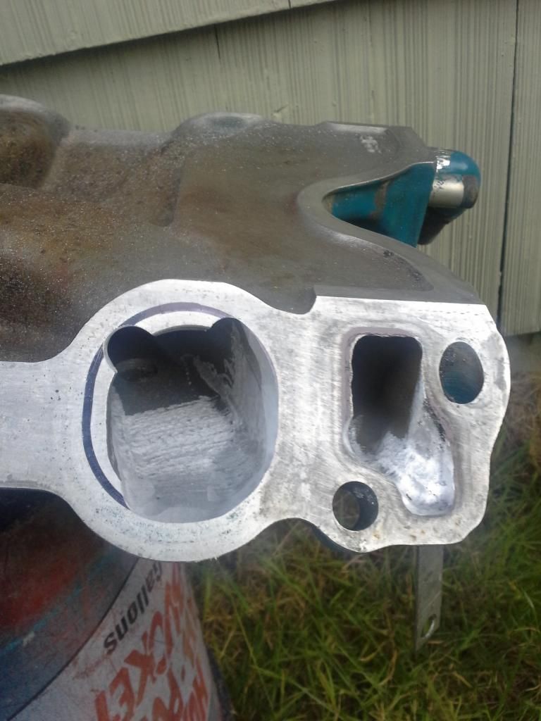

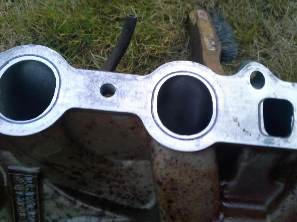

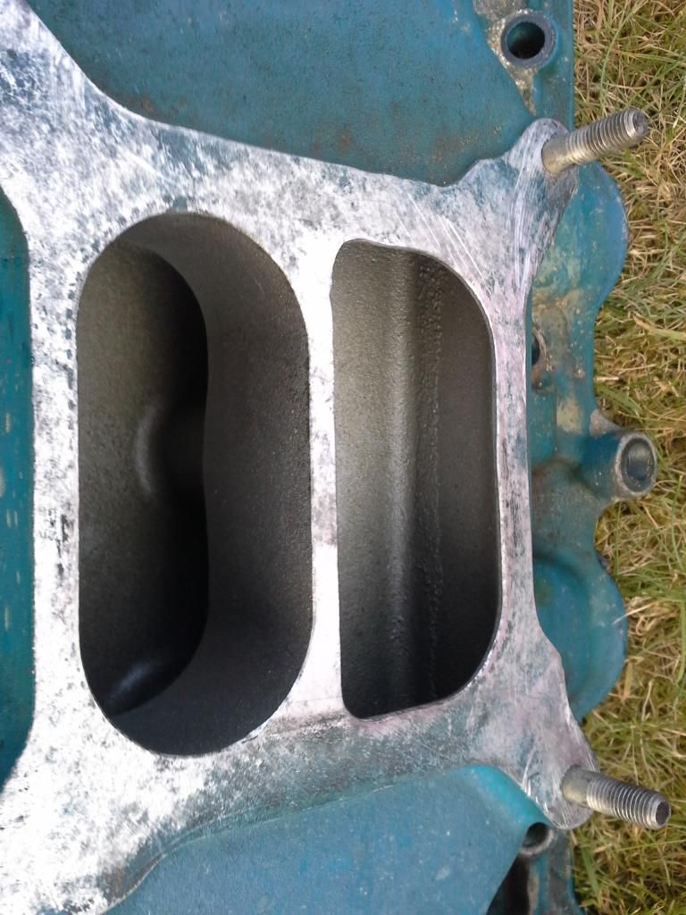

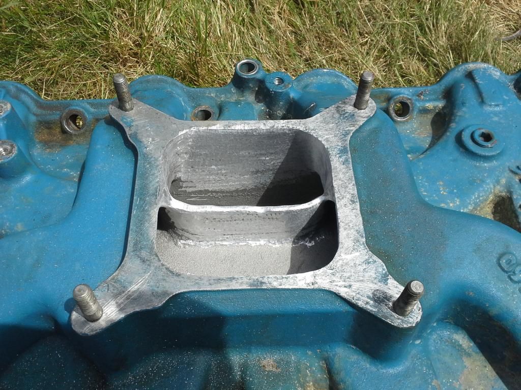

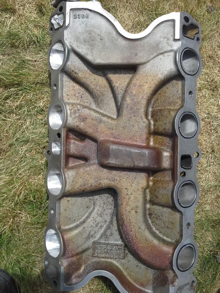

My engine developed an intake leak so I figured I may as well port it to see how much of a gain I can get.
Comparing the gasket to intake.

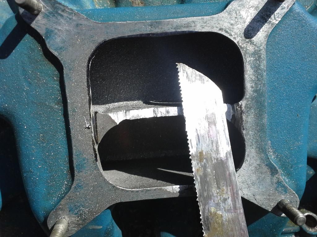

The plenum before I started.
All marked out in an "eat the line" fashion.
Getting an idea with 1 port "roughed in".
Initial cut on plenum. Cutting down the divider 1/2" is to move the power band up in the RPM range slightly.
One side ported one side not.
Plenum roughed before final smoothing.
In process of porting a runner and the water crossover port.

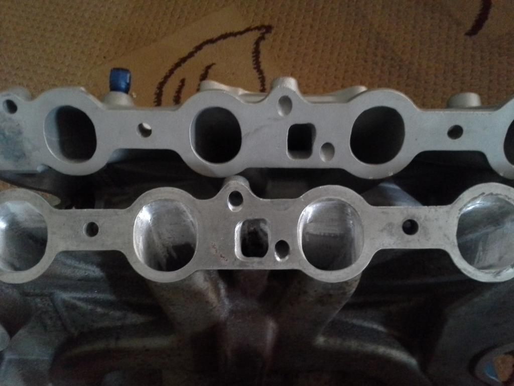

Done and compared to a "as cast" Edelbrock Performer intake.
Even though this did move my power band up a little ways I noticed a considerable gain in power throughout the entire operating range of the engine. I am very pleased for a modification that cost me nothing more than what I would have spent on gaskets anyways. Due to a very small and wore out old compressor this took me about 10 hours of porting, I have done similar work with a large compressor and it took about 6.5 hours.
