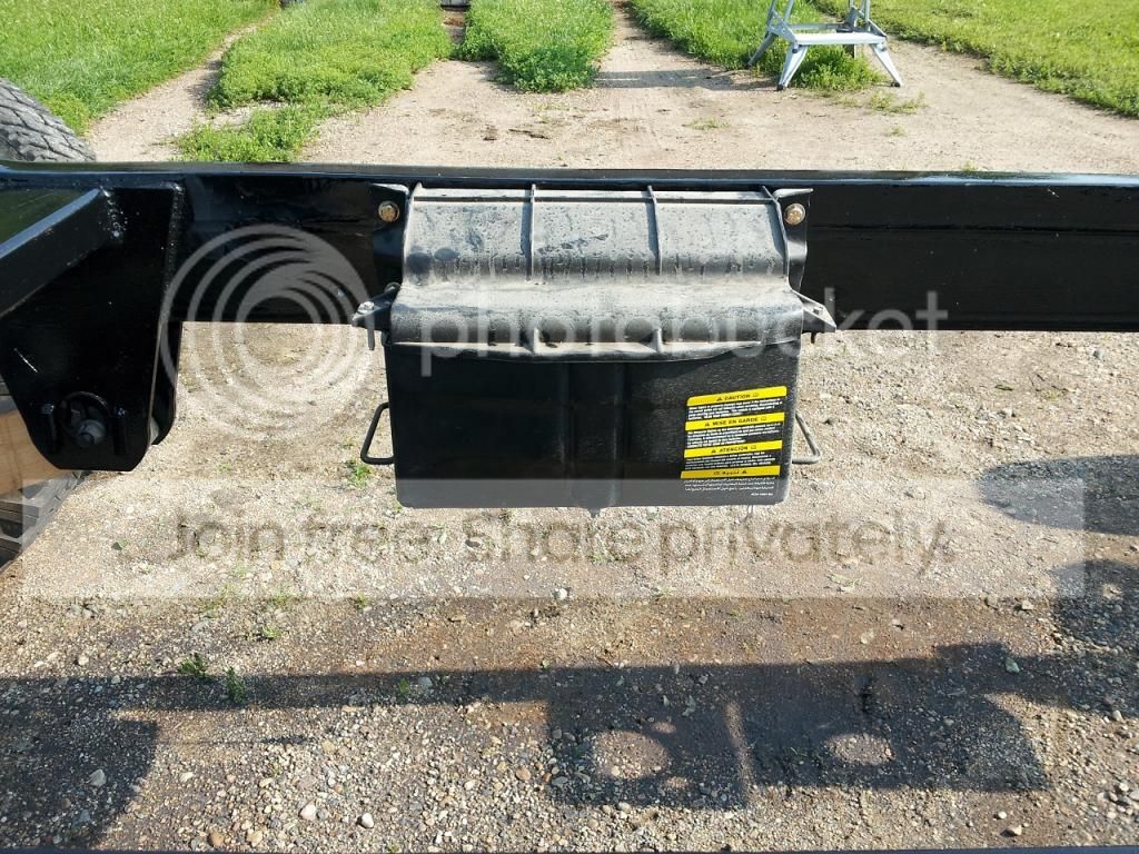

I'm using a factory drop down box from an Ford Econoline box truck. Its held on by four bolts and two cables. Just have to remove one bolt and loosen the other three. Slide it sideways and it comes down.
