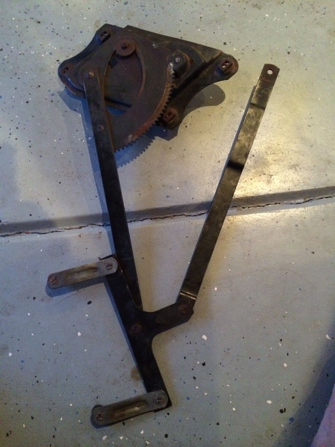

Finally got the regulator assembly out and it's definitely broken. Can one of you guys take a look and confirm for me this thing cannot be repaired? One of the two control arms has come apart. I
t appears to me there is no fix for this and I'll need to find a replacement for the whole assembly.

Easy fix for a welder... put the arm on the rivet, put a washer over it, and weld the washer to the rivet.

If you don't go with Ross's suggestion, I have several for sale.
