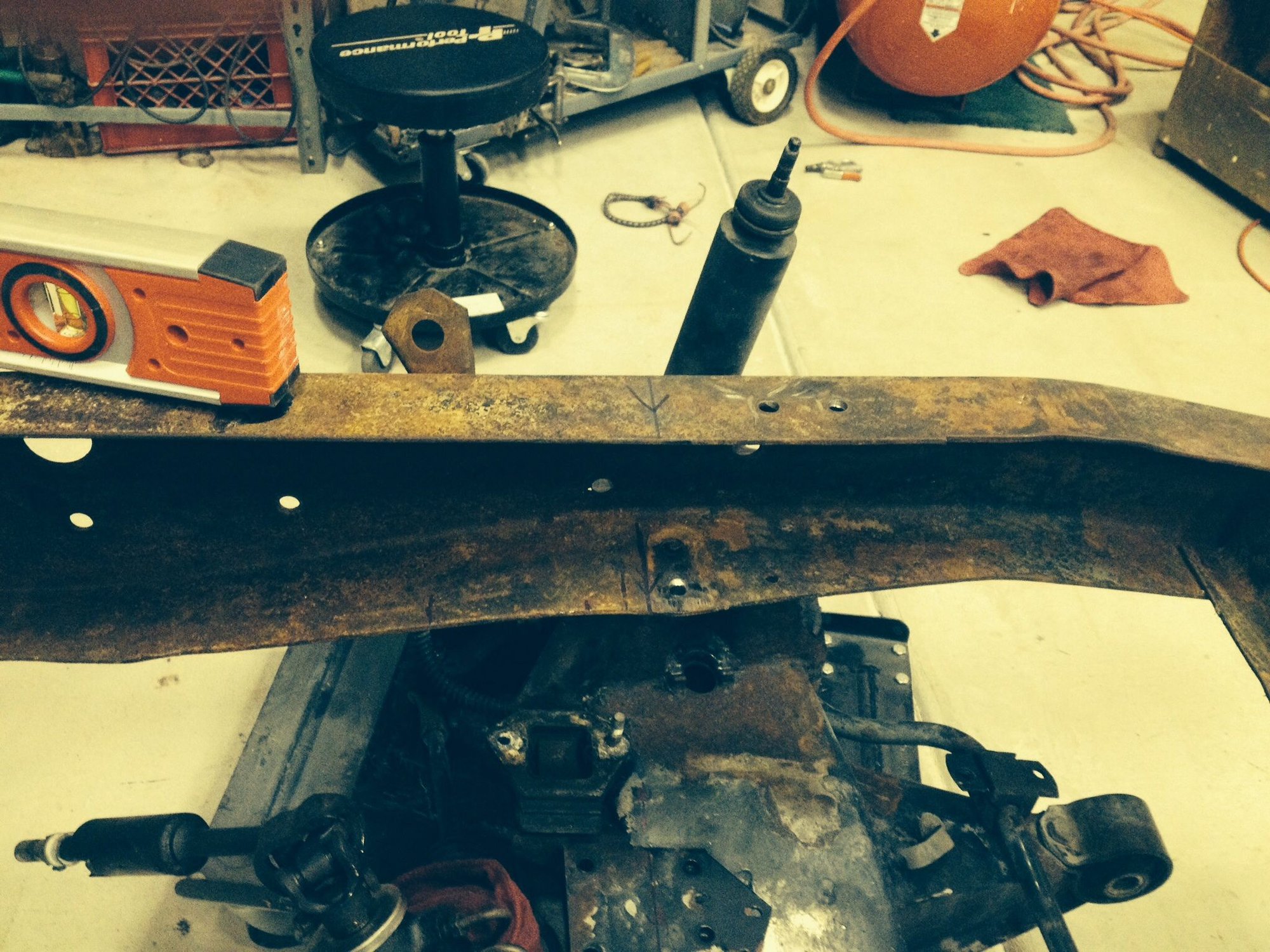

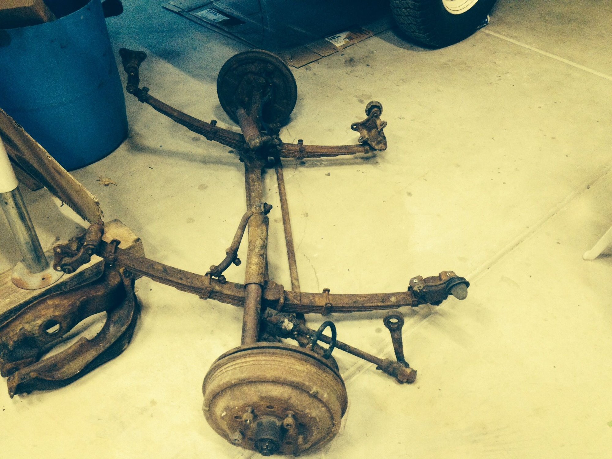

I haven't been able to do much on the f1 for a week or so but got the jag on the trailer so that made some room in the shop so I took the axle off.
did a little lay out for the ifs my measurements are very close to Dave's (drptop70ss)about a 1/2" back from the snubber hole is the center. Don't know which way to level the frame at the ifs mount could shim but I the frame will be thick at that point(over3/4"). Maybe cut and weld I saw 48steel used that method
