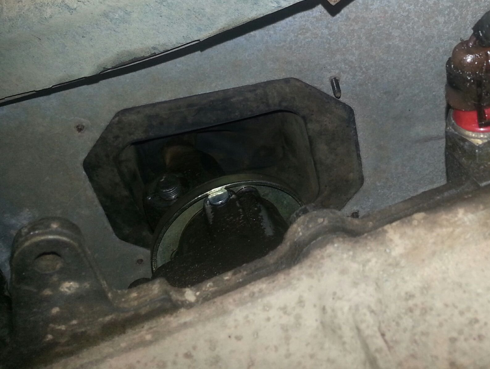

I put in a shifter rebuild kit. The old pins did not appear worn at all, and were in there snug. The pins that came with the new kit fit very loose. I've now noticed and odd radial play in the shifter was not there before.
Look what I see underneath today, the pin has backed out! Im going to re-use the old pins.
