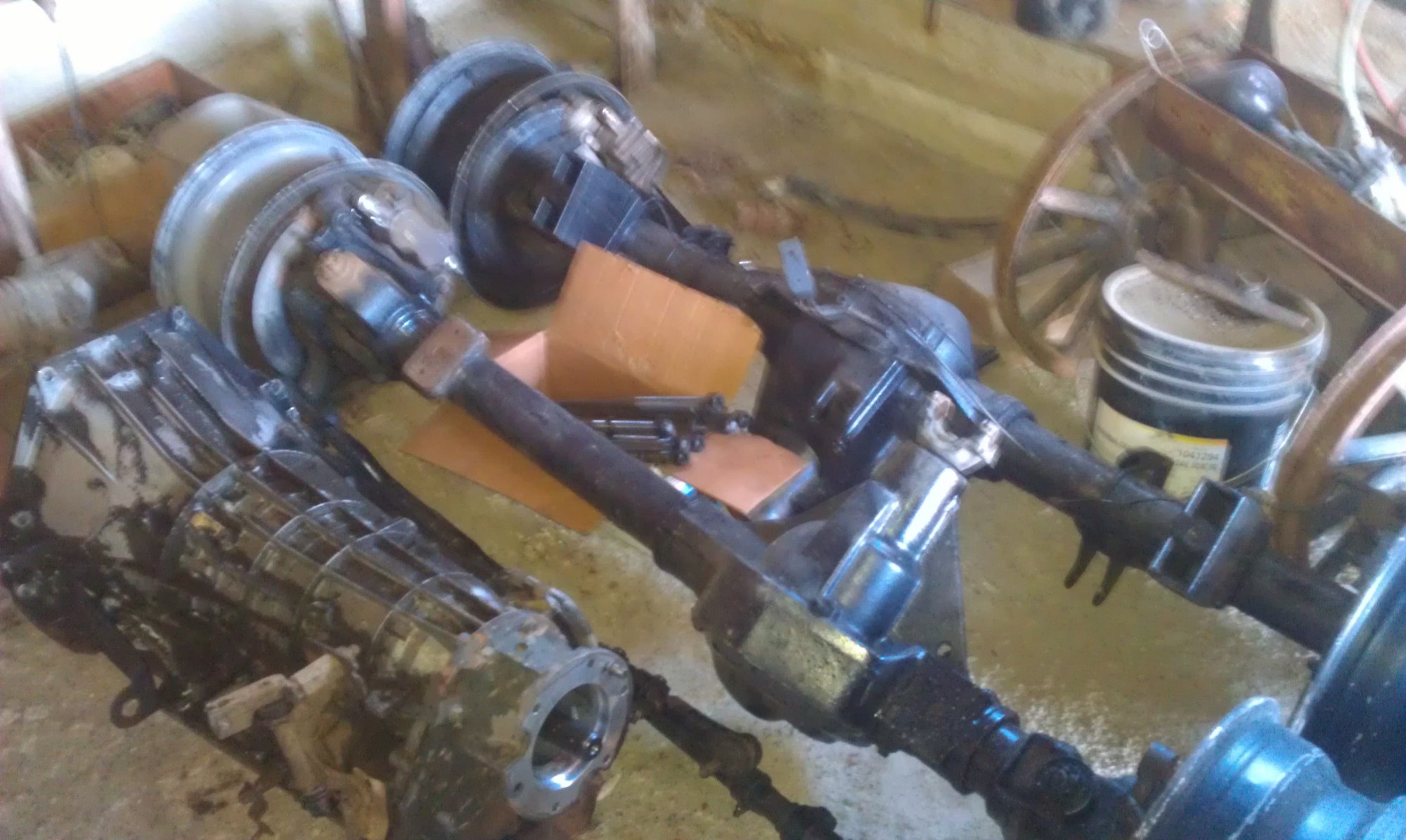

The pickup sat too low for my taste, i didnt want "lifted" but i wanted more ground clearance and taller tires. I still need to be able to pull a trailer, and TTBs are not known for thier ride. D60s are expensive, also, my open rear diff sucks, and the brakes on it suck. Furthermore, its always bothered me that the rear is 3-4" narrower than the front. So lets kill... well all those birds with $1100. Precision Metal Fab 2.25" rear shackle kit fit the bill, my particular kit was built to use super duty springs and axles. I picked up a set of axles from a 2002 F250, D50 mono front, 10.5" sterling rear. Got a pretty good deal on them as the gears dont match. The rear is brand new 4.10 LS with new calipers. The front has 3.73 gears, needs at least upper balljoints, but has all new brake hardware as well. Got a set of X-code springs from the JY and stuffed everything in. The benefit (probably the only one) of having the D50 mono, is i can regear it with my TTB gears saving a good wad of cash. On top of the axles, the guy pitched in all sorts of goodies including lift blocks, add-a-leafs, several U-bolts, a steering stabilizer and 3 poorly painted SD wheels.
** Finding pics from the swap will update when found.
Finished.
I need to shorten the rear block 1-2", it sits slightly taller than i wanted ideally (about 4" total) but it did and does everything i wanted. Stops AMAZINGLY well with the stock master / booster. Ride is sooooo much better... it still rides like a pickup with the X-codes, but 10x better than the TTB.

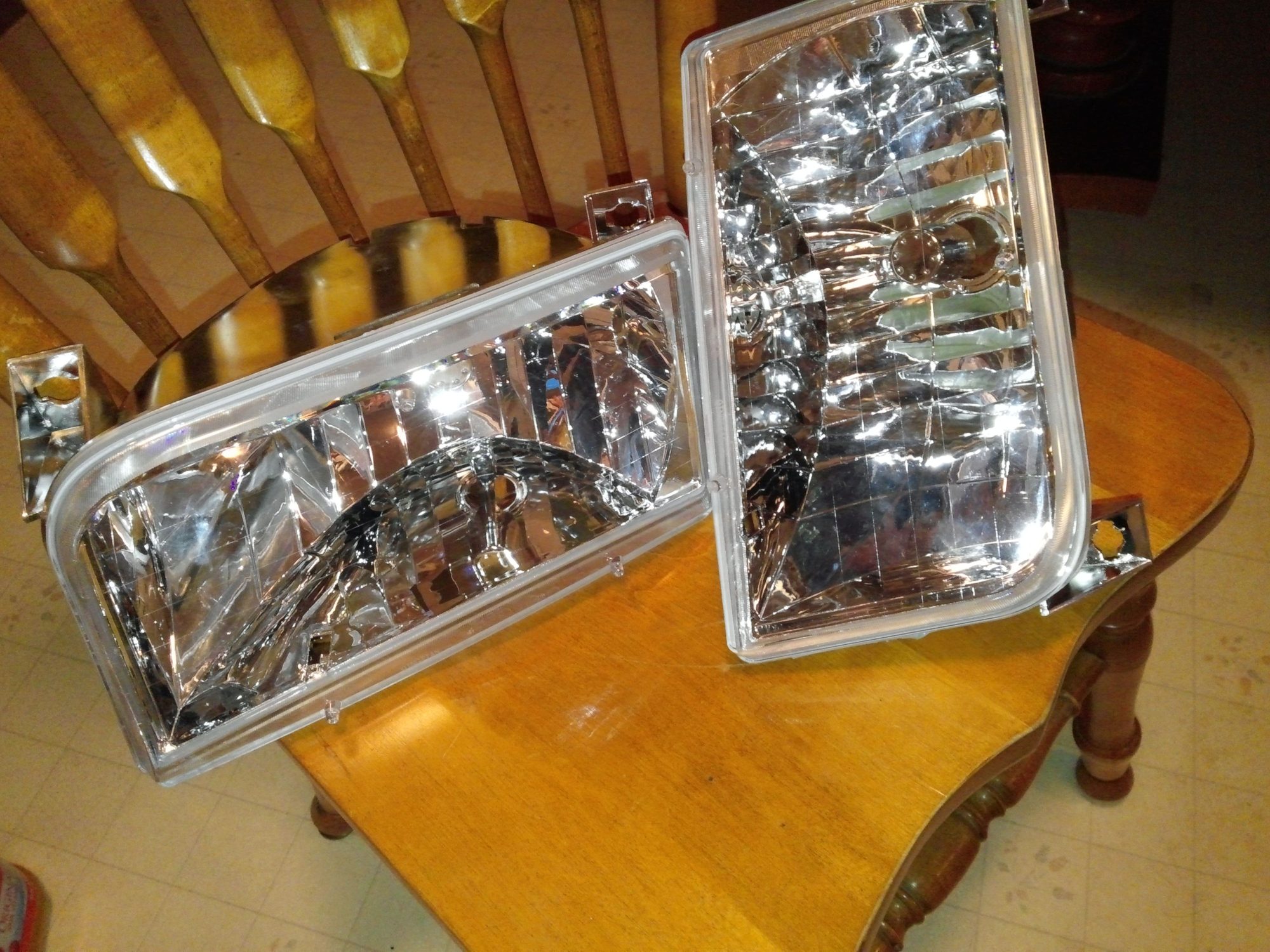

Most recent, i just got new headlights. Im not 100% if i like them yet, but at least i can see down the road more than 50'. As mentioned early, chinese junk sucks, and these are no exception. The passenger side sticks out about 1" on the bottom once it was adjusted, and fogs up inside when it gets wet. Hoping its just a bad housing and expecting warranty to cover it.

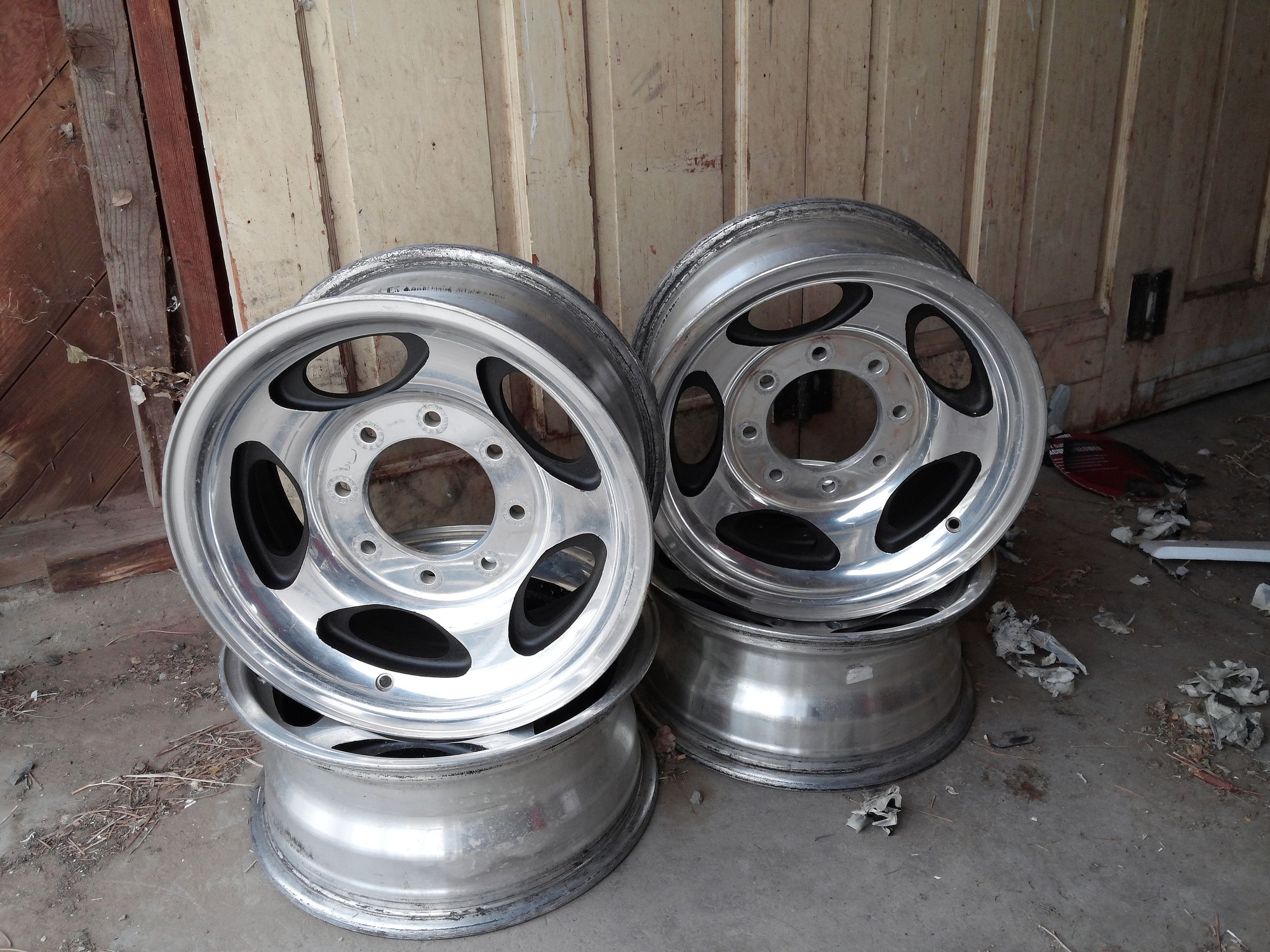

Some wheels i got for free, shot a little black on em to draw eyes from the bad spots. Theyre wrapped with 255/85 Toyo M-55s now.
New (same brand) housings, with H1 projectors and HIDs from the the retrofit source.

Sounds like a plan! I like those light assemblies. Where did you get them?
