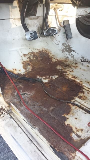

Guys,
I need to cut out and replace floor pans in my 1977 Ford F250 Camper Special. A local guy gave me a qoute of $1200. It seems awfully high, plus I already had purchased a left and right replacement set of floor pans.
My question is how many hours of work would something like this take? Maybe it is reasonable, just not sure. If I can-not get a better price, I guess I will try to learn to weld on a set of floor pans

Thanks Guys. I decided to start working myself on the project. I have most of the passenger side rough cut out. I plan on trying to clean up the cuts tonight and get ready to fit the new pan in.
Couple of questions. I am using an angle grider with a cut off wheel. What is the best way to get a straight cut? I was planning on using a straghtedge clamped to the pan to use as a guide.
Second from what I read butting the new to the old and welding makes the best job, but is more tricky to fit and weld. Is that too much for a beginner, and do you reccomend just doing an overlap/flange?
For butt welds, I was reading some instructions, and one reccomendation was to rough cut the new pan, secure it with screws, and then cut through the new and old plans together with the cut off wheel to get a good fit. Is that do-able, or a bad idea.
