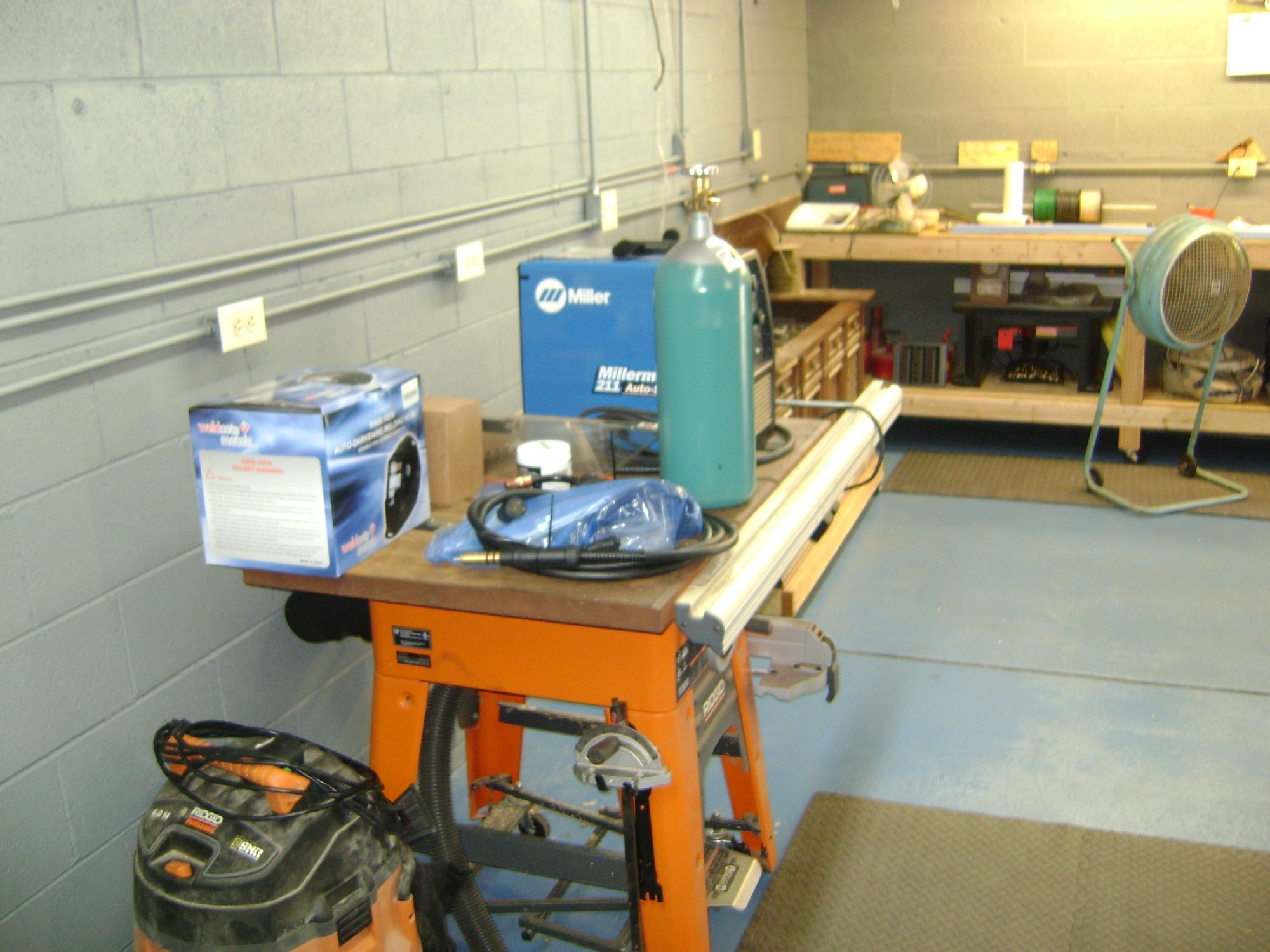

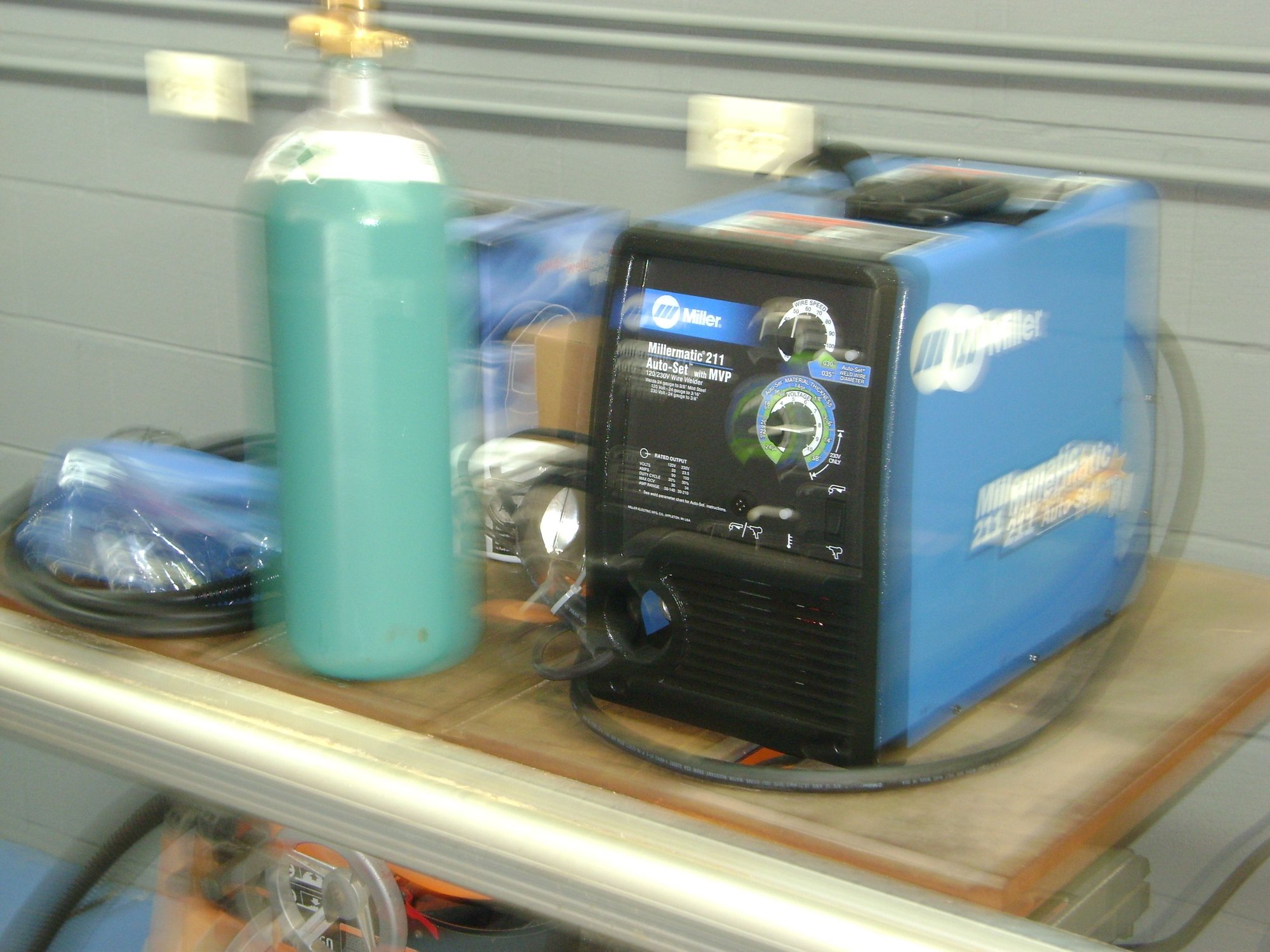

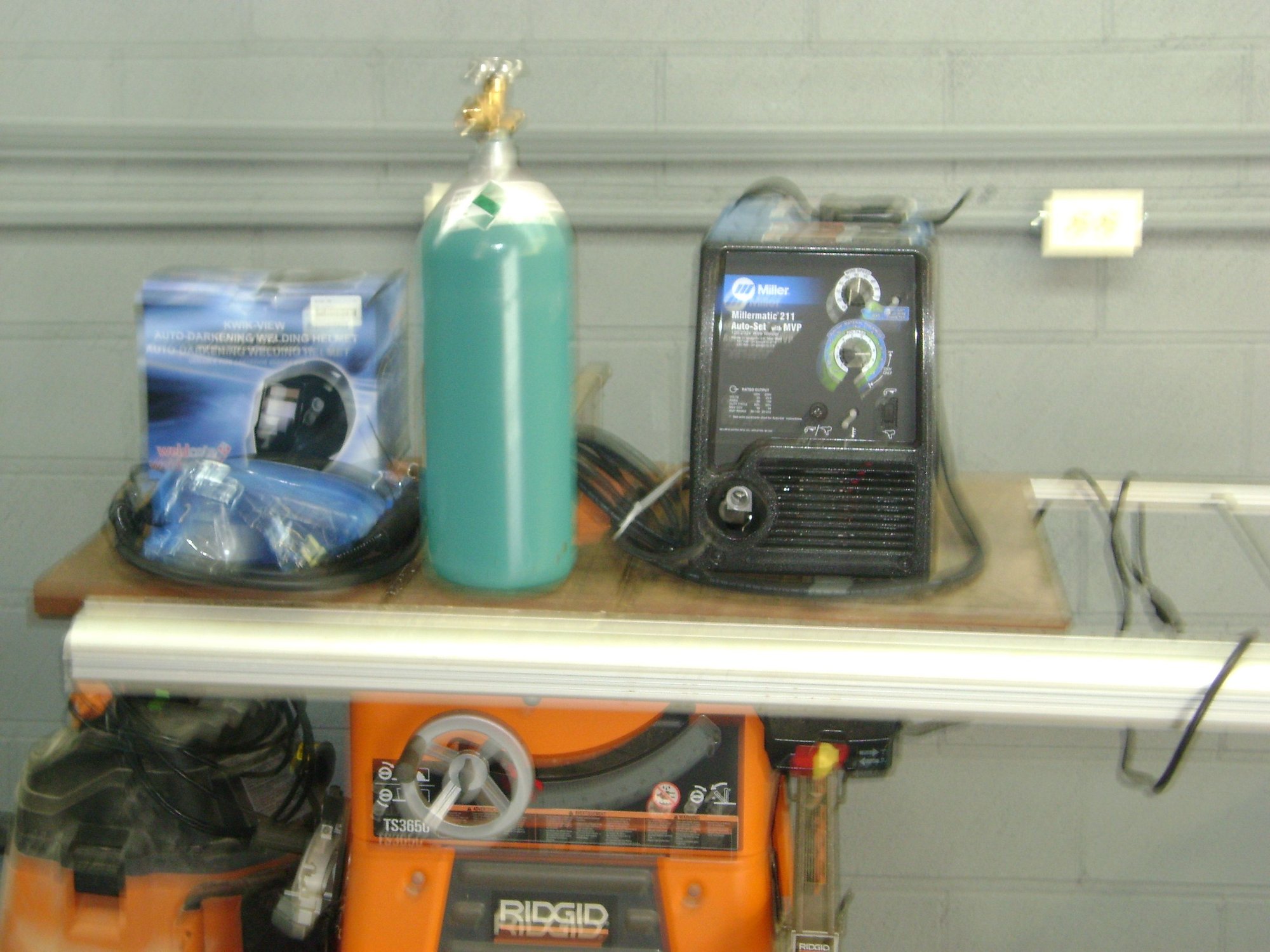

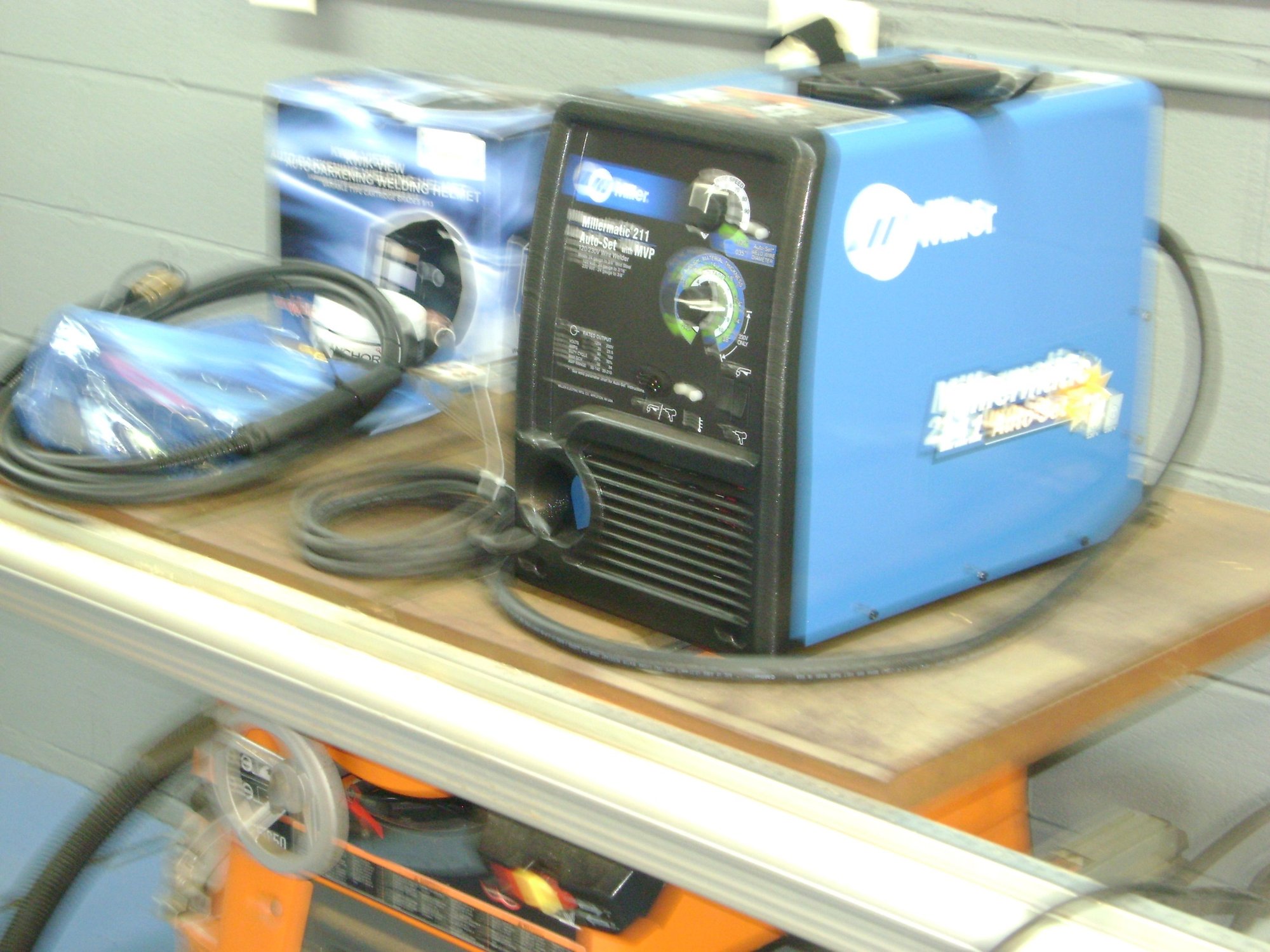

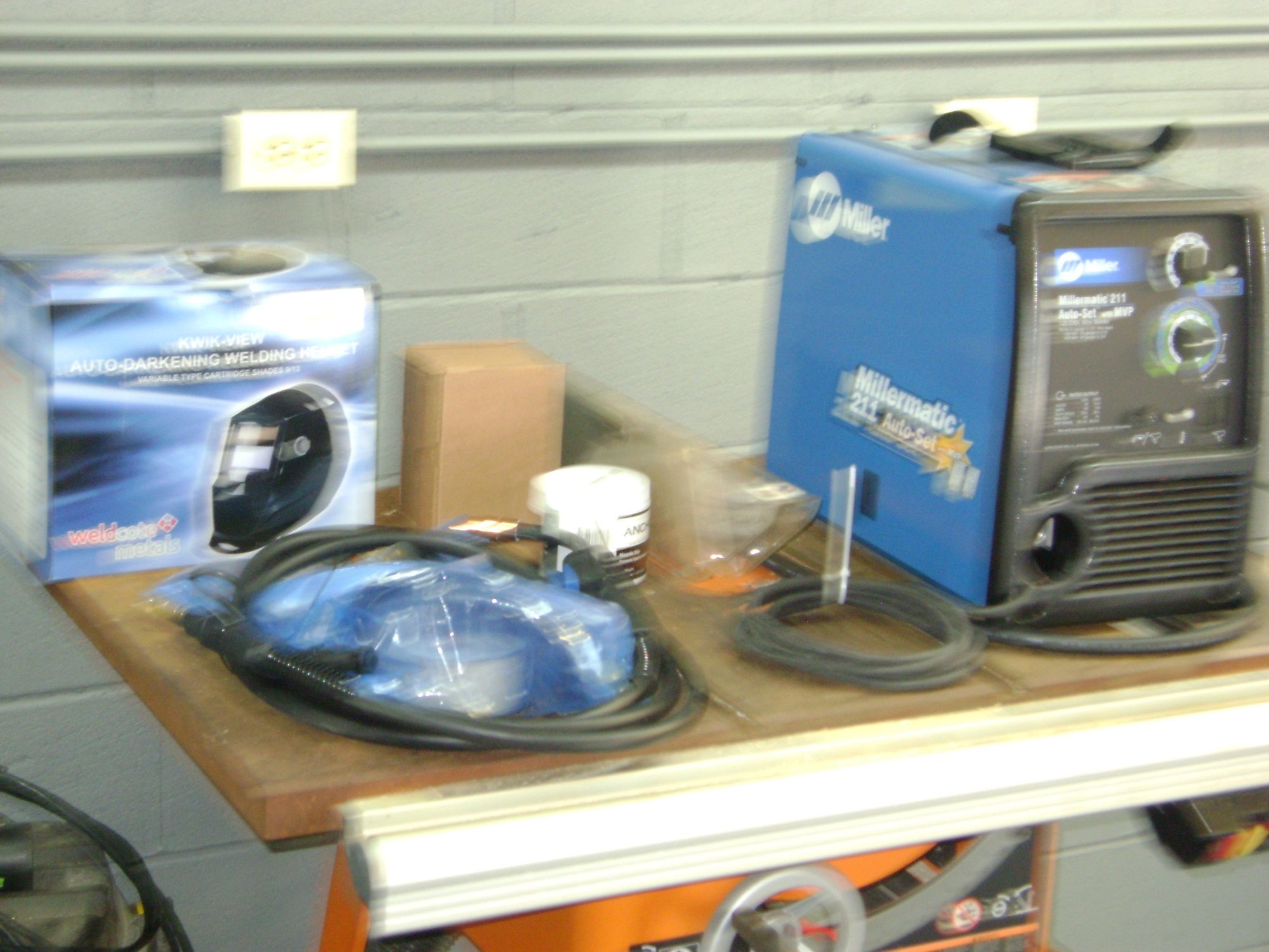

I thought I'd try to post pics of the welder I bought yesterday. Yesterday the gizmo to put photos in a post did not work and today it does. Go figure. I guess I shouldn't have zoomed in when I took the pics, they are out of focus except one. Oh well.

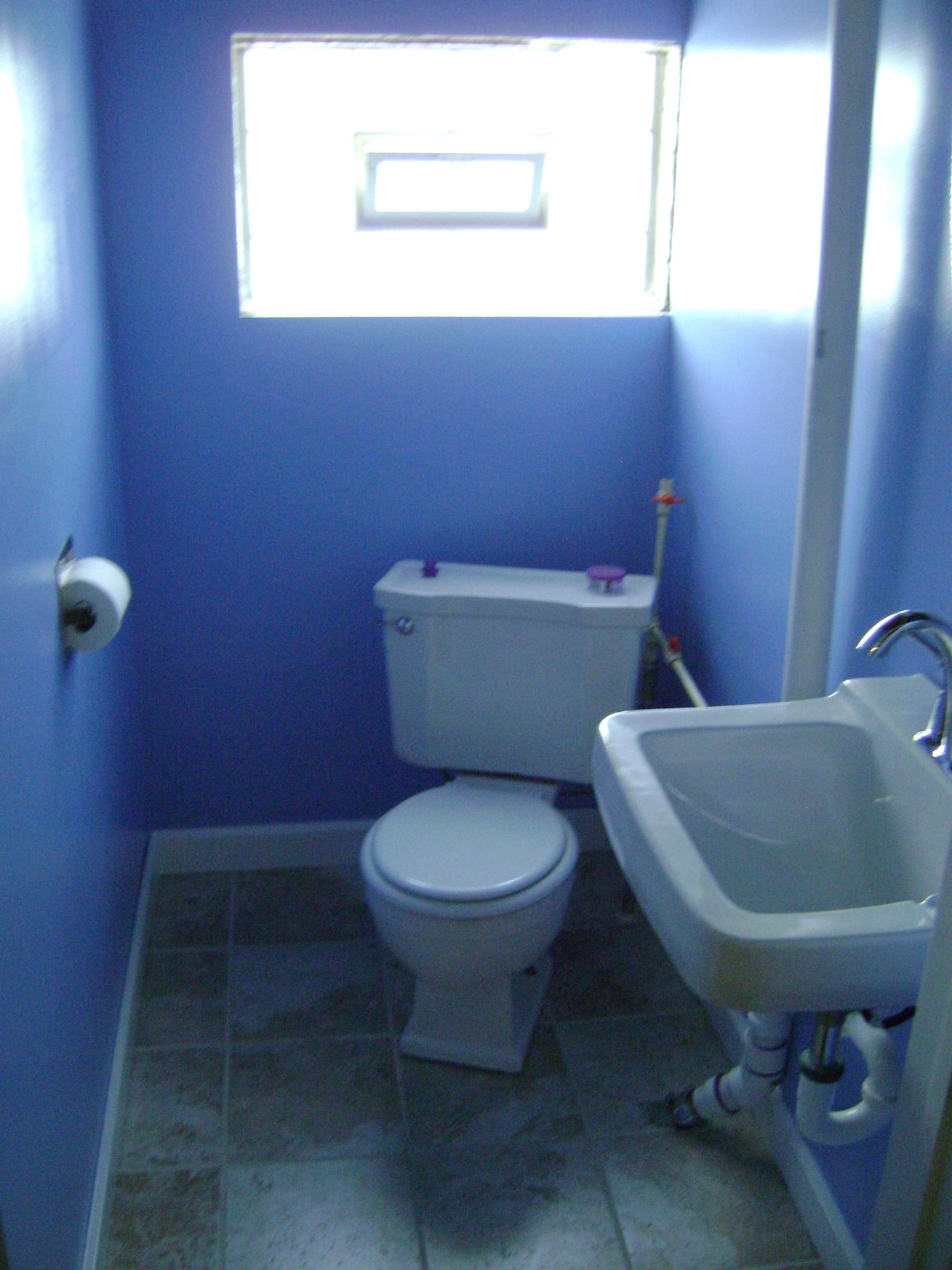

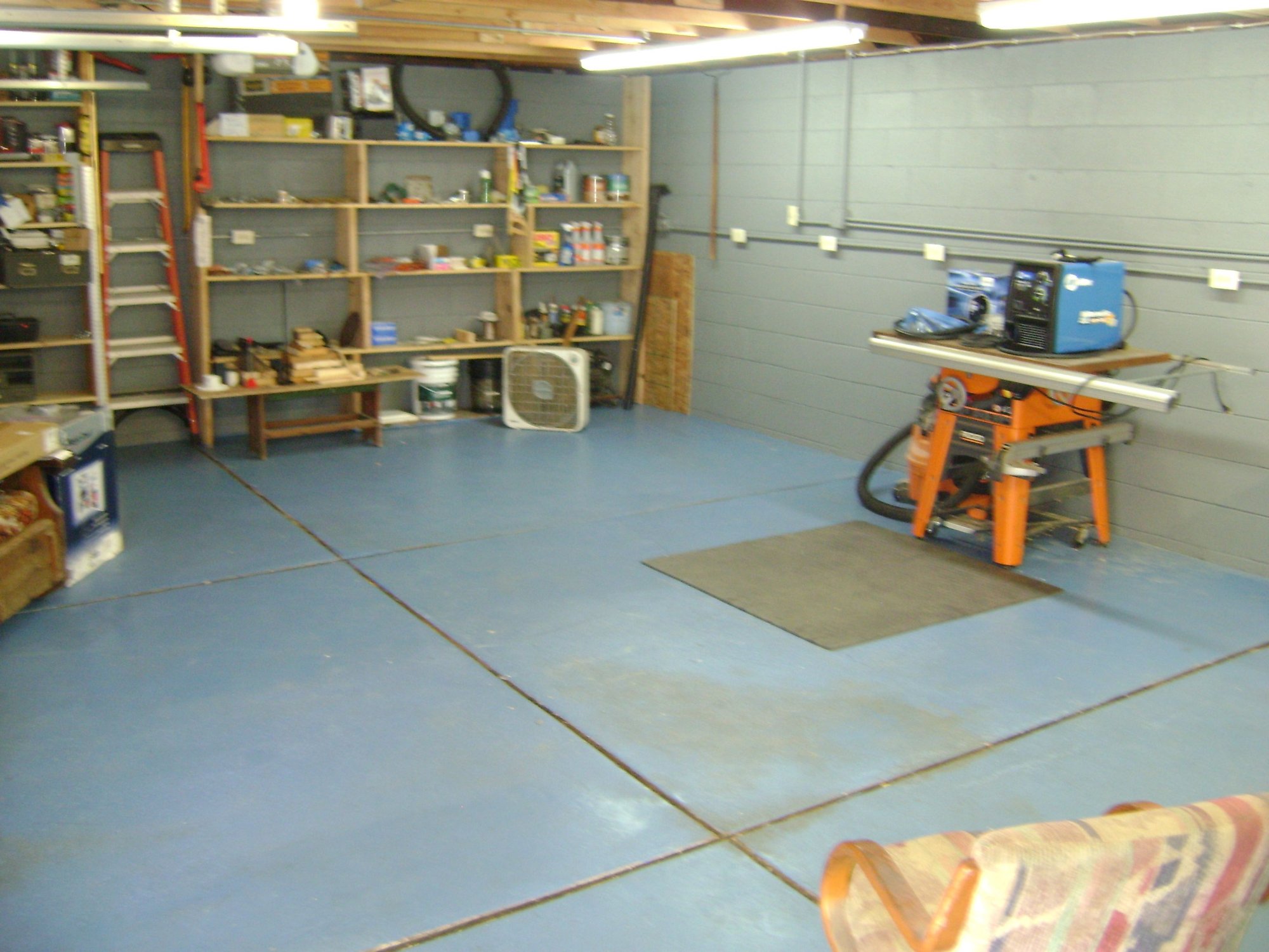

I finished painting the floor about two months ago and finished painting the walls on Monday. This section is only half of the garage, it's 30'x20'. The other half is the same size but has four rooms including the half-bath I remodeled last summer.

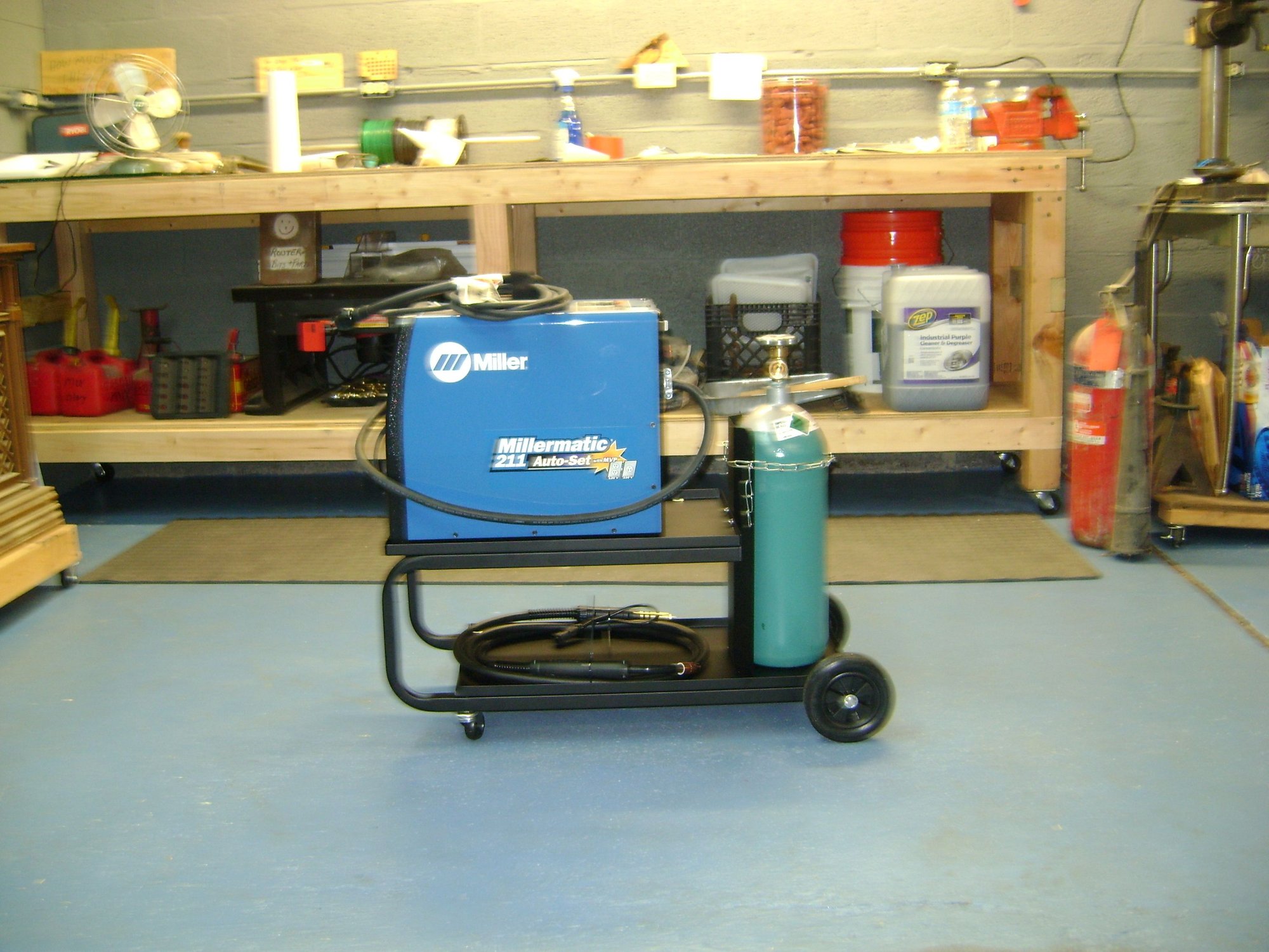

I put together the rolling cart that came with the welder. I do see one problem with the slot the chain goes into to secure the gas bottle; the slot is not deep enough and if you have the chain tight(as in the pic) it will slip over the fat top of the gas cylinder and not be secure. Before I cut the slot deeper I thought I'd ask here if the chain should be tight against the gas bottle?
It may end up being a moot point as my brother may get another gas bottle for me from work since they discontinued use of their mig welders. If he gets a taller bottle I won't cut the slot deeper.
Thanks for any help

I've got the same set-up and the bottle is also loose. It's not a big deal in my opinion. Just use the next chain link.
Your garage is... well... totally porno for us gearheads. My garage is so small there's not even enough room to change my mind.

I won't worry about the chain then, I'll make it one or two links looser.

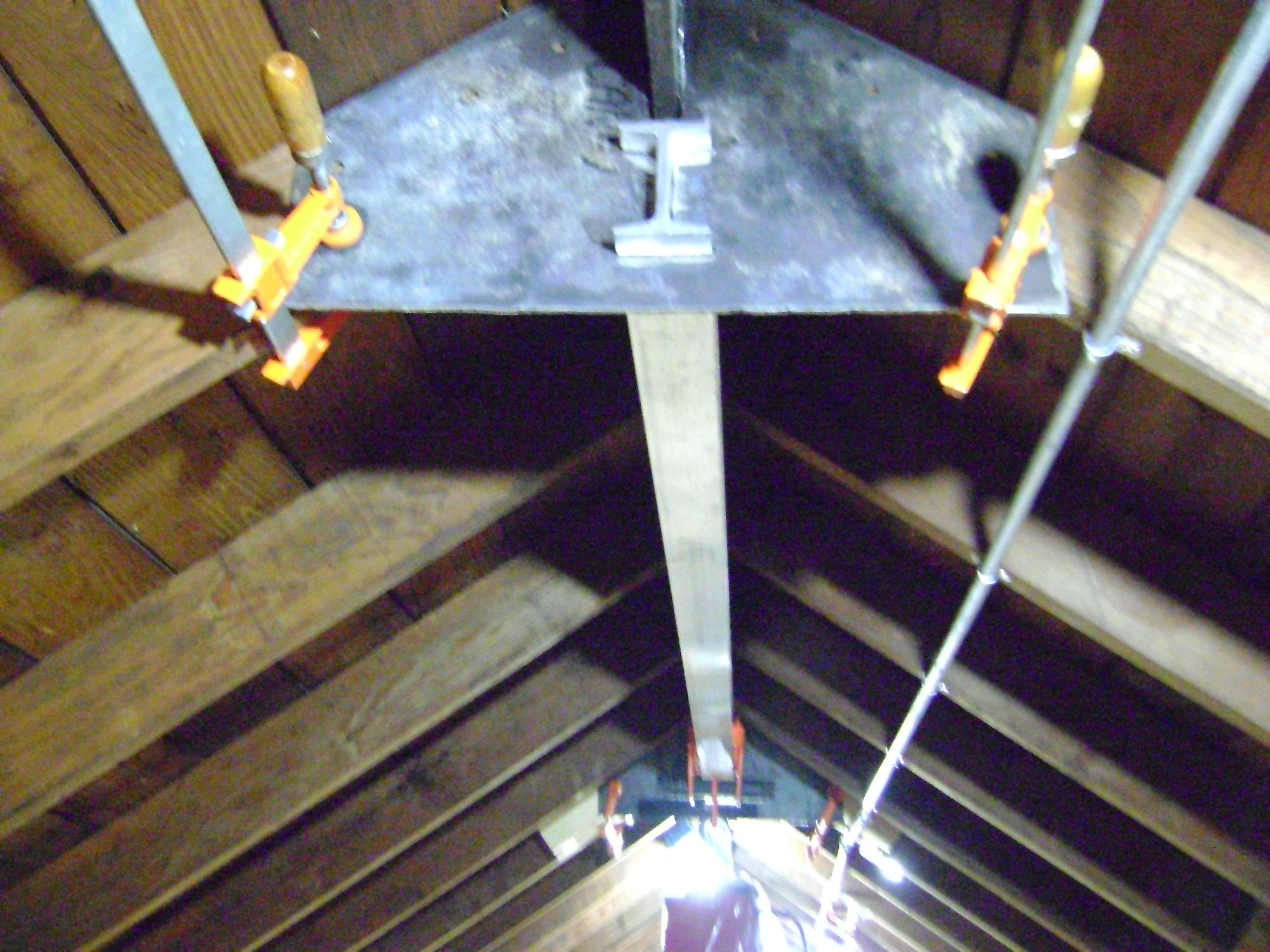

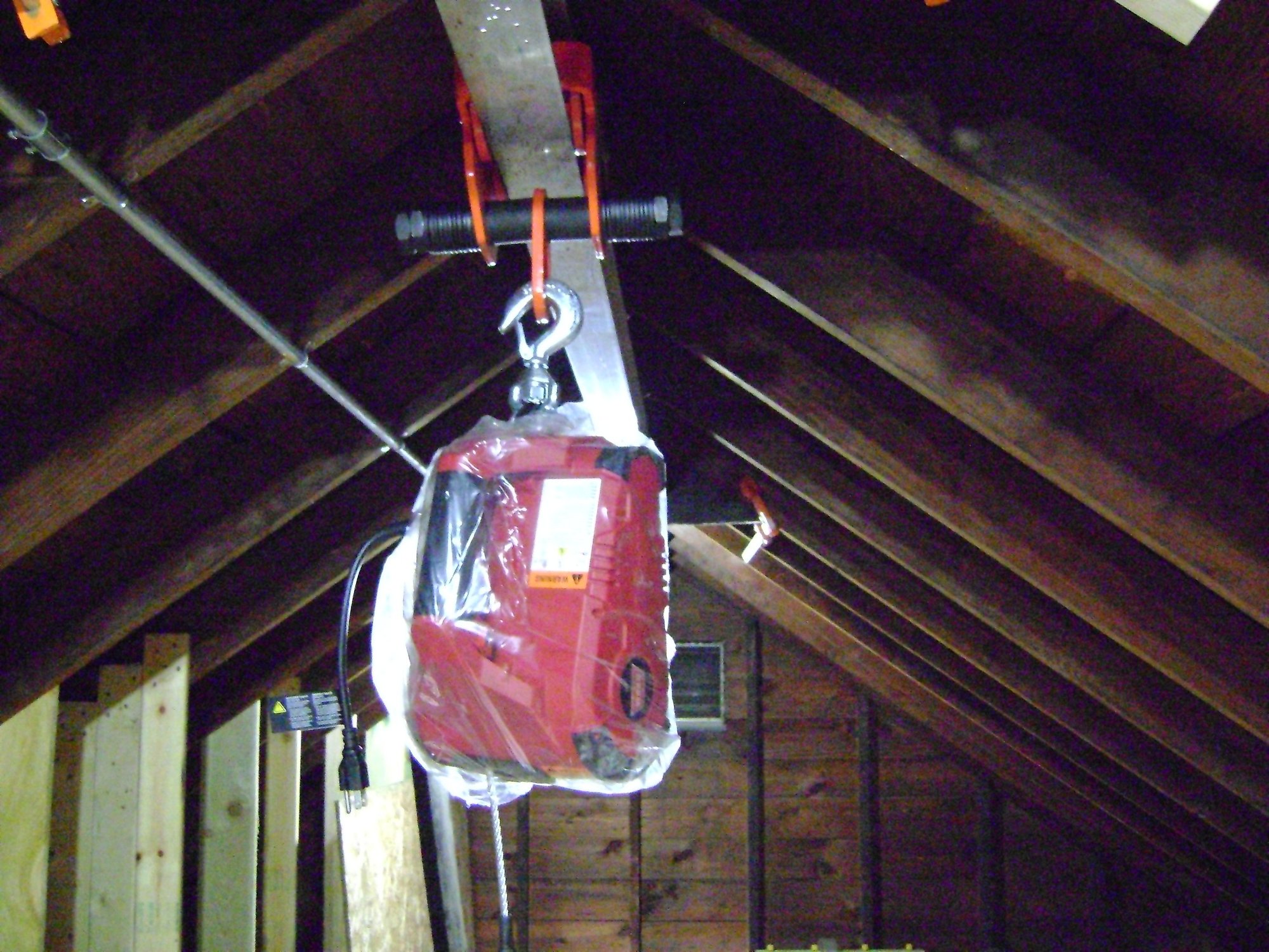

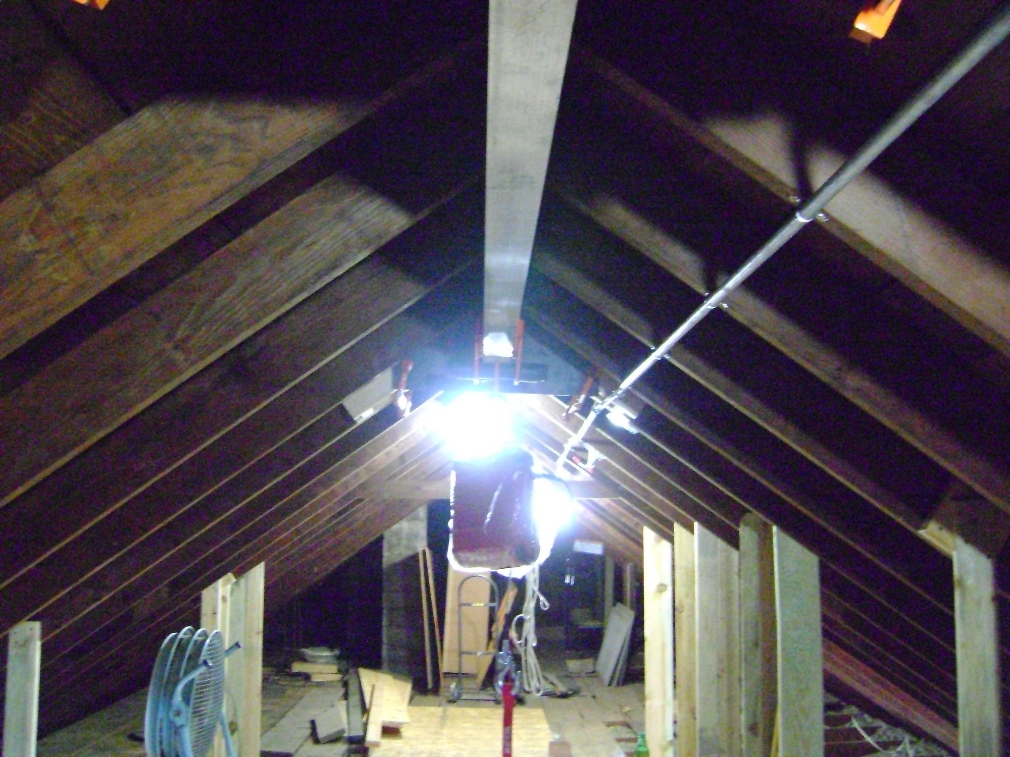

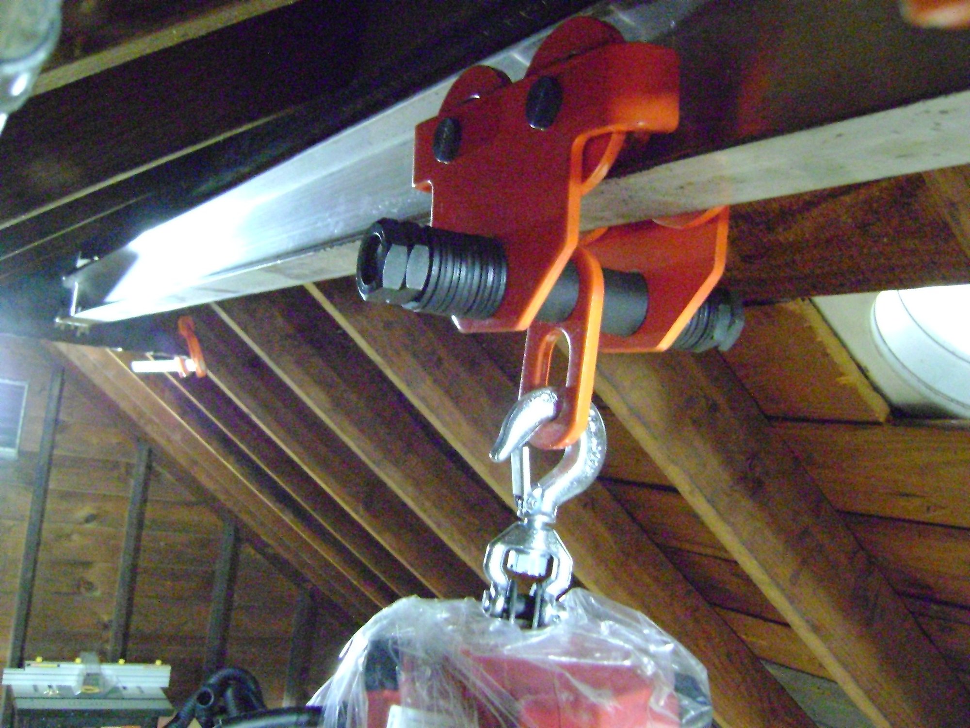

Over one of the car bays I have an opening in the ceiling. Above that opening is an 8' I-beam mounted in the peak of the roof. There is a rolling trolley(1 ton limit) on that with a 1000 lb. limit electric hoist. It has saved much work. I thought I had pics of it bolted in place and finished but the only ones I can find still have the clamps holding the end pieces in place. Oh well, you get the idea.
