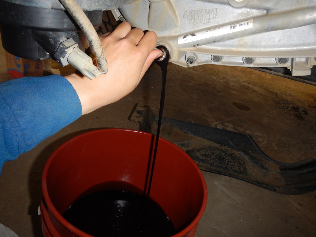

Trans flush is nice because it requires the flushing machine to properly push the ATF through the transmission, while the transfer case fluid you literally just dump and refill, and with 2 threaded ports in the transfer case it's a very easy process.
