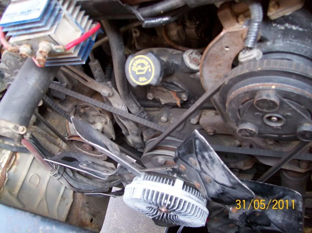

Here is a pic.

I'm wondering if I'm missing a belt in this picture??

That's odd, I've never seen a dual belt P/S pump on an IDI before. But then maybe that's the factory A/C delete? I've never seen an IDI without air either so I dunno.
Your best bet would be to pull that mount the pump bolts to and drill out that bolt.

Did your truck ever have AC? IIRC that's where the compressor belt goes.

Okay, found a pic. That open grove is where your PS belt goes, the forward one is the AC compressor.
On an AC equipped truck of course, maybe they ran dual belts as part of the AC delete?

^^^^ Correct; that truck should have two parallel belts going from the crank to the water pump, to the PS pump.
