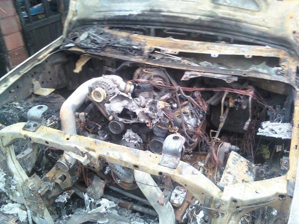

That looks like a 6.0 to me, so not sure if the switch is the issue.
On a side note, I find it super impressive that the oil filter cap is still there. All the other plastic seems to be gone, but that.
Also, The 6.0L has hydroboost which is different brake system than a gas engine and uses a different switch. On another note. I'm not sure if the master cylinder was taken off or melted according to the picture. but its gone.
