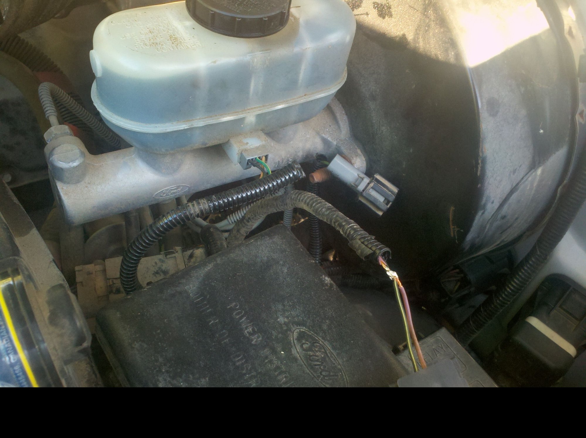

I have a 2000 F-250 7.3 and just as of yesterday I started blowing the #24 PCM Fuse under the hood. I replaced it and throughout the day ended up blowing a total of 4 fuses. It wasn't until the 5th fuse I installed that I realized that every time It blew, I was at low idle and making a right turn. I have looked for bare wires and so far have found nothing. While on my way home last night I also realized that my cruise control is no longer working. Could this all be related and why is it only when I am turning right that I am blowing fuses? Thank you

Originally Posted by dray615
I need help real bad!
For cruise control, check the connector at the end of te hydroboost. It could be disconnect like the pic below.

I am not seeing that connector on my truck ad my brake reservoir doesn't look like that. I just found the red vacuum line that comes off the turbo unhooked. I am not sure if I did that yesterday or if it came undone on its on. It plugs in above the heater bowl connector. Could that of been a reason for my problems?
