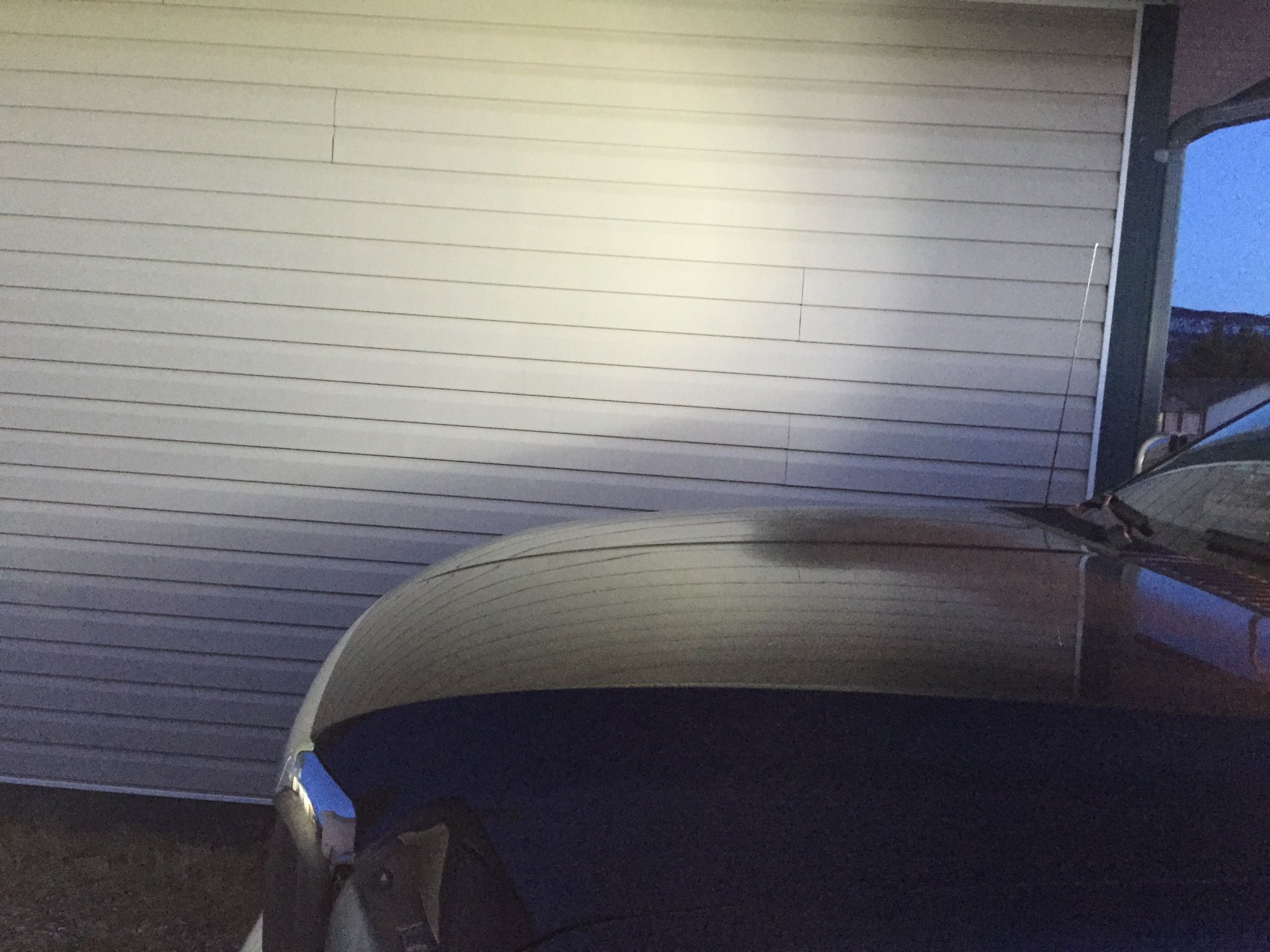

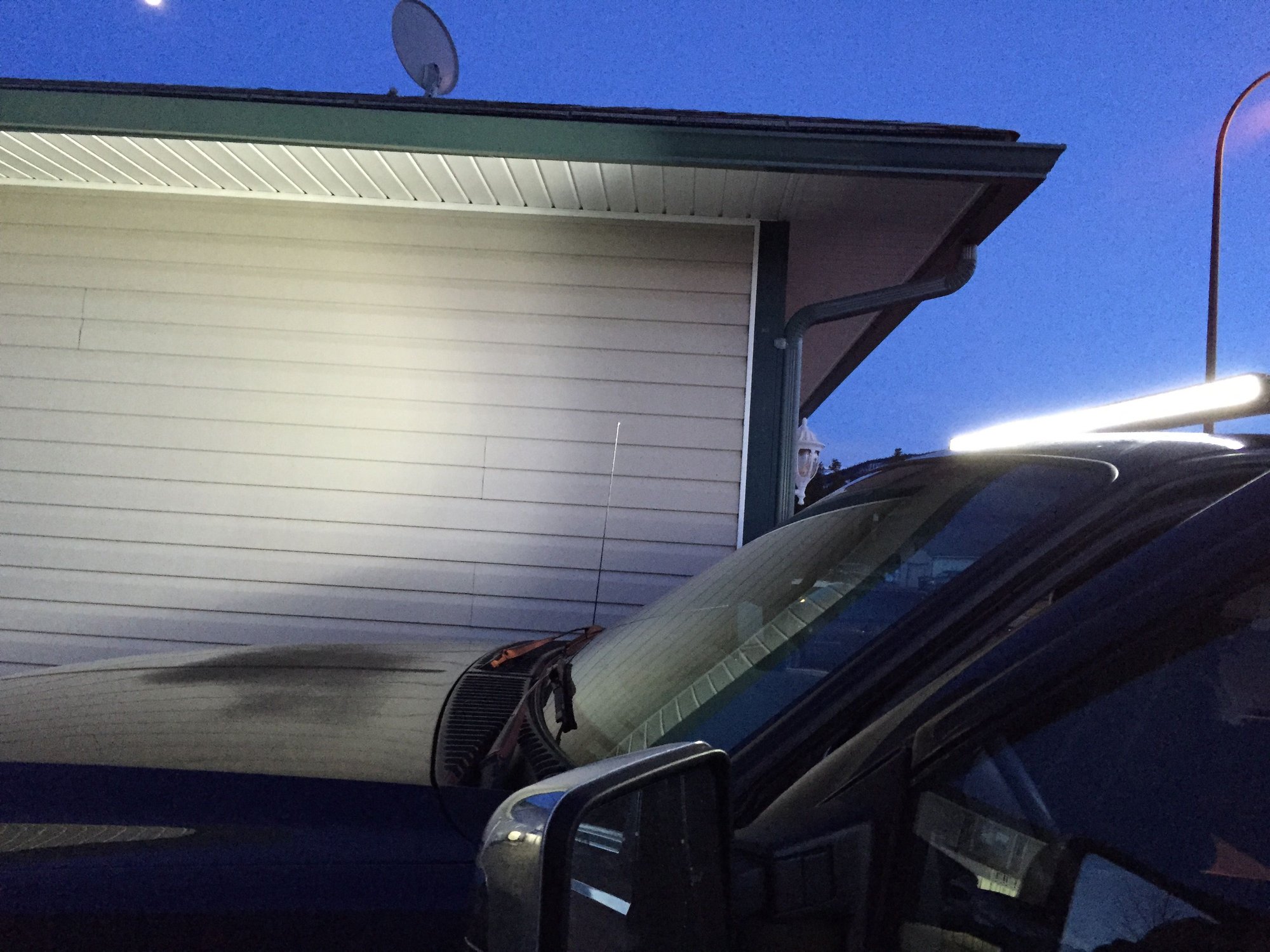

Okay, after seeing the pics of the light on the hood I had to go out and take a few quick shots of my set up.
First, when I first mounted the light it was on the underside of the alum basket I mounted on the top roof. After the first winter, and seeing the amount of snow the basket held, that turned to ice way to quickly, I decided to remove the basket for the winters. That left a bit of a void for the light to mount to hence the push to build a mount to go to above the doors, yet low enough to not interfere with the basket.
I do remember when mounted to the basket I did get some light splash on the hood, and now I don't, as the pics show. On the basket it was mounted at least 3" higher and about that further to the front.
Conveniently parked about 2 feet from the garage, and you can see the cut off reflection that happens from the top of the roof. I will eventually be going to a dual row up there, when the canadian dollar gets closer to par with the us, as I order a bunch from the factory in china and sell the extras to cover my cost of the bar. Hopefully this won't take long.
I don't think the dual row will even be tall enough to make an impact on the light hitting the top of the hood. That said, when I do drive thru a bug storm, they do reflect a bit in the light into your eyes, but you learn to ignore that and focus past them on the road.
While I feel the front mount gets rid of the eye glare, I still think the top roof mount offers a better light dispersion on the road for view. That one can be debated tho, but I have had light mounted in both positions over the years and have some experience with the set ups.
