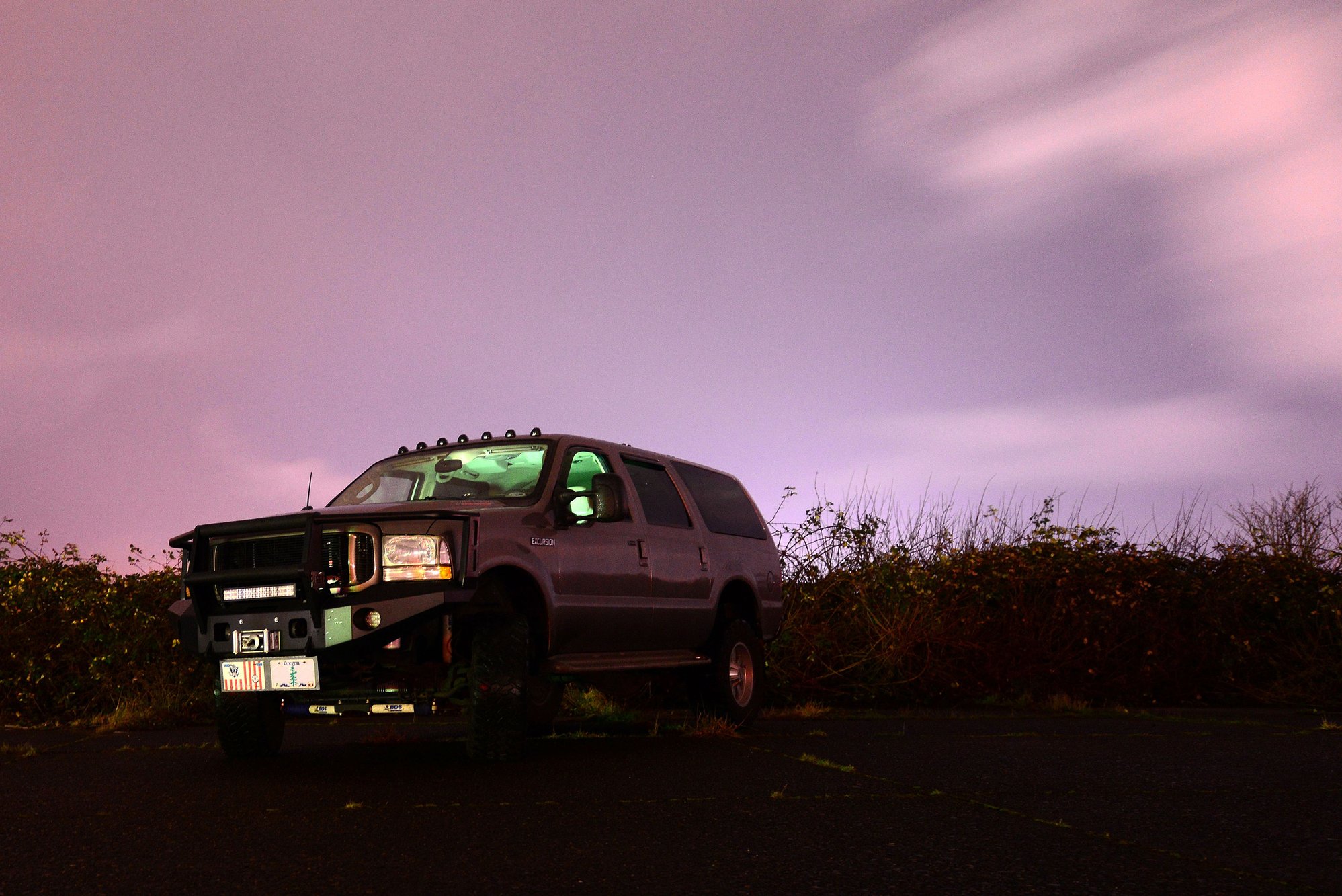

I am willing to bet that if you wired it up and tested it from behind the grill, you will find that you are not loosing all that much light. I think that for your rig, having it behind the grill will keep the nice clean look you have.
I have a light bar like that on mine (on my big old bumper), and you will not believe the light output.
I think the biggest issue I saw with behind the grill, was a good place to bolt the thing down. Good luck on the instal!
