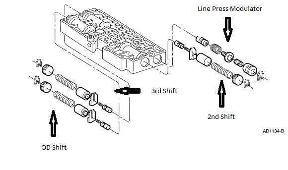

You could drop the pan and remove the accumulator body. Check the 1-2 accumulator valve for damage or sticking in the bore. If I had a diagram to show you which valve that is I would post it here, but I don't have one.
Not sure if this helps or not, Mark?

Originally Posted by Green-Monster
Ok I'll look, I've already looked at the diagram, I'll download it to be sure though. I should be looking for sticking issues, marring and other markings correct?
That's right.
That's the diagram. Check the valve labeled for the 1-2 shift. While it's out you really should check all of them.
