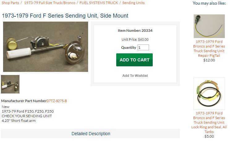

And does anyone know if this would work as an alternative?
I know it's the wrong number and all, but I'm thinking the only difference would be the pickup would be front to back instead of side to side and likewise with the float? Still have the tank in the garage, so will measure the depth and see if the clearances would work for this one.
